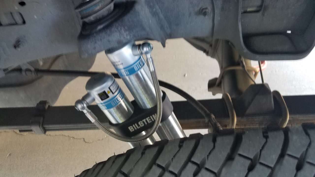

    It took a little while to get it done. I struggled on the first side, second side went in a lot easier.

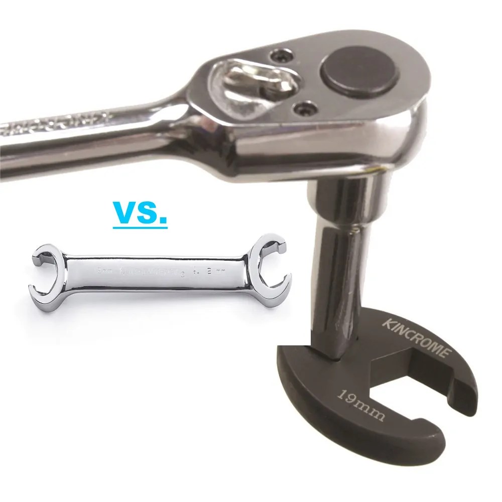

    How did you guage the torque of the top nut of the shock? I read that it is supposed to be 22 ftlbs. I wasn't able to get a torque wrench in that small space.

    Crows foot “socket”

    That’s what I did. I realized before starting that I couldn’t torque it. I measured the gap/compression of the bushing and tightened it to the same measurement. FWIW it was snug at that point and would not right any further.

    Thanks for the info. Never heard of crows foot socket.

    Definitely good to have a set in your arsenal.
