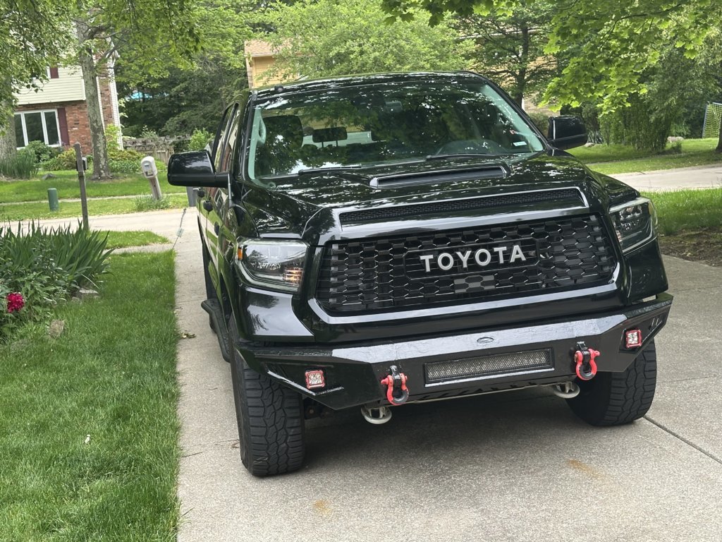

    Good evening peeps, just wondering how big of a tire I can fit on my tundra?! Any other suggestions for mods are welcome. I haven’t done much, got a front bumper and some RCI rock rails and RCi plated undercarriage.

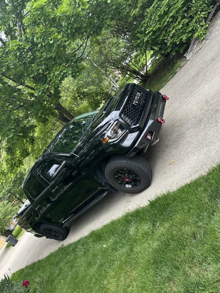

    More photos

    Depending on the brand you go with, as so run much larger or smaller than other, 285/75/18s or 295/70/18s are kinda the go to.
    Shouldn't need any additional mods for either of those other than maybe a little fender liner massaging. Some folks have experienced rubbing on the front sway bar (at full lock) w/the 295s, but again that's on the brands that are running on the larger side.

    If you’re willing to cut the cab mount then 37’s are the limit within reason. There’s a couple guys on here running 40’s, but that takes some dedication. I’d highly recommend spending some time cruising around the forum and seeing what others have done.

    Kai from Tinkerer's Garage managed to stuff skinny 37s AKA pizza cutters on his rig at stock height. Offset was the key. With your bumper and the added 2" you should be able to do the same.
    https://youtu.be/Q7MyN1qOFgs?si=E3dWzKxGvmb-13C4

    Thank you gents so very much! I think if I could find a set of 295/70/18 that are good in the snow, that’d be ideal. I heard the TRd Pro trim was slightly lifted from the factory, is this accurate?

    Yes sir that’s right. You have about a two in lift in the front from the TRD suspension

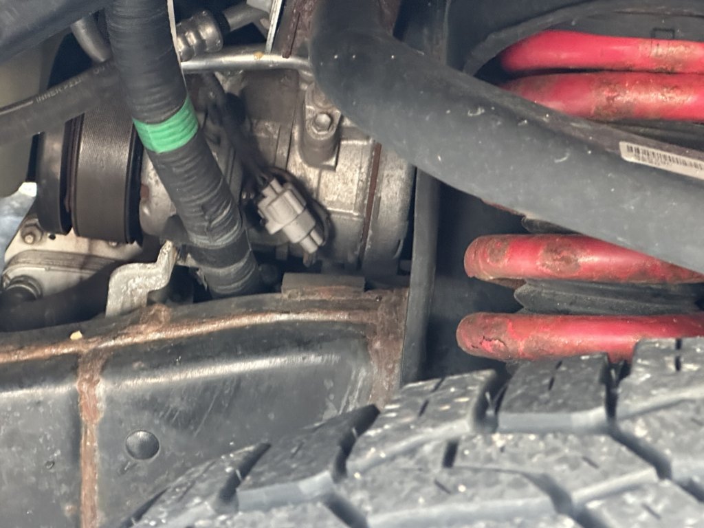

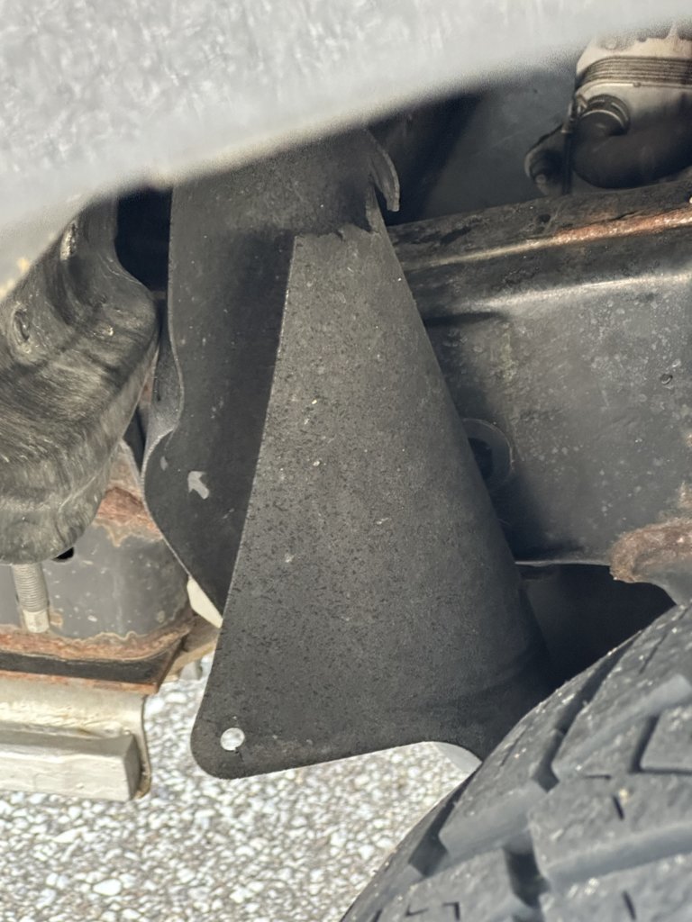

    Sorry this is unrelated but I noticed something this morning and was hoping for some expert opinions….IMG_0512.jpg IMG_0514.jpg IMG_0512.jpg IMG_0514.jpg

    There’s this soft cover between the engine and the tire bay that doesn’t seem to be built to last. I feel like I should replace it. What do you guys think?
