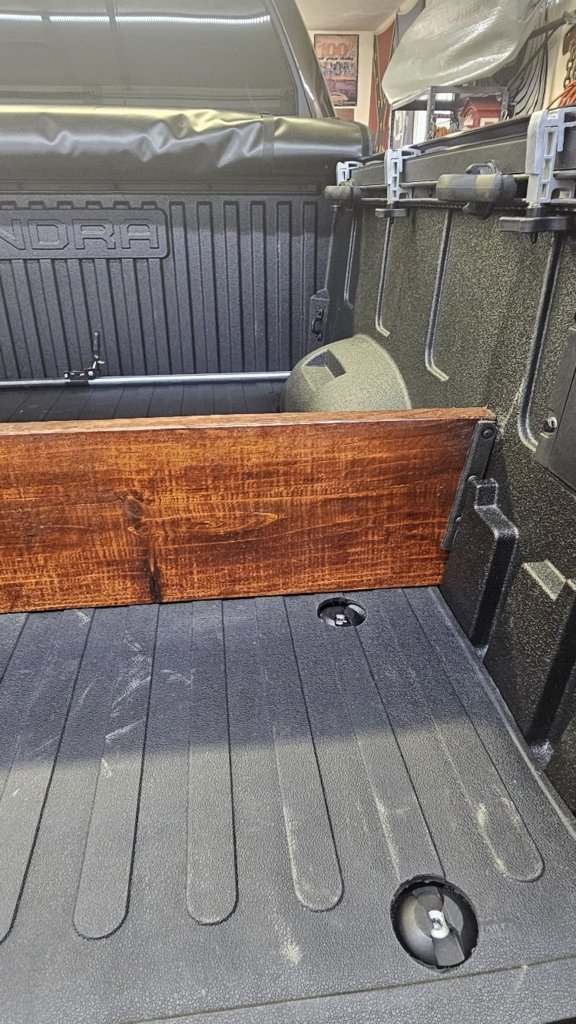

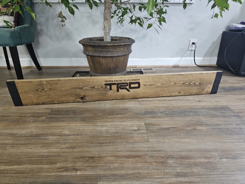

    I wanted a better looking bed partitioning board and did not want to pay out the rear end for a metal one, so I decided to create my own. For the last two years I used just an ordinary 2x8, but the board was always an eye sore compared to the rest of the truck. So.... out came the saw, stain, wax free shellac as a bonding coat and Extreme Protection polyurethane. I have actually created two of these boards, but one is coated in spar urethane and the other will be coated in water based polyurethane. Interesting little tidbit I learned..... some water based polyurethane are actually harder than oil based! They resist denting and scratches better. At least that is the claim of several people and the manufacturer. I'm giving it a go and see what I get! The lettering is created using a wood burner/pyrography kit20250513_164252.jpg 20250513_164301.jpg

    I'll include all the links to the products. I did massive homework on this to make sure I got the absolute most durable outcome possible. I used Minwax Special Walnut stain. That needs to cure for 48 hours or more, then two coats of Zinsser Sealcoat matte/flat as a bonding agent (according to instructions on the can, DO NOT thin it with denatured alcohol or any other thinner for the purpose of a bonding coat). Then 4 to 5 coats of Crystalac Extreme Protection Water Based Polyurethane. Mountains of information in the form of reviews and other places suggests this is the hardest option to resist dents and scratches alike.
    https://www.amazon.com/dp/B001003F9M
    https://www.acehardware.com/departm...0rBx6lK-zde9AIEZ4WvqFsUxtpFkOXQxoCwPUQAvD_BwE
    https://a.co/d/3wPkoOo
    I checked over and over the compatibility of all these specific items and to the best of my knowledge this setup will give you the absolute hardest finish. It should be noted that I do have a weatherproof bed cover, so the polyurethane should be sheltered enough to prevent any problems, but that Crystalac water based polyurethane does have UV protestants in it, which is rather rare for polyurethane to have. It also has special additives to increase hardness. I assume those two things are what causes the abnormally high price of the polyurethane.
    Just read the instructions on each product and apply as directed. It should give you a great finish product! I even included the file that I used to make the stencil. I just made it as big as it could be while fitting on a piece of paper to run through the printer. Good luck!

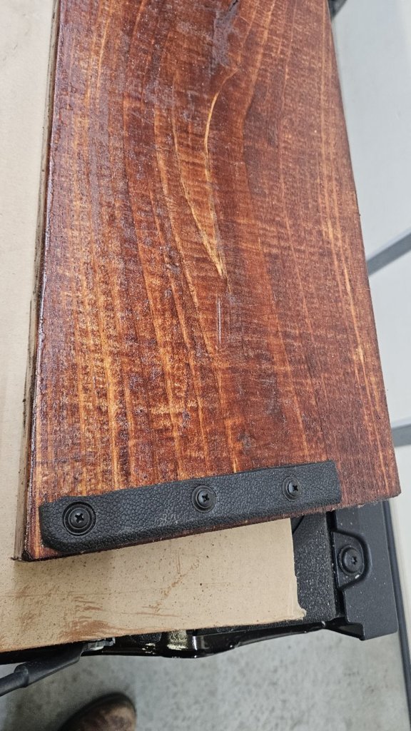

    I do like those guards you have. I have thought of using self adhesive rubber padding, but they screws look good and I'm sure will last longer! What kind of material did you use? That is a rather quick addition that I am sure will guard from the ends getting beat up!

    I had leftover rubber from trimming my tailgate mat, worked perfectly. Just a thick piece of rubber, keeps it from flopping around in the slot.

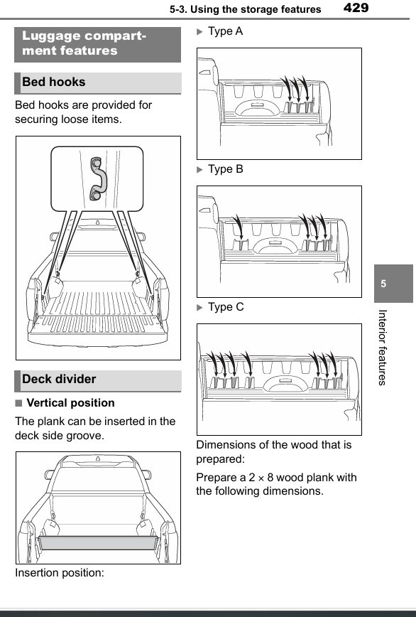

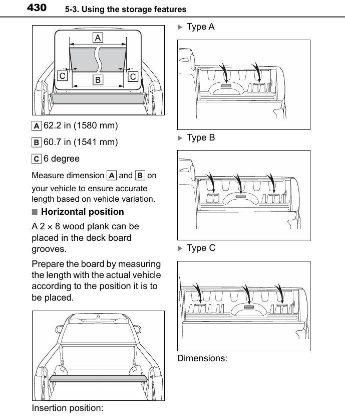

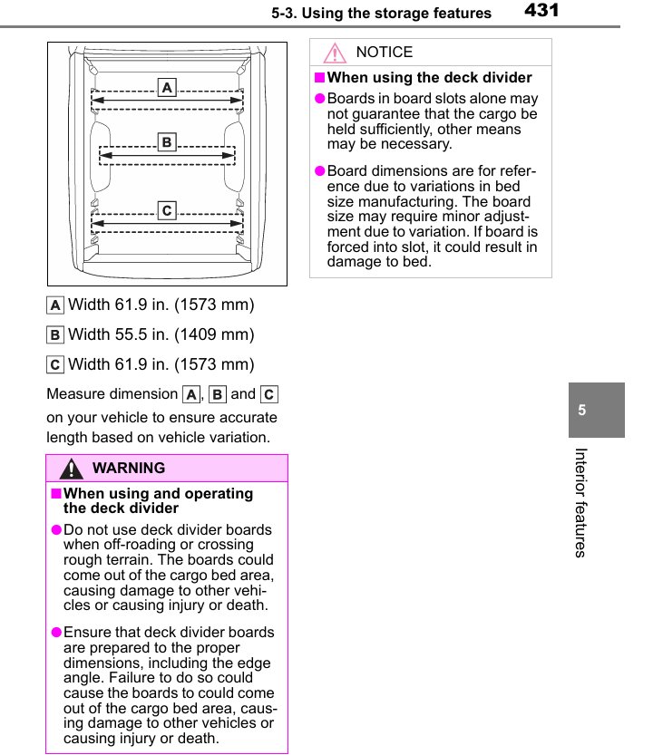

    Could someone post exact dimensions and angles you are cutting these to? Appreciates you Tundra fam!
  14. May 16, 2025 at 7:14 PM
    DRP
    DRP Old Member
    Aug 20, 2023
    #102452
    964
    Dave
    2023 1794
    They have the specs in the manual. :thumbsup:
    It's on page 429 in my manual. Search "deck divider" if you're using the pdf manual

    If you still need the angles/lengths, I'll check tomorrow and post back.
    Yugo[QUOTED] likes this.

    Good detailed stuff! To get the angle PERFECT, now I will have to spend another week sanding, staining, shellacing and finally another 7 coats of polyurethane! I build decks for a living, and have every conceivable tool needed to do it perfectly, but the TIME involved!

    Thank you! I really appreciate you posting this.
  22. May 17, 2025 at 8:54 AM
    1lowlife
    May 4, 2016
    #3296
    11,116
    DADA
    THE GREAT STATE OF TEXAS
    2014 MGM DC SR5
    You are welcome.
    I didn't even know it was there until @DRP posted it.
    I don't think it is in my 2014 manual.
    I'd like to make a board to go towards the rear of my bed.
    90% of putting anything back there needs to stay near the tailgate to unload.:thumbsup:

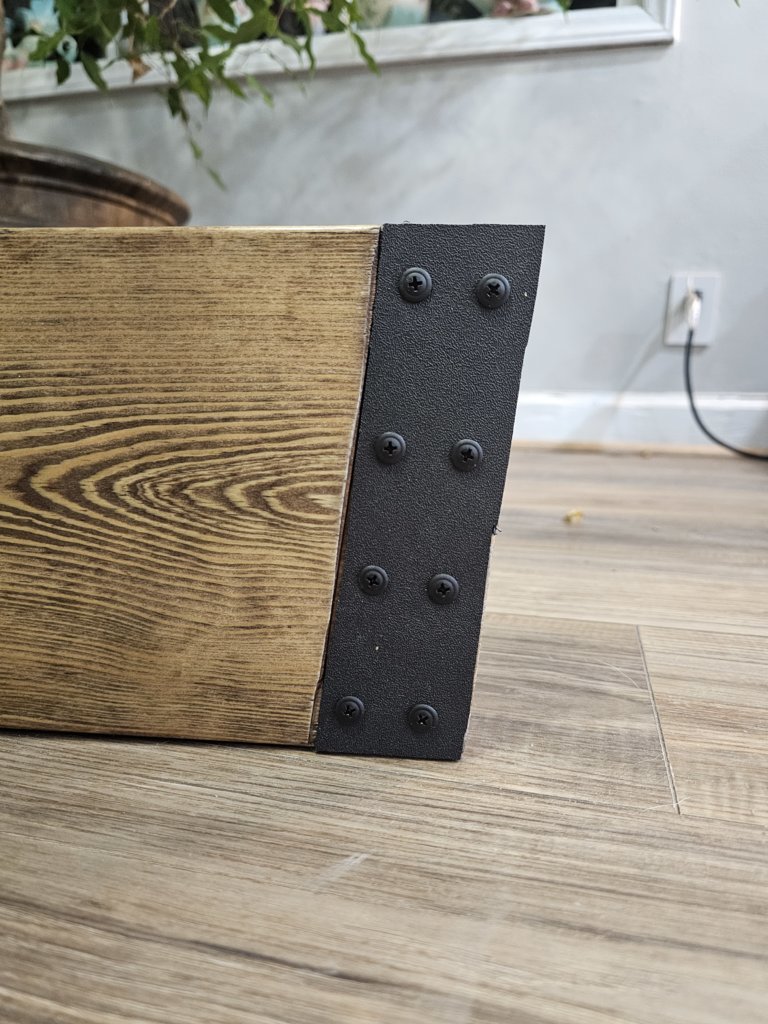

    7 coats of Crystalac water based polyurethane (supposedly the hardest, most scratch resistant) and used a planer to recess the hard plastic pieces where it'll meet the truck bed. I probably have too much time on my hands.

    Hey that looks great! Love the logo
