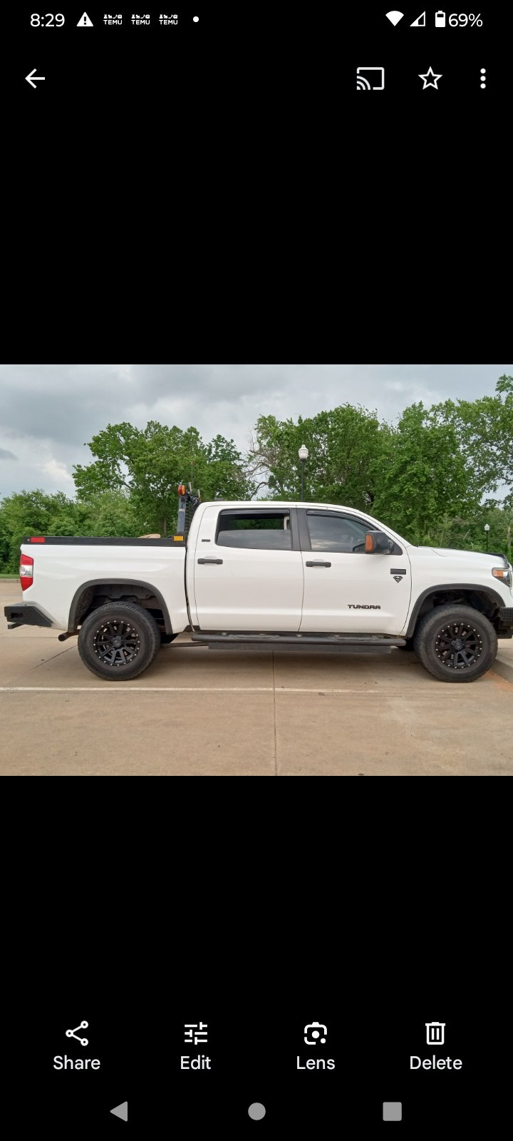

    Just so you know, the ones I posted are not only in my bed under the rails, they are also under my cab behind the rocker panels as puddle lights. They get exposed to rain splash, mud, gravel, salt, etc. Which means they get hit with frequent really hot water undercarriage rinses too. They have been there for a couple of years and still work like new. That is why I suggested them. Just my .02, good luck!
    Edit: If you zoom in this pic, you can see clear lense amber versions used as side markers just under the doors too. There are 5 on steel tube bolted to the pinch weld. Again, no problem with element exposure, tucked in away from physical damage.
