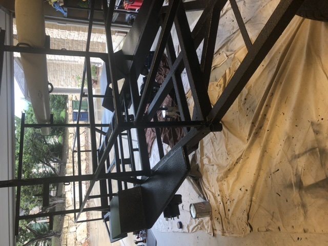

    A trailer that was originally built behind the Tacoma but stalled behind life projects

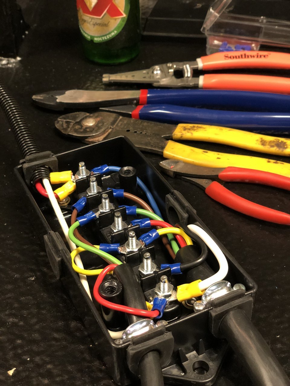

  10. Jun 1, 2020 at 5:41 PM
    hookdem
    hookdem [OP] New Member
    Sep 12, 2018
    #19338
    73
    Austin, TX

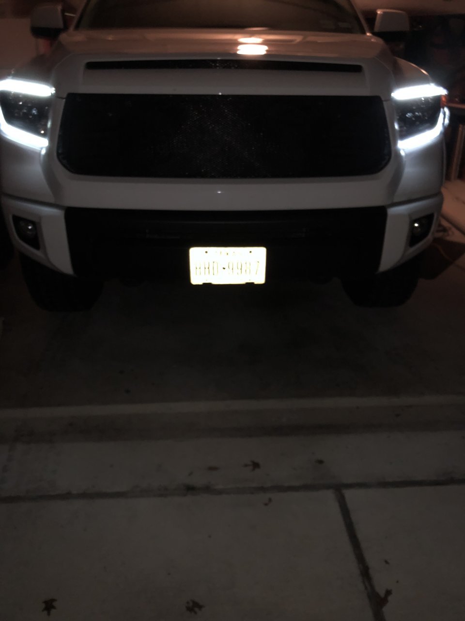

    2018 comes around, so upgraded the lightsFC9275ED-861C-4F94-B498-E86F645C0765.jpg
  11. Jun 1, 2020 at 5:43 PM
    hookdem
    Sep 12, 2018
    #19338
    73
    Austin, TX

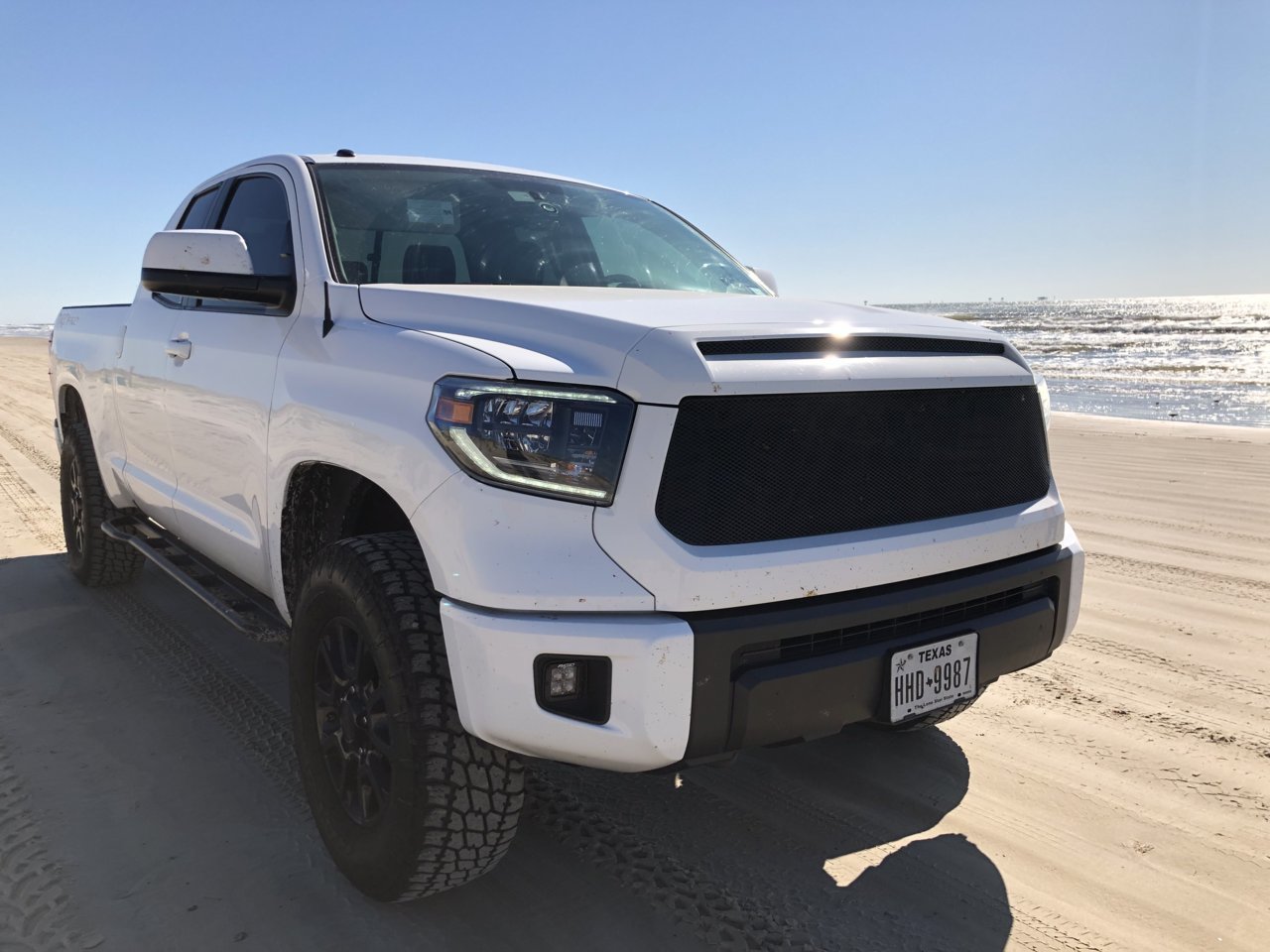

    Much better

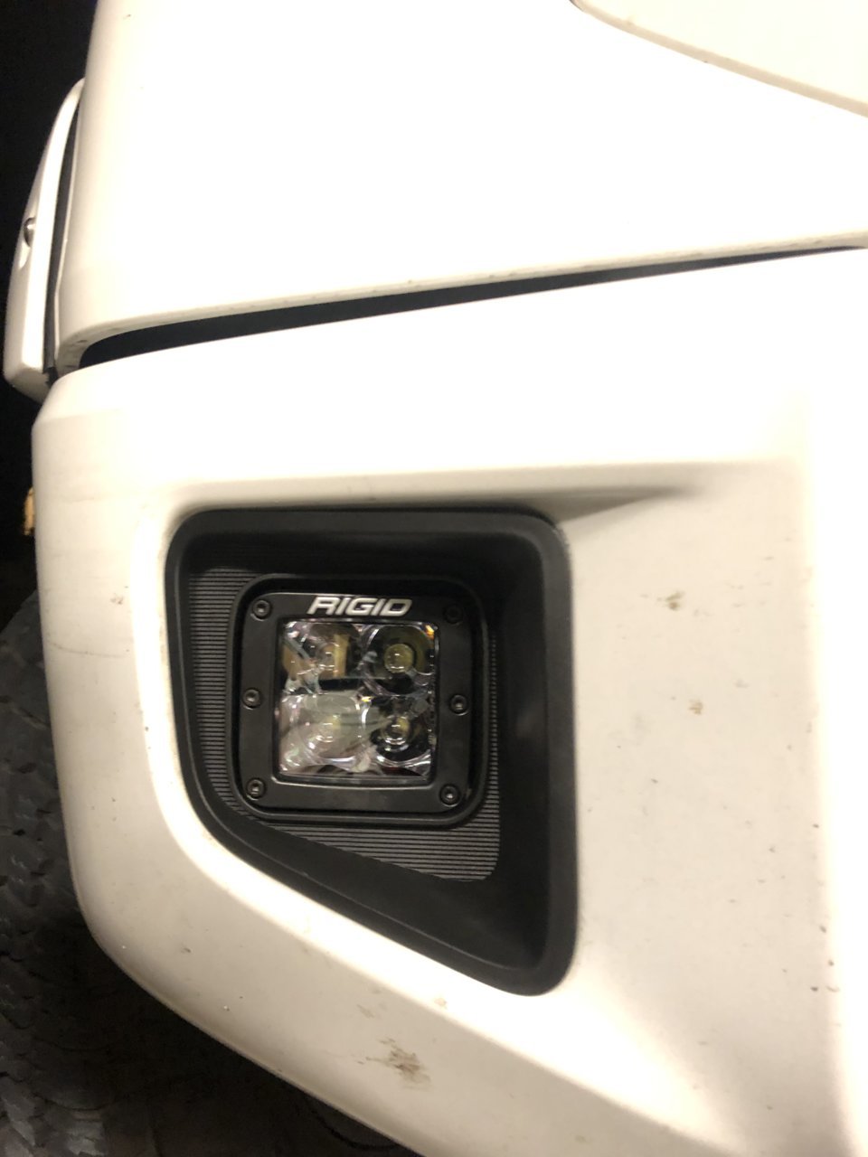

  12. Jun 1, 2020 at 5:47 PM
    hookdem
    Sep 12, 2018
    #19338
    73
    Austin, TX
    Couldn’t stand having led tops and halogen fogs, so once the bezels were released, switched to rigids. Went with Midnight series

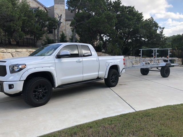

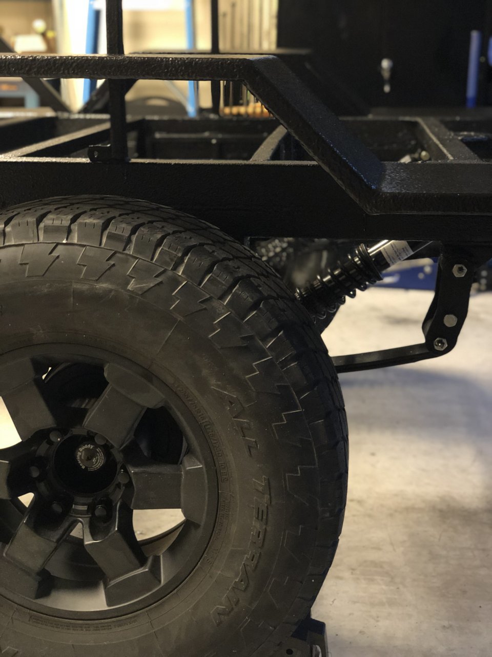

    Enter kid#2, another break from the builds. But slowly took some time to ready the trailer
    3F49E3FA-8CDF-4E4D-AE6C-94F5F44C1071.jpg 71A8D2D4-9CAB-4CCC-82E9-FC5253697459.jpg B9B9F7A7-156A-401C-B1C8-DB8D7E937E97.jpg 59ABAE62-49D5-4453-A79E-57574DFD3F36.jpg 2F53F24E-1283-4CFA-AAB7-8AC45F5E7515.jpg

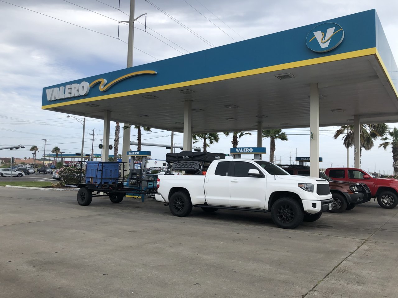

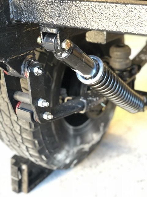

    Finally got back to the truck, added a rack, rtt, and recovery gear in time for the trailers first suspension load test. Weighed it Down with 1000# of rice and headed down PINS.
    35908CFB-BED3-428E-B58C-C3D5EFE66D6D.jpg 2068E2BF-625E-4651-9C92-46B2EAFFBB14.jpg

    Trailer suspension did well, better than the Pros suspension with a full load of camping gear, four dudes, and the trailer weight.
    Finally, after five years from the start of this trailer project, got it down the beach with the intended cargo, kayaks and fishing gear.

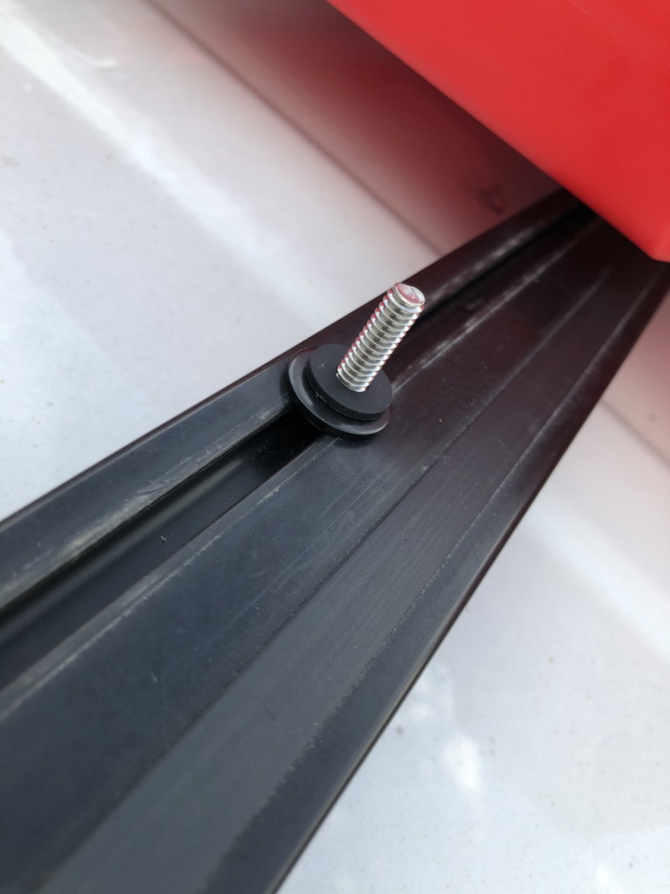

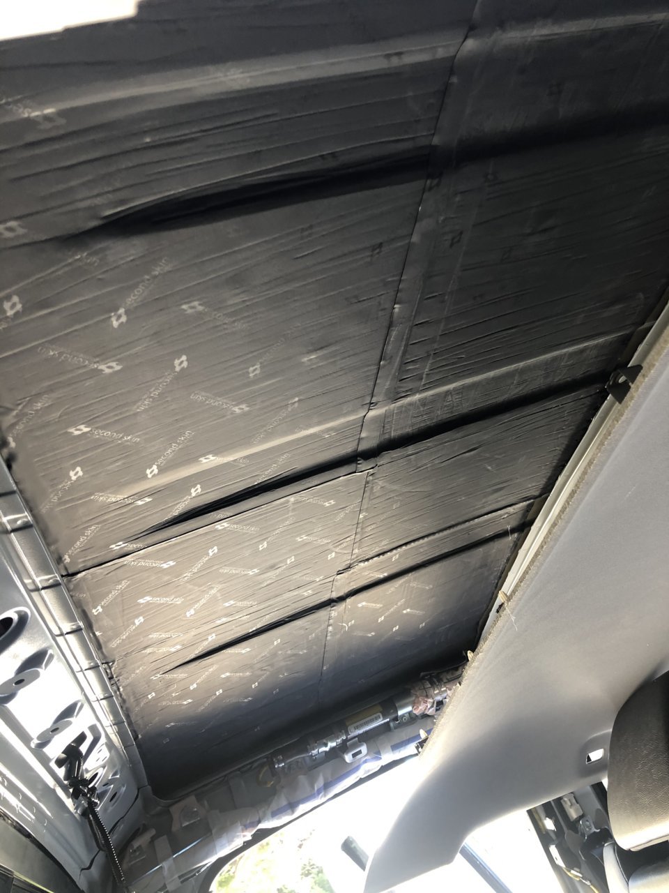

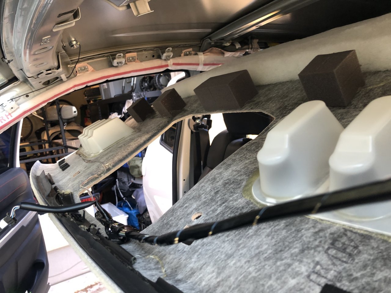

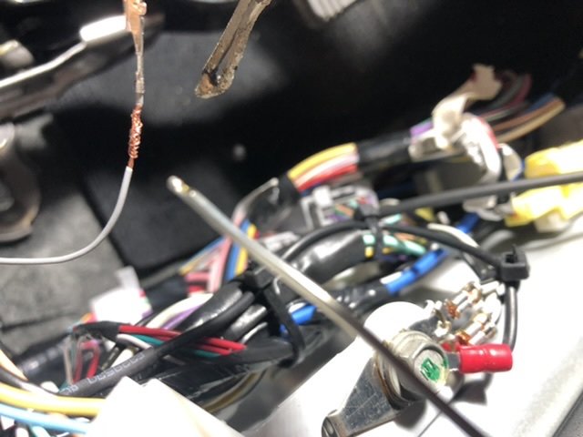

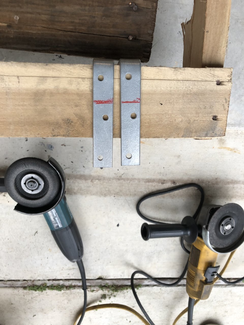

    Got back to work on the truck. Had plans for a prinsu cabrack, and wanted to go the route of bolts n nuts instead of the plusnuts that are included, this meant dropping the headliner. Around the same time, I went to the doc to find out that I’ve lost hearing in both ears...slowly over time without reason, I’m down to 40%. This whole time I’ve lived with it not even knowing. So, I decided to sound proof the ceiling while I had the top down. I figured with the additional noise of the rack, I’d do myself a favor with some sound deadening,dampening
    CFF99627-AE14-48A0-B754-72E14AB9EDF8.jpg 9FCD7B56-C630-4D64-A957-A734E9A7BC6B.jpg 8E431154-9E37-474B-9E20-C35B3F93BE43.jpg
  21. Jun 1, 2020 at 6:38 PM
    hookdem
    Sep 12, 2018
    #19338
    73
    Austin, TX

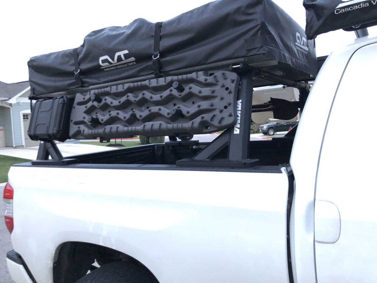

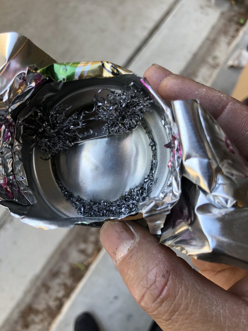

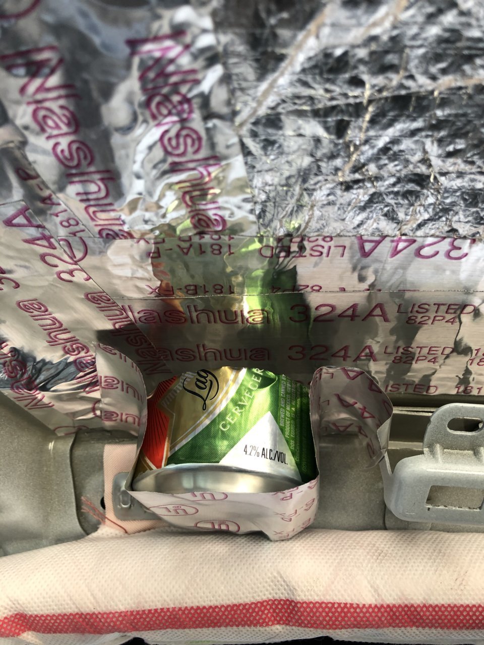

    And then the rack went on
    (Semi) pro-tip: drink a beer first, use the bottom of the beer can to place below the drilling point to catch the shavings...there will be many. I put a magnet in the can. Imagine these shavings exploding into your face when the airbags go off, while you enjoy another beer knowing they won’t
    ...and if you don’t have a third hand, then a beer box on the head rest does well to prop the headliner up while you get it back in line
    7F97ED7F-DD2F-4BAF-9A81-C339FA583D8F.jpg 1B0887D6-CB61-48A3-903D-C6D4CA35E5F1.jpg B2EDACB7-1C64-4833-820F-231A6E765539.jpg

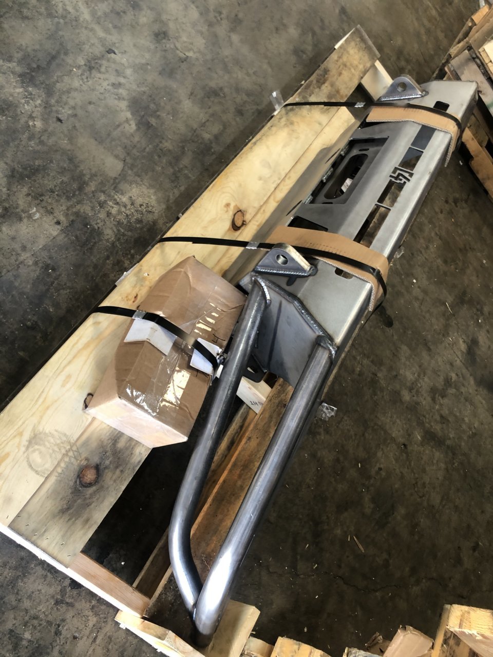

    I have this bumper ready for install, along with more lighting and other electrical accessories. Just waiting on a good chunk of time to knock it out.
