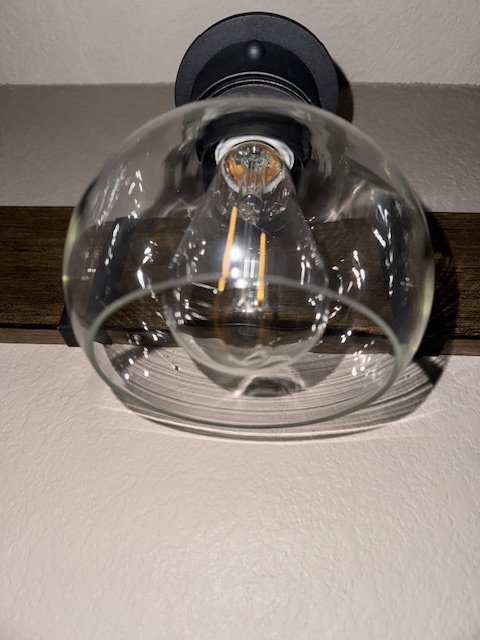

Bathroom fixture with LED bulbs strobe effect.

    Do you have a dimmer switch wired to them? The dimmer needs to allow for LEDs

    ^ if you have a dimmer switch and not dinner bulbs, this can happen

    Have you changed the switch?

    Can confirm, my kitchen was fine…until the bulbs I used for 9 years stopped being manufactured.
    Went with the equivalent, in an LED model. Would get random flickering and strobing.
    Swapped out the wall dimmer switch for a new one (led compatible) and all is well again.
    LEDs weren’t really a thing nine years ago when I remodeled the kitchen, so it is not a surprise that something became out of date.
