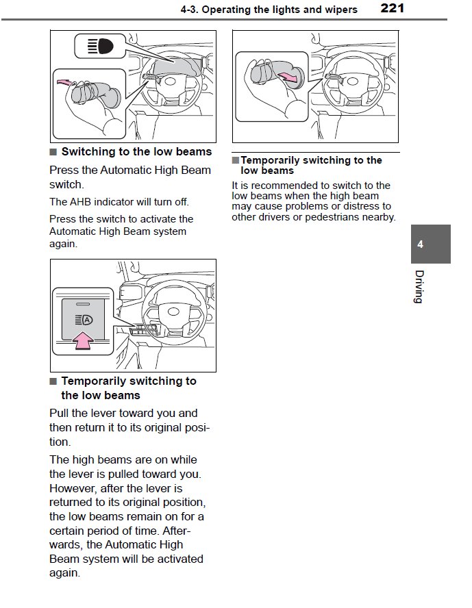

    That’s not how automatic high beams works in new Toyotas. Read your owner’s manual.
    The left stalk does not need to be in a high beam position for the auto high beams to work, just the light on the button and the indicator light on the instrument panel.
    It sounds like user error from OP. OP just needed to press the auto high beam button to turn it off, no need to move the stalk.
    DesmoDoe and JUNNEL20 like this.

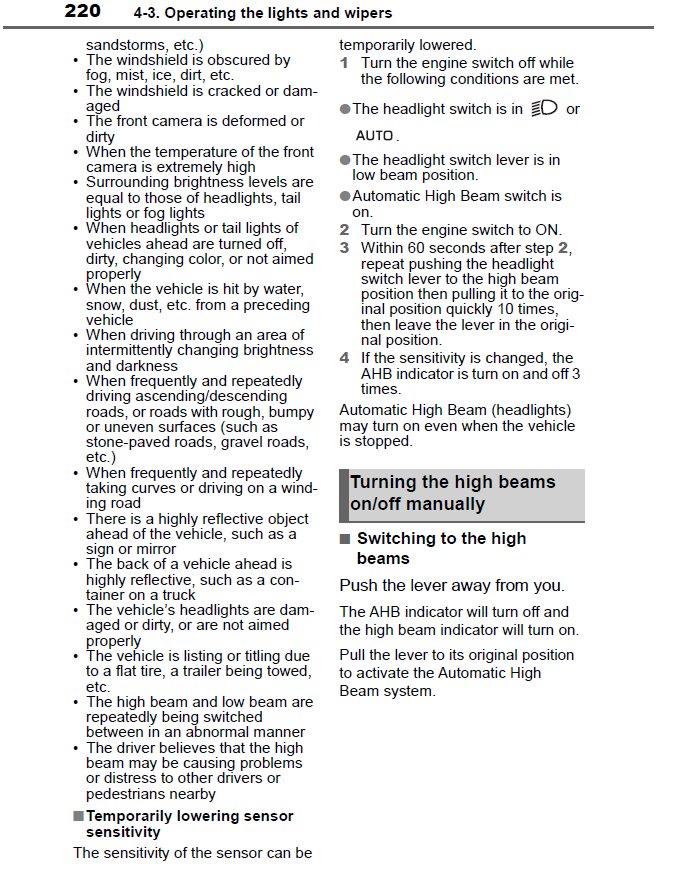

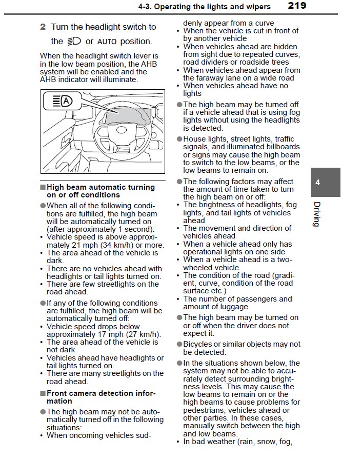

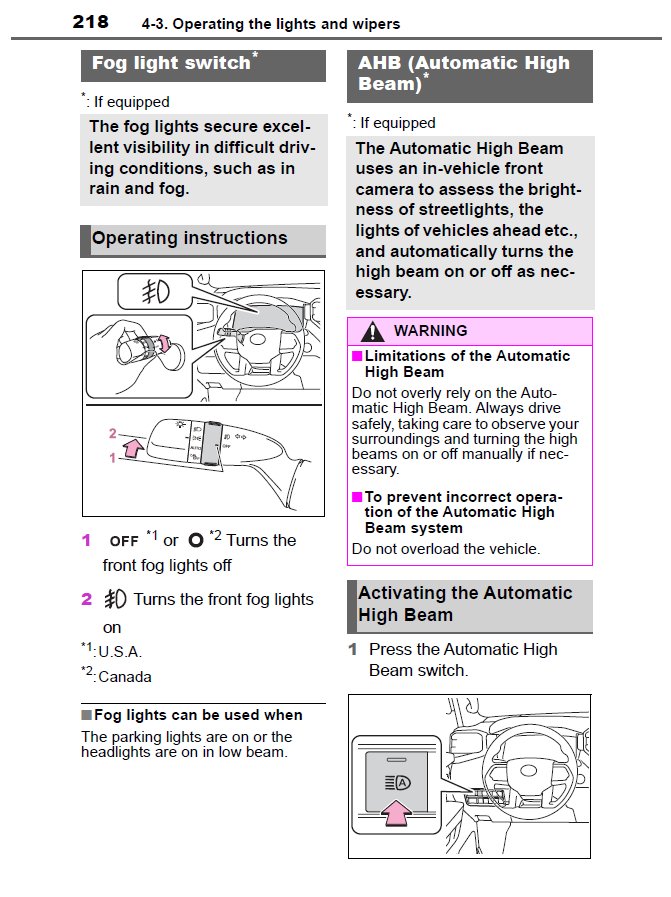

    62
    From the owners manual.
