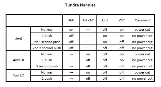

    My understanding from previous research is in 4x4 it basically automatically switches to the 4 wheel equivalent of Auto LSD, which may be referred to as A-trac. It does the same thing auto LSD does but for all 4 wheels. I think. :notsure:

    That's what I think happens when you have the center differential unlocked, but the auto LSD and traction control all turn off as soon as you lock the center differential.
    I know guys have used their parking brakes on the rear axle to equalize the traction for years, I was hoping that someone else had been down this road, and knew of a simple wiring harness hack to get us closer to 3wd, with the auto LSD system engaged in 4h and 4L, with the transfer case diff locked.

    The auto lsd is just A-trac in 2wd. I have not driven the 4th or 5th generation 4runner but I do have a 3rd Gen. The A-trac is in my experience exactly the same. It is quite capable as well. The only time that the power cut has bothered me is when I'm in the sand dunes or deep mud. The solution is just one button push whether you are in 4x4 low or high. A-trac works best are about 1800 rpm. It is a pretty amazing system.

    Unfortunately it wouldn't help. You would need a mechanical torsion style LSD or a locker. To maximize traction on the Sequoia first you would hit the auto lsd button. If that didn't work hit the 4x4 button. Need more? lock the center differential. Then a single button push. More? At that point you would probably be in 4 low, if you need more you need to do a single button push. Let er rip. Don't break anything.
