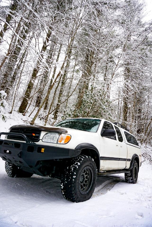

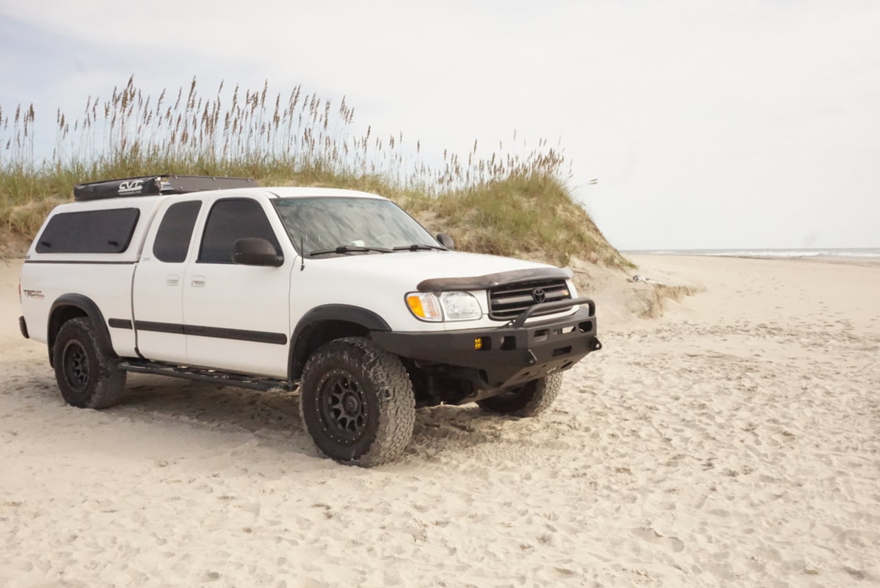

    Really pleased with my decision to get the brute force bumper. The quality is outstanding. I've met a few first gen owners recently and gotten huge compliments on my truck and bumper.
