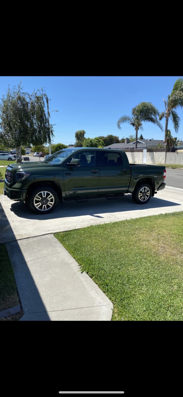

    Hey everyone. Trying to create my build and it’s my first time doing this on this forum so bear with me. I have learned valuable information from this site and thought it was only right to try and potentially help some others out.
    I bought my 21’ tundra cm trd sport end of July. Stickered 51k, tacked on 5k because they could. 4wd, pred steps and dual exhaust came with the truck. Here’s a pic of her when I got home from the dealership

    here she is after lift/ tires/ wheels :
    I replaced all shocks.
    Front : bilstein 5100 set at lowest setting
    Rear: bilstein 5160
    added icon AAL to rear for my rear lift.
    Added WESTCOTT DESIGNS pre collar lift to front. This is a great option. It goes below the 5100 and overall, with bilstein set to .87”, gave me about 3” of lift in front. Westcott advertised this lift as being able to clear 35’s with no BMC and they were correct. Had some trimming(removed flaps etc ) but that was it. No rubbing whatsoever. And the Westcott lift is only around 300$
    added methods 701 and bfgs 35 12.5 18
