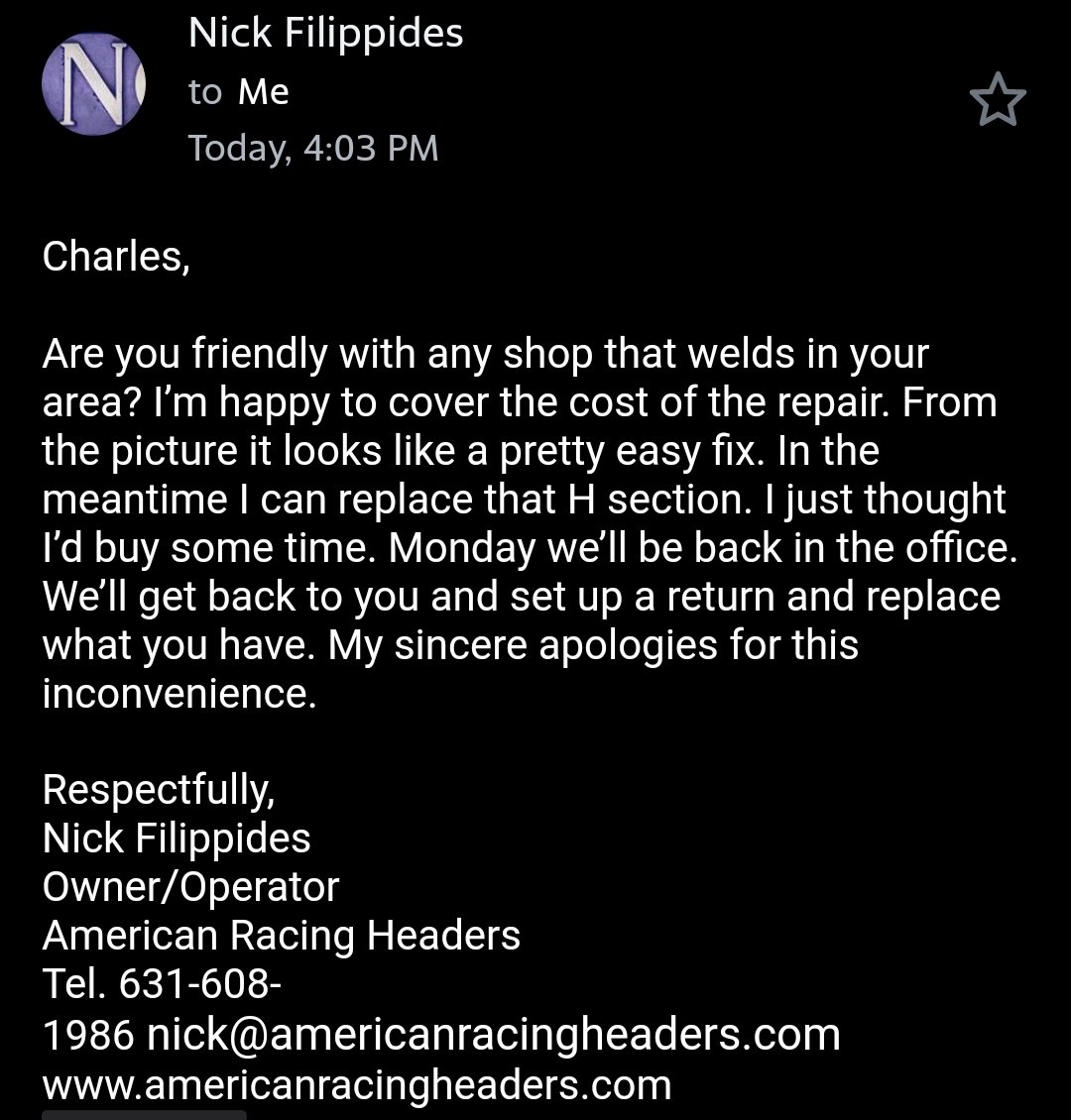

    Looks like they're gonna take care of it

    Sounds like ARH is a company worth staying with.

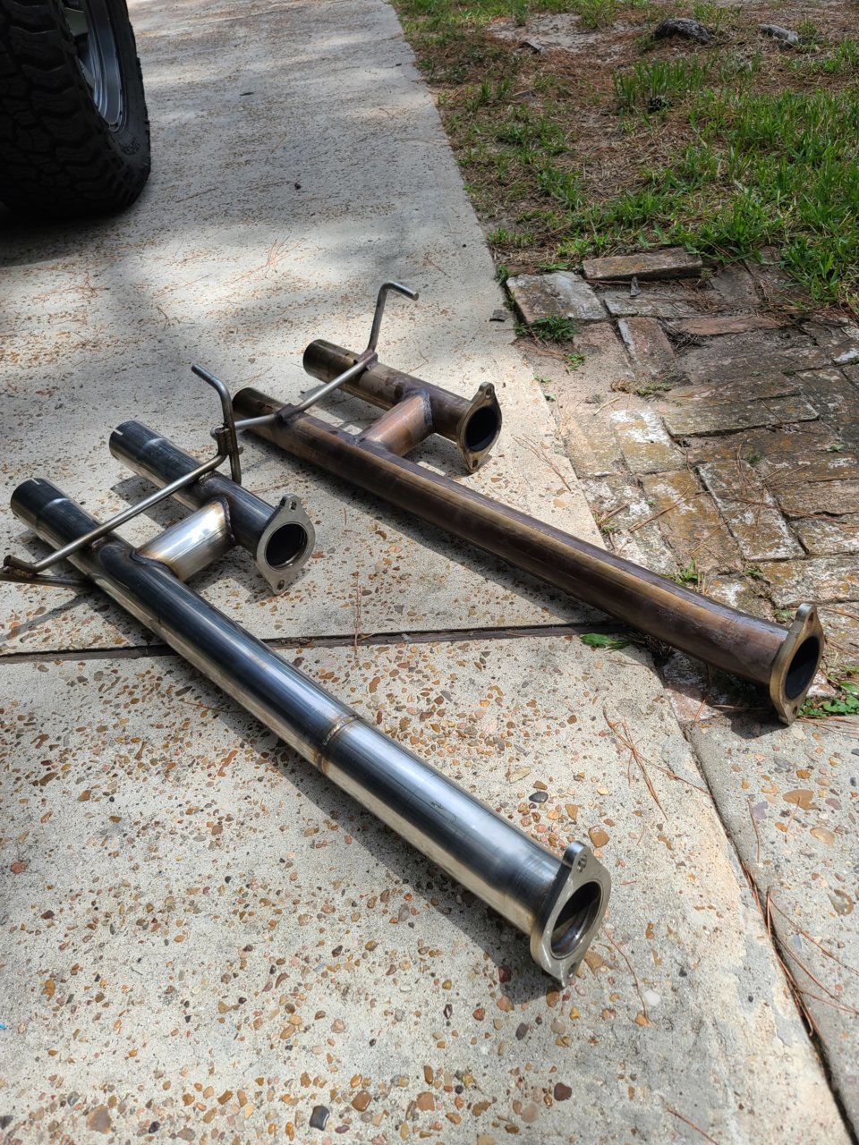

    Sure was fun taking the old one off

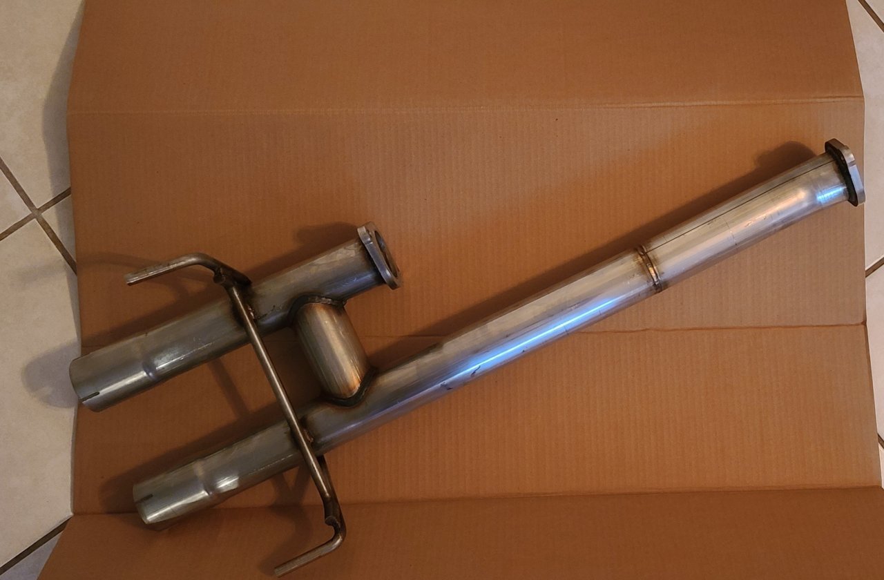

    Any suggestion on how to make this work? The diameters of the muffler inlets and mid outlets are damn near the same. He flared the mids a little but not enough. The old piece went inside the muffler and wasn't flared.

    Get an exhaust spreading tool from a local auto parts store. Most have them for loan.
    ColoradoTJ likes this.
  17. Jul 31, 2022 at 3:39 PM
    4firemandan
    4firemandan Superduper Member
    Jul 25, 2018
    #17394
    179
    Dan
    SWFL
    2016 Crewmax 4x4, 5.7
    TRD Supercharger, Ported SC inlet, RCF TB, 4.5” intake, WMI, 2.38 pulley, custom tune, DW660 inj, aeromotive fpr, msd boost-a-pump
    I'd also get a nice 2in or 3in band clamp too.. otherwise you'll have a little issue sealing if you can't get those to slide past the notch.

    looking at your pictures above, looks like they flared where it was supposed to be tapered.
    Your old one didn't have that, just smooth pipe.
    if they did that, give em a call and show them that pic
  19. Jul 31, 2022 at 3:53 PM
    texasrho83
    texasrho83 [OP] Ye Olde Member
    Mar 30, 2017
    #7025
    12,008
    Charles
    Conroe TX
    2016 DC MGM 4x4
    See build link
    Yep, got off the phone with Nick and he admitted they F'ed up. Now my truck will wait until I can get the new piece in. He is gonna overnight it once they've made it.
