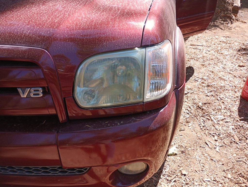

    Greetings all,
    I am not quite satisfied with the original headlights, so I had been searching for options, see infra. While looking at the different pictures, it seems to me that my headlights are rather different – see pictures. Can anyone confirm that these are the OEM headlights? Or is the perceived difference in that my headlights need to be resurfaced?
    The modification options are well summarized in the thread https://www.tundras.com/threads/best-1st-gen-headlight-solution.122680/#post-3145307, post #3.
    Re option 1, I have reviewed the thread linked the above post, but is it noe clear how to install the harness. Is there a thread that would explain this better, perhaps with pictures?
    Re options 3 and 4, which of the aftermarket CAPA-certified housings would your recommend, e.g., Depo, EagleEyes, TYC, etc., if there is a difference? Ditto the supplier/vendor, I do not want to risk a fake Amazon item.
    Kindest regards,
    M

    Those look like OEM
    Sitting in the sun over the years, the sun fades the clear coat on the lens
    You can polish them with the auto zone headlight kits and then use automotive clear over them and they will last a long time. If you polish them, you will get about a year before they yellow again. If you put automotive clear over it you will get 5-8 years.

    Once you polish the lenses, you will be repeating the process once every 2-3 years most likely. Note that you may run into what others and myself did, where you polish your lenses only to find they have very fine cracks hidden under the haze, which are refracting light everywhere, so you wasted your time and money polishing a cracked lens.
    What you’ll pay for a GOOD kit like Cerakote is, like, half of almost the entirety what you’d pay for a new and new CAPA certified housing for some models. And everyone has their brand preference, I used DEPO, I’ve used TYC, and I’ve used Eagle Eyes, I would personally buy based on whether that brand has both a left CAPA and a right CAPA specifically for your cab type.
    To that point: Be very careful! Make sure you read RockAuto’s notes for cab type. You need the Double Cab (sometimes they call it “Crew Cab”) headlight housings. Regular/Standard cab and Access/Extended cab housings won’t work for your truck.

    Find an automotive paint store, they sell clear in a can. The better types have an activator in the bottom of the can, this makes it a one-time-use-only so you would typically want to pull the headlights out and tape them up, or tape everything up real good on the truck and polish them, clean them, and then apply the clear coat just as if you would be doing over paint.
    The clear coat on the lens is what protects the actual plastic from turning colors.
    The clear coat turns colors over time
    The clear coat breaks down and allows sunlight to discolor the plastic lens
    If you get it early enough and polish the headlights you are typically removing the clearcoat AND polishing the plastic. This causes the sun to bake the plastic lens quicker and you will get about a year out of the first polishing, and then 8 months out of the second polishing, and 6 months out of the third polishing and then the next time you polish you will realize the plastic is yellowed thru the inside and even though you polish the outside, the lens is still yellow thru and thru.
    If you polish them and clear coat them with automotive clear in a can you will seal them up and get 5-8 years out of them easy.
    If you wanna buy new ones, just buy new ones. Its your call really.

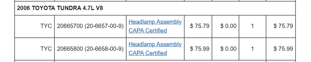

    I took a sec to look up your truck, link: https://www.rockauto.com/en/catalog...,body+&+lamp+assembly,headlamp+assembly,10762
    It looks like your two main options are the Eagle Eyes at the top, and TYC a bit lower down (with the hearts). They have the dropdowns that let you pick CAPA or 'Regular Inventory'. Eagle Eyes are clearly cheaper by about $10. I prefer TYC, but Eagle Eyes is perfectly fine.
    But main takeaway: If you do choose to do this, I would recommend carefully inspecting your lenses for hairline cracks like this BEFORE you start - see mine below, which only really became clear after polishing - no polishing will fix that. I knew the larger ones were there, but I couldn't see all the spider-webbing cracks before starting. And if you have none, I would urge you to fully remove the housings and work on them while off the truck so you don't risk any collateral damage to your paint, and you can let the clear dry somewhere indoors, where there's less risk of airborne stuff embedding in the clear.

    They look OEM. That corner lense may not be but maybe it's not sitting where it should be...if you don't clear coat after polishing you do have the option of PPF instead. I've had it on my OEM retrofits for a couple of years and it's holding up great..worst thing about PPF is its harder to get baked on bugs off than just plastic and clear.
    You'll need to wet sand with various grits and then compound/polish those or you're wasting your time and will be doing it again. Take your time, watch some videos and go from there. Fairly easy with some wet sand paper And a da.

    As cheap as decent aftermarkets are for mine, I went that route. But, if it was $300-500+ a side, then I would live with repolishing every couple years.
    I got the TYC ones (and remember mine are DC, so essentially Sequoia lights, not like the AC/RC) and they are really quite good. The other reason I went for replacement is that the PO had at some point removed the rubber seals where the bulb is and the silver paint on the inside was just meh. I could have tried baking, separating, cleaning etc, but who has time for that shit.
  23. Sep 1, 2025 at 7:26 PM

    Just in case the OP decides to go with aftermarket in the future. Notice they have a DC also. This was back in March, but these are the part numbers from Rock Auto. They are actually a little cheaper right now.
