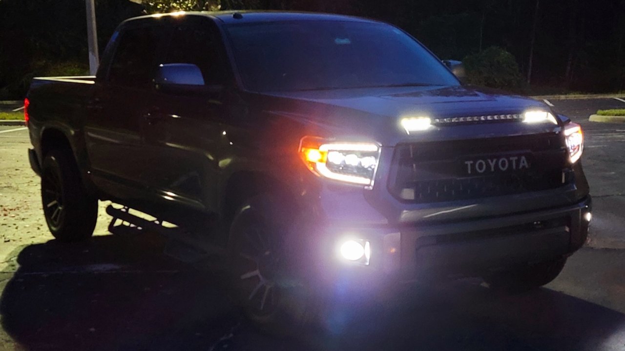

    I purchased the NSV light bar from HR last Black Friday (2021) and it will come on with the High Beams (but not when on 'Auto'). To get the fog lights to come on when on your High Beams, I've been looking at the Brite Box based on another thread.
