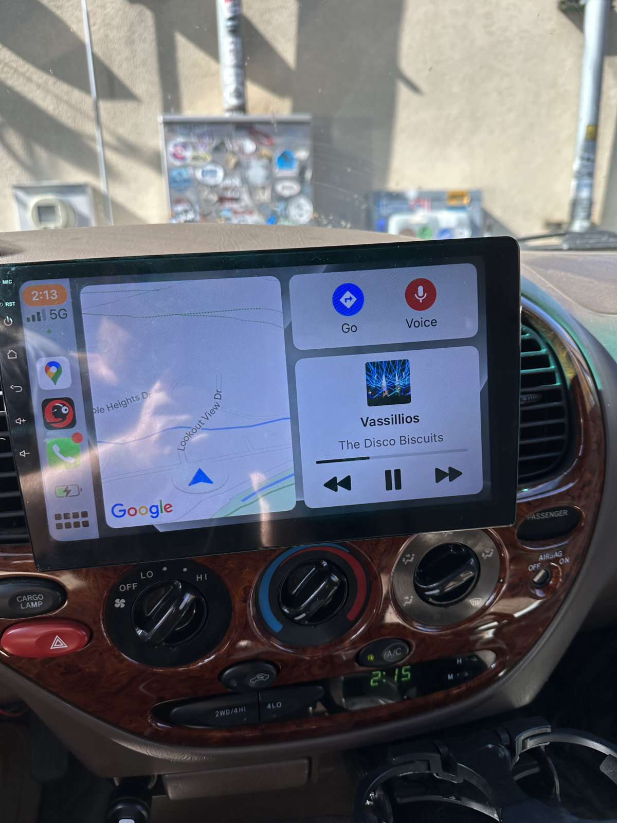

    Ok friends. I put a Eonon Q03PRO head unit in my Tundra because I wasn't getting much use out of the tape player. Love it BTW if you anyone is interested. The wireless carplay works great and the touchscreen is very responsive. OnX is a little clunky but I think thats just the app development for carplay is kinda weak.
    I would like to install a front facing and rear facing camera that are linked into a 2 pole rocker switch. I want to toggle on front or rear cams at anytime, without being in reverse. So my question is this. If I just get one of these RCA splitters https://tinyurl.com/RCA-thing and I just plug both cameras to that single cam input, will that work? I assume I just wire the "trigger" wires to the rocker switch rather than the reverse light and then I should be able to just trigger which ever cam I want correct? Thanks for the help.
