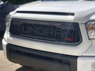

    Screenshot_20200710-134808_Gallery.jpgI didn't have luck with paint but Plastidip works for me. After winter I peel it off and do it again to repair the rock chips.

    I had the same experience. Looked great at first but the rock chips got really bad. Ended up buying a color matched pro grille and bulge a few months later.
