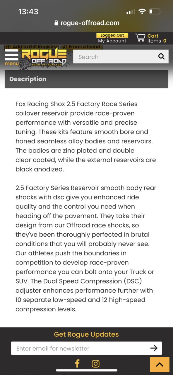

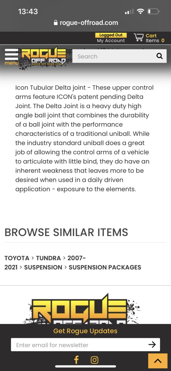

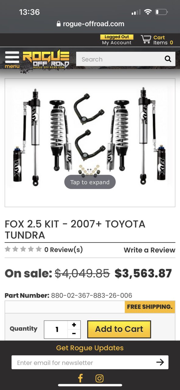

    Debating to get this or not. Looking for some reviews please. Thanks

    Please check your other thread as I posed some questions there..
    Also, note that these shocks are 0-2" - non-dsc coilovers up front, in your other thread you were looking for 3" inches of lift? so these would not fit the bill.
