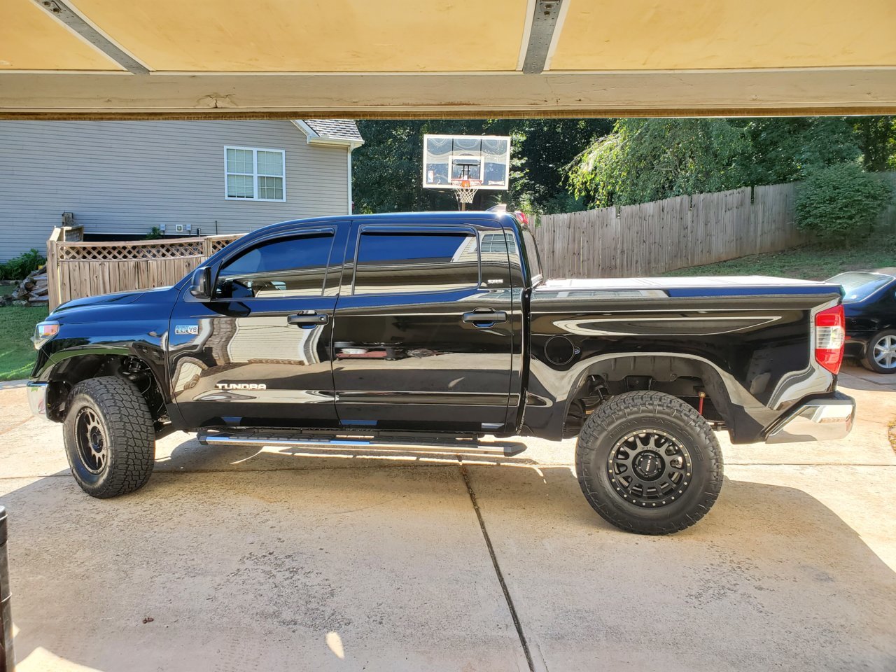

    Started with a 3/1 Reaylift spacer kit and added 2" longer shackles to make it 3/3.
    Rides like stock.
    To be fair... the kit included diff drop spacers, sway bar spacers and skid plate spacers.
    Ive since installed carrier bearing spacers and 2" rear shock extensions.
    I still have upper A-arms to install that will provide better caster numbers... but for now the alignment tech got it driving pretty nice without them.
    I understand some guys like to spend alot more money to feel better... but for what im doing... the spacer kit works and functions just fine.
