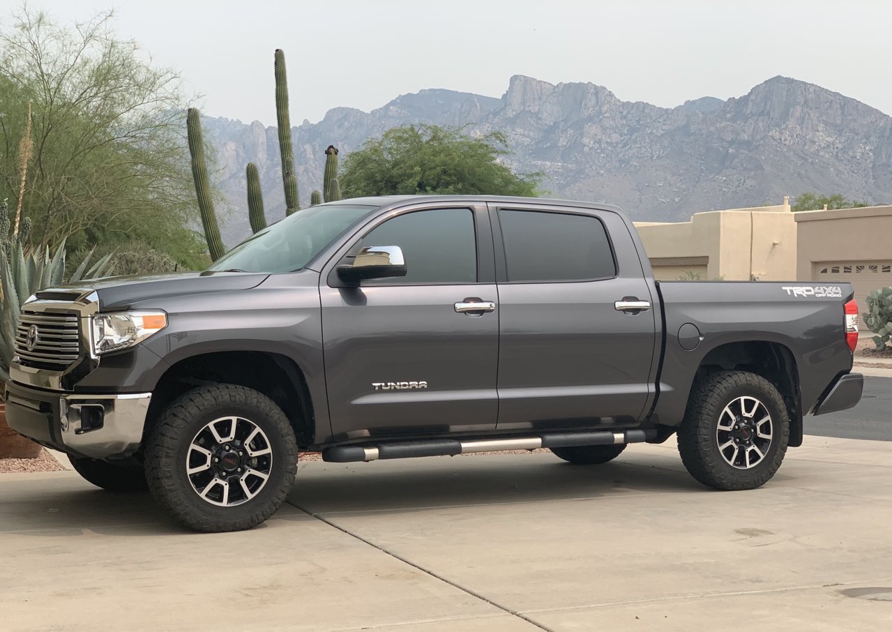

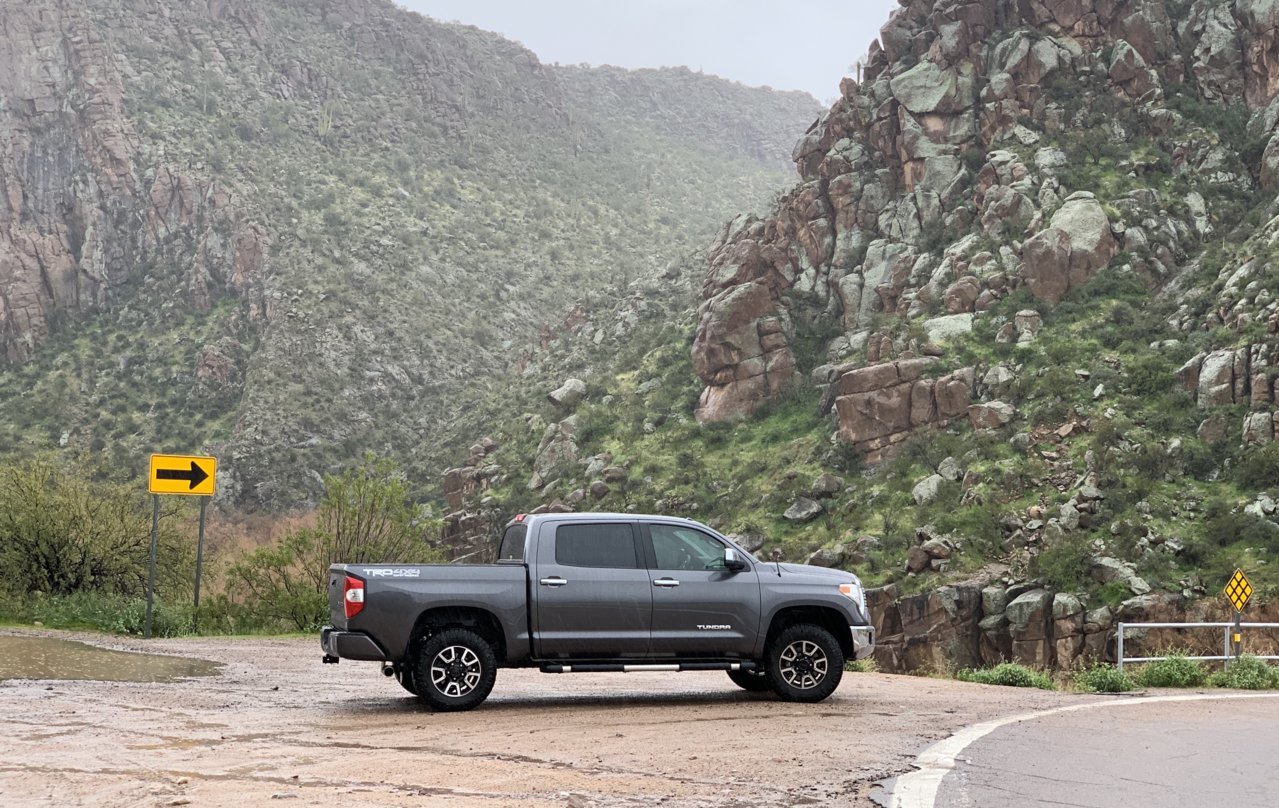

    445926CA-1B64-4CC2-841D-DB31A5FE2754.jpg 5C892EA1-55B4-4940-BC29-1515841EC3D6.jpg

    Nice truck! What size tires are you running?

    Thanks. I’m running 275/70 18 Nitto Ridge Grapplers. (33”x10.5”)

    That looks great. Thanks. Perhaps I will put those +2s on. Do you know if the shackles will hit exhaust- I have a resonator as well.

    You’ll be fine. The resonator only comes into play if you’re adding a big spare tire underneath. The leaf is about 2.5” above the top of the exhaust. I’ve wheeled mine hard and never hit.

    No prob. Here it is
    LF 24.25”
    RF 24”
    LR 25”
    RR 25.5”
    I do have 1 CB shim on the driver’s side
