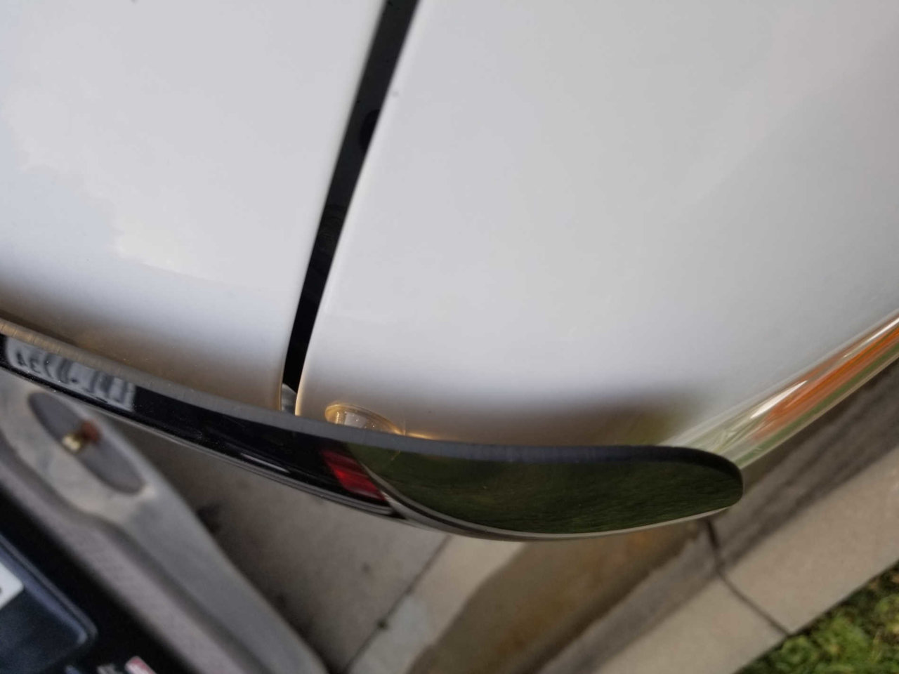

    rubber bumpers? Its not below the deflector I'm talking about. Its where it wraps around the corner of the hood.

    simonmiles
    simonmiles New Member
    Jul 15, 2018
    #17069
    37
    My deflector came with rubber bumpers that also go near the corner of the hood. If I'm misunderstanding you then I apologize. Here's a picture of mine near the corner of the hood. Your's may not be designed the same way so this might not apply. Hope this helps.
