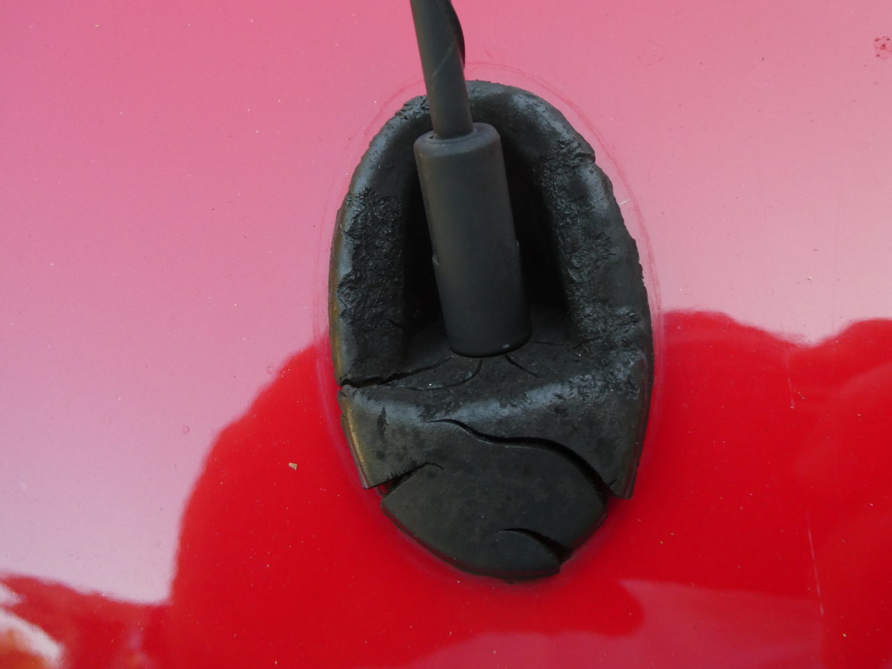

    The antenna bezel (rubber grommet) the antenna comes through on the fender is rotting away due to sun exposure on my 2011. Does anyone have experience replacing the bezel? Can I pull the old bezel off and then slip the new bezel over the antenna and into the fender, or is it a pain to replace?

    Thanks for your personal accounts of replacing the bezel. I ordered the Tundra bezel, will replace soon. Someone requested a picture, here it is:

    Beautiful :laugh: amazing how that rubber is toast after a few years.
