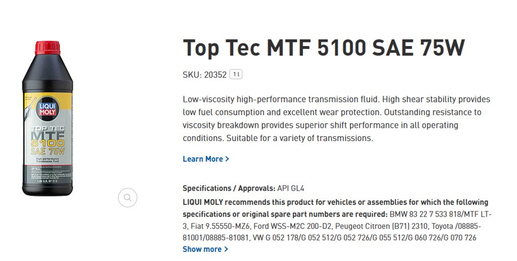

    Liqui Moly MTF 5100 SAE 75W works. I got 2 quarts at Napa for $16 per bottle.

    Both are german brands and make very good lubricants. Just putting this out there because it seems to be more readily available.
    But hey, it's your truck, so put in what you're comfortable with. I personally changed the diffs to supertech 75w90 syn and liquimoly 75w for the T Case at 30K miles.
