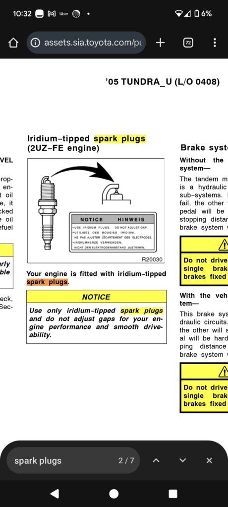

    If you go to Google and type Owners Manual Tundra #### where the #### is your year, you can download a copy of the owner's manual for your Tundra, latest copy, direct from Toyota. Here's the 2005: https://www.toyota.com/owners/warranty-owners-manuals/vehicle/tundra/2005/
    In the 'Specifications' section - and believe me, I know, nobody bothers to read the fucking manual for much of anything, especially us men, we should do better! - but they tell you everything you need to know about replacement parts. As mentioned above, 2005+ calls for Iridium, but I'd be using Iridium plugs in the '00-04 too, they last twice as many miles.
    NOTE: There is a typo in the manual for the DENSO plug on the 2UZ, it says KS20, it should be SK20! But I prefer NGK products.

    Thank you shifty! Looks as if the ones I chose from Rock Auto are the right ones. The gap is off by .01 if I’m reading this correctly. I did check my owners manual and it displayed what you showed above. Glad I double confirmed here. Thank you everyone.

    You never gap iridium plugs. They come pre-gapped and shouldn't be adjusted. Risk of damage isn't worth any semblance of change you'll see.

    And the owner's manual specifically warns against adjusting gaps on iridium spark plugs

    I found my owners manual along with the original window sticker. I will be digging into the manual!

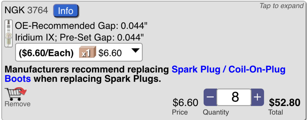

  16. Nov 26, 2025 at 9:42 AM
    ChattanoogaPhil
    ChattanoogaPhil New Member
    Feb 28, 2021
    #59762
    560
    2000 4.7 AC SR5 4wd tow package
    Putting this and that in the Serra cart...
    Other than a buck difference, any reason to choose one over the other for a daily driver?

  17. Nov 26, 2025 at 9:55 AM
    bfunke
    bfunke Tundra Curmudgeon
    Oct 13, 2019
    #37321
    3,013
    South Carolina
    2018 SR-5 CM 5.7, 2000 SR-5 AC 4.7L
    I believe the cheaper one is correct for your 2000 non-VVT engine.
    ChattanoogaPhil likes this.
