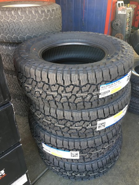

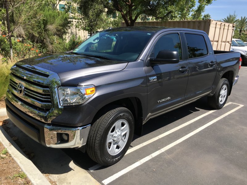

    IMG_0335.jpg Happy day today. I ordered an SR5 CM in MGM a couple months ago. It came in today and I'm already up to no good. IMG_0336.jpgIMG_0338.jpg

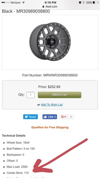

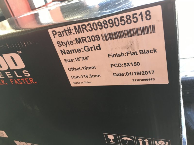

    Welcome bud. You might want to check on your Methods. I believe the center bore size should be 110mm, not 116.5.

    Crap...:confused: The shop sized them so I'll wait and see. They are installing now.

    Our wheels are hub centric so it needs to be correct. Make sure there's no gap at all, it may be hard to tell if they tighten the lugs really tight.

    Thanks for the heads up. They pulled the rims off and checked. The rims are designed for the center caps to go all the way through. When he pulled off the tire though, the lugs from method look like they are designed to be lug centric. It drives fine. Either way I'll email Method in the morning.

    It may drive fine now but why risk it? It's probably going to put unnecessary stress on the bolts and it doesn't take much to develop a wobble. They ordered the wrong wheels, make them correct their mistake. There's a reason they sell the methods in our specific bore size.

    Your good, Method wheels are not hub centric, they are lug centric.

    It's one thing if you really wanted these wheels and they didn't have the correct bore size. But they offer the wheel in our bore size. It definitely won't hurt to have the correct bore. I've read of people having vibration with Methods and correcting with hub rings. I wouldn't take that risk if I didn't have to.
