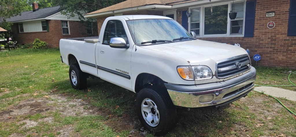

    Need to take my gal to get an alignment after I replaced all the front end bits, any one have the number for it with 2" spacers on the tires? I went to my local dealer & they didn't know what to do.

    Sorry, I thought I put wheel spaces. She's mostly stock out side of the wheel & body spacers, cab to frame, not on the suspension. I have moog upper/lower control arms with moog toe cams.
