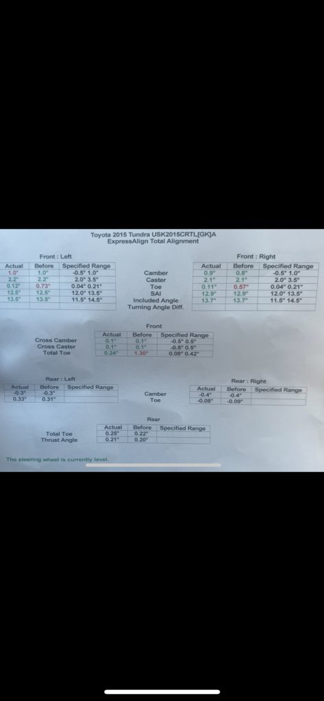

    Told the service advisor the specs i was looking to get based on the info i got on here and this is what i ended up with , what do you think , again i know nothing about alignments truck seem to drive straight and doesn't pull but i dont want any weird tire wear , this was done at the toyota dealership also not sure if this makes a difference but the truck has 1.5” spacers on the wheels

    Someone else can chime in, or you can search (top right, magnifying glass) to get a bit more informed on it, but if I were you, I'd be asking them to explain what, exactly, they did other than adjust the toe.
    That .9 and 1.0 camber is going to continue to notorious Tundra edge wear.

    Herd back from the service manager he apologized for lack of adjustment and said its most likely because my truck has been in new england most of its life that the lower control arm eccentrics are frozen and probably need to be replaced along with the lcas and wants me to bring the truck back to come up with a “plan” . Any way i can investigate this myself to see if they are frozen before
    I bring it in to call bull shit i just installed the shocks couple weekends ago but didnt drop the lca instead i undid the top ball joint. Is it just a matter of turning the cam bolts or more involved , i have a feeling if i go back they going to try to tell me everything is frozen and needs to be replaced before they own up to slacking on my alinement by doing a toe and go
