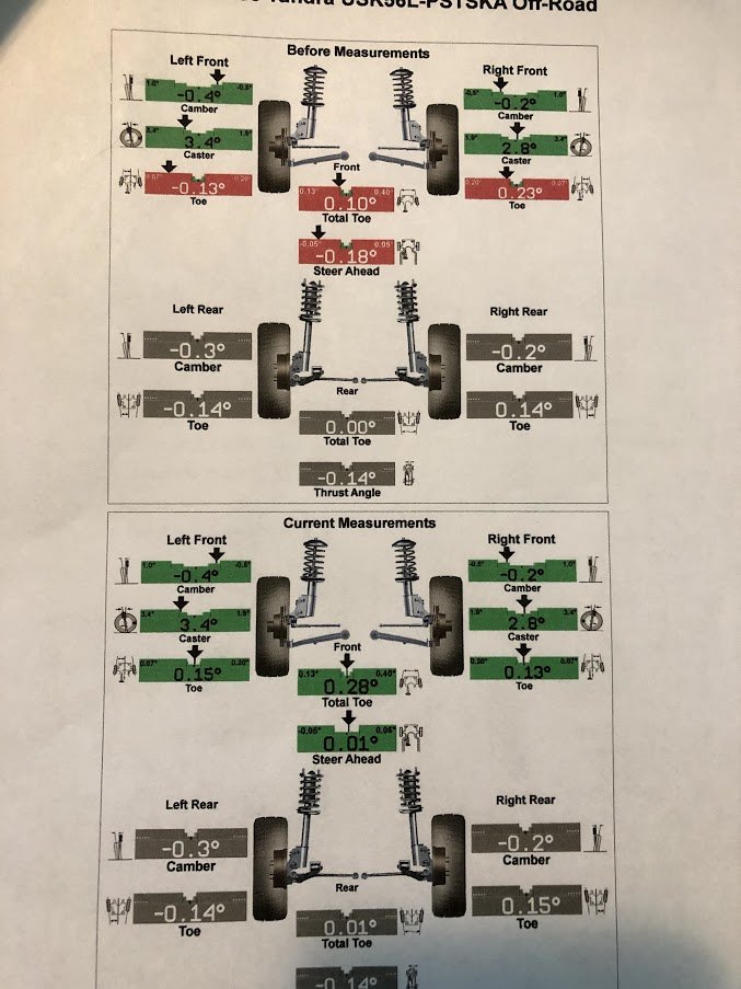

    I’ve noticed lately that my steering wheel is off by about 1-2 degrees. I had the alignment check and indeed it is off about 0.07 degrees toe(?). The service guy said it may help but he things a steering rack problem it more likely. What do you all think?
    There isn’t any drivability issues or weirdness. It has 85k on the odometer and has spent 95%+ on-road.

    Well Never-mind. They tried talking me out of an alignment because it was barely off, but I insisted. When they put it on the real alignment lift and did it, it was way out on both wheels. Definitely needed an alignment, and that fixed the wheel.
