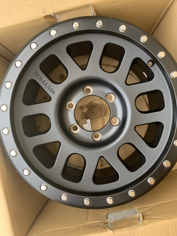

    Update: bought a method rim from offerup. It’s not a direct match but close enough. All the measurements line up. Got it for $125. I can finally wheel and drive with peace of mind.
    Will still be on the search for an exact match 305 nv in black.
    but here she is. Total spare cost was $275 with a matching new ko2 spare from another seller.
