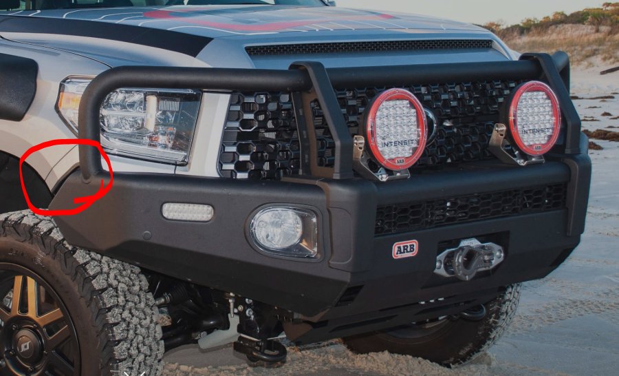

    I never have. I had ARB bumper on my 99.5 Disco II and 99 4 Runner. No chopping of anything. From what I have seen there is no chopping of panels for the Tundra. I could be wrong. Wouldn't be the first time.

    33,208
    18" TRD Off Road Wheels
    I can't say for sure either. I've never had one. Here's a pic, and I circled a spot that I assume you'd be trimming, and if not, I don't think it's going to protect that spot from damage. If it's not trimmed, then it sits in front of it, and any impact is going to drive the bumper back into the body, and grill. It looks like it would increase damage to the truck.
