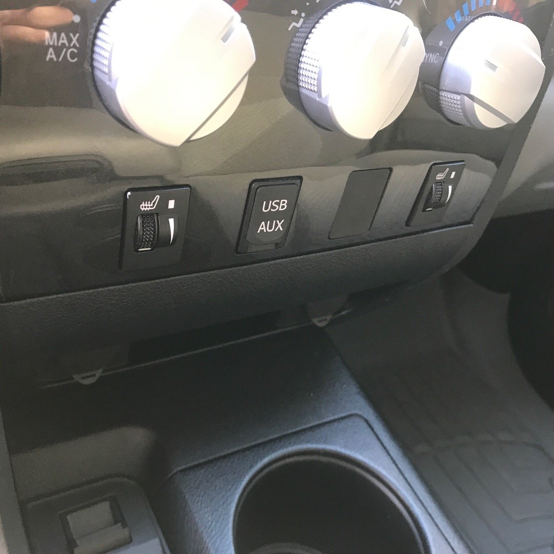

    Yes, you can get aftermarket heated seats that work and function like factory ones. Some models even have the switches fit the factory blank spots so it looks like factory too.

    You can go this route about it: go find an upholstery shop that will be able to take factory bottom and back seat covers off, add the heating pads, and reinstall the seat covers. Then go to any car stereo shop and have them wire everything up. OR ask if the upholstery shop can do the wiring too. It’s pretty straight forward on the wiring part. I think it was 3 wires per seat.
