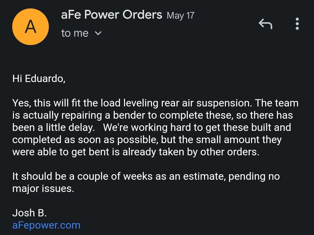

    They sent this to me on May 25th

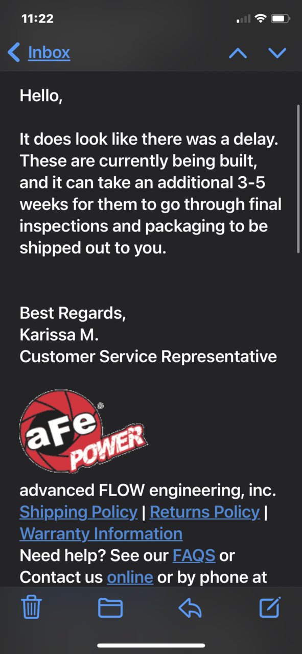

  6. Jun 1, 2023 at 5:13 PM
    Toyota559
    Toyota559 [OP] New Member
    Feb 9, 2022
    #74363
    75

    Yeah, their benders been down since before 5/17
  8. Jun 1, 2023 at 5:29 PM
    Jarrow
    Jarrow New Member
    Apr 9, 2023
    #95219
    350
    Cheer up, bender
