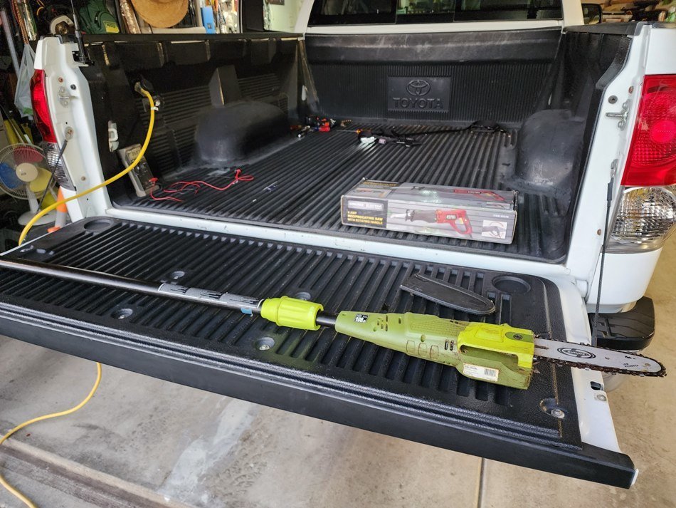

    Question: It isn't clear to me if you want AC in the back of your bed or if 12VDC is OK. If you want to plug in a drill or battery charger, it would be nice to have AC. For 120VAC......I did this in a different (2.0) generation Tundra. I used this AC outlet https://www.amazon.com/dp/B09L7Q95HZ There was enough room between my bed liner and bed to mount it. If you want to run tools, you probably want to get a 1000W inverter. 1000W is close to 100A at 12VDC so you will need to run about 4AWG wire to the inverter. It is best to mount the inverter in the cab so it doesn't have to see any moisture/weather. The inverter output is high voltage so you don't need really thick wire into your bed. I ran some 14/2 UF-B wire (rated for direct burial and outside use) from my 1000W Renogy sinewave inverter. I can run my pole chainsaw no problem.
