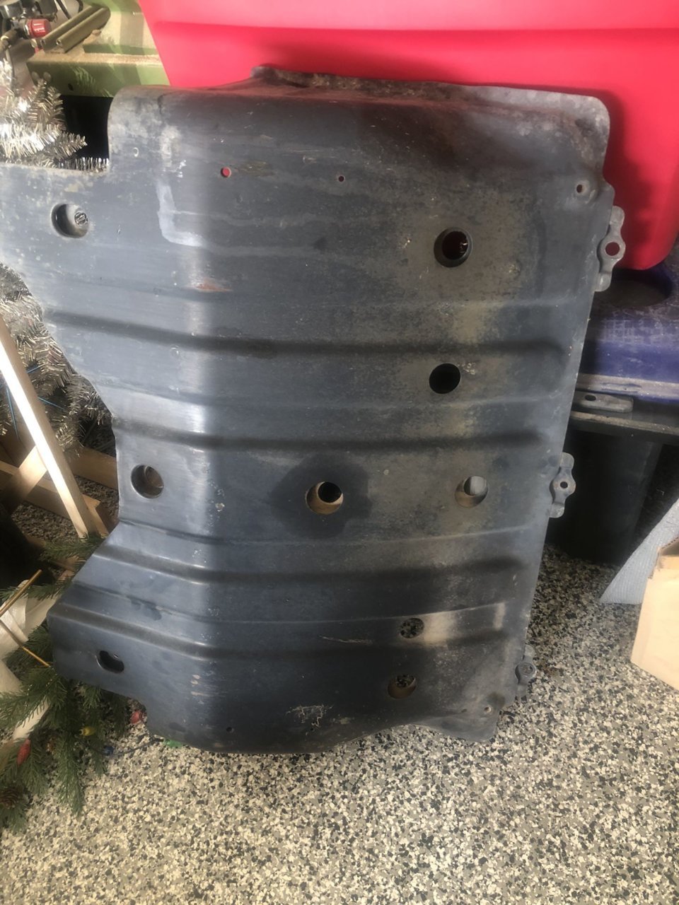

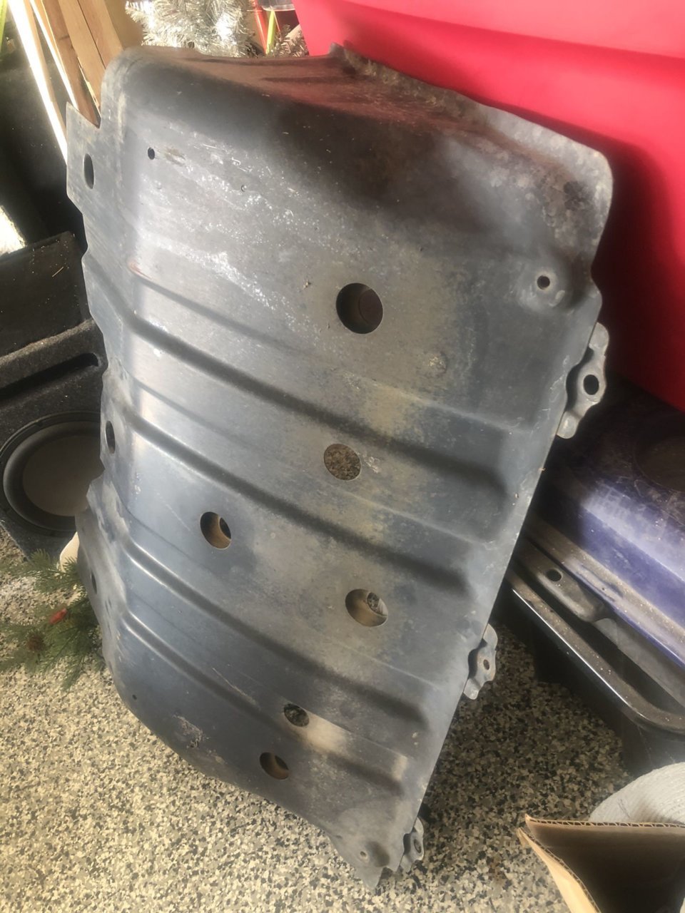

    Hey guys, Can't seem to find a solid answer searching.
    I got an OEM skid plate when I first got my truck, I have a 2001 AC, but I tried to install it and it's way off...
    So I'm just wondering if there are differences with AC vs DC skid plates?
    more of just info for the next person.
    It's in great shape so I don't want to just chuck it...

    The construction makes it a problem, multi-layer metal with space in the middle but I didn't check if it's possible.
    Generic picture of the OEM plate:
