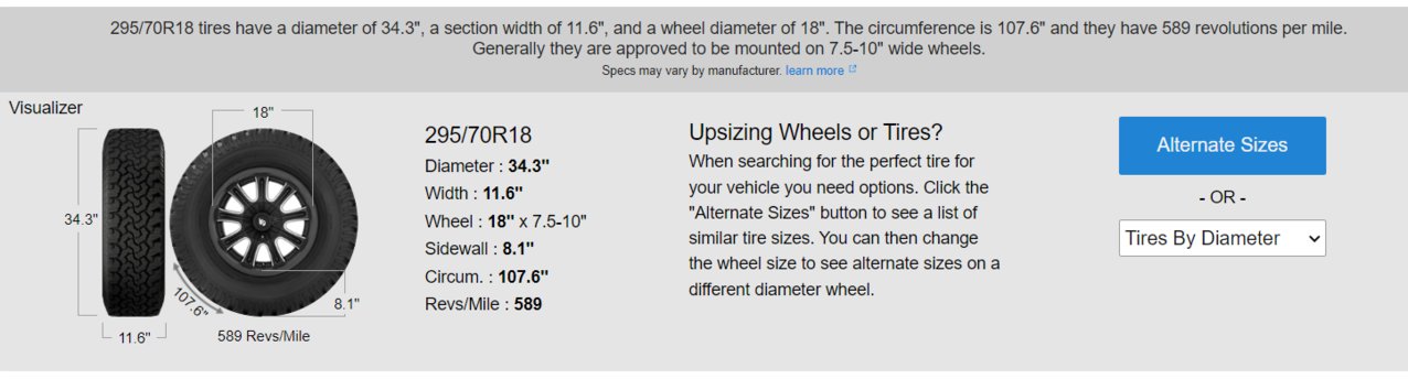

    I entered my truck, it gave me almost every size BUT the 295/70/18 I have, I clicked around looking for a way & it locked up my computer with the MS we detected a problem call 888scamyou & I had to kill Chrome.
    Sorry if you are offended by reality.
    Also, I got the 42lbs I need for my Cooper ATX3XTs from Cooper.
    Also, there is no pressure data there.

    FWIW, I did the chalk test & came up with 42-43lbs & then asked Copoer who said 42
