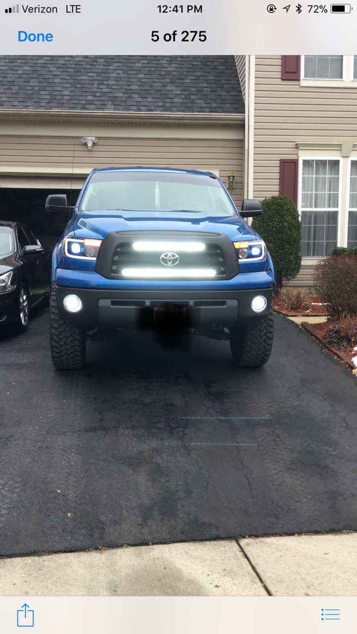

    I love my spiders, and they sit right in the back of a car’s rear view
    If it gets too dark on back road then you will get these also
