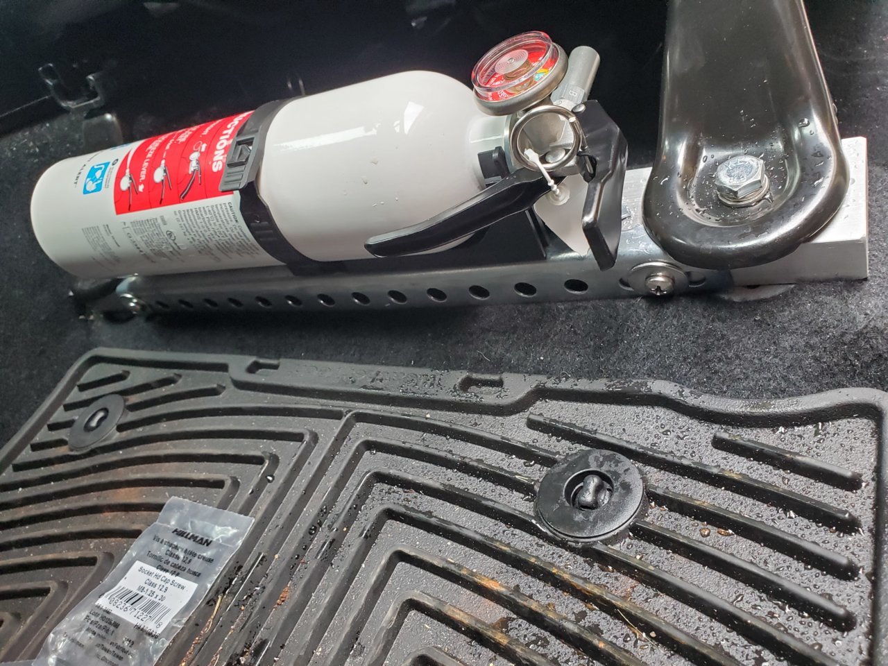

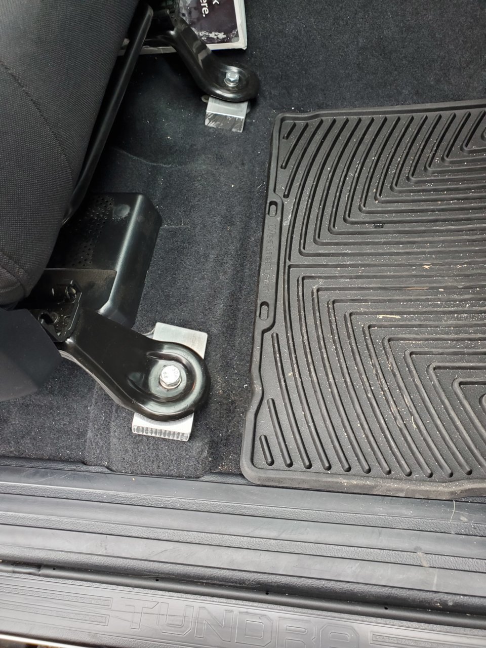

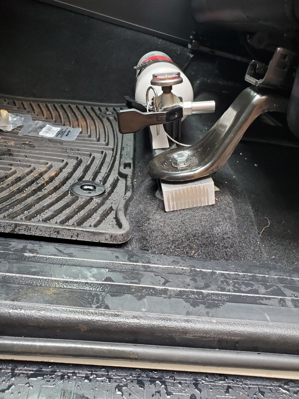

    Yes I did:

    And boom $90 saved

    Well I have about $70 in it, including fire extinguisher, and that's for doing both front seats.

    How thick I that? I have several ft of 3/4x2 aluminum

    The safety is in the hardened spec bolts used for this application not the spacers.
  18. Mar 15, 2022 at 2:57 PM
    snivilous
    snivilous snivspeedshop.com
    Apr 16, 2019
    #29192
    5,242
    SW UT
    300k+ Supercharged 2008
    Hardness doesn't necessarily contribute to strength. It looks like those spacers index to the seats and the body mount to transfer load, if that's the case then the geometry is arguably more important than the bolts are.

    Can you provide a "how to" on this? Looks good!!
