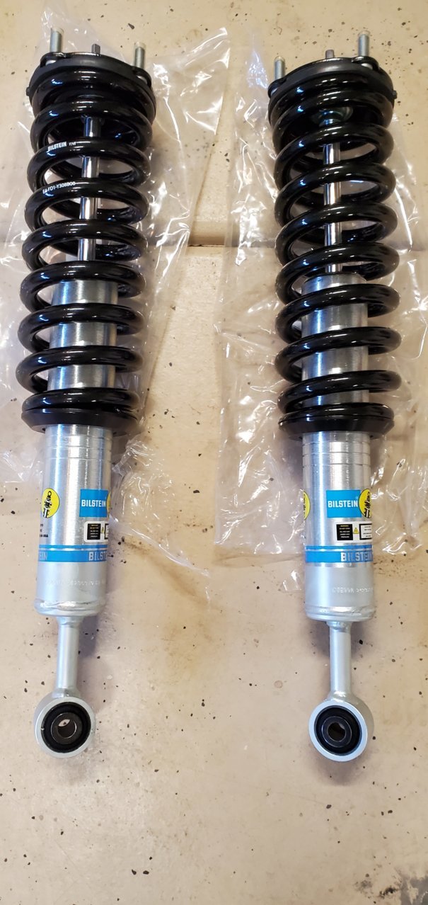

    Question for you all...Can you tell if these are on the top setting or the 3rd?

  9. Feb 18, 2020 at 5:02 AM

    Looks like the 3rd setting

    3rd.

    Theres only 4 settings on the 6112. .75, 1.3, 1.9, 2.5 ish on heights

    You're on the 4th setting The 6112s only have 4 settings: 0.75, 1.3, 1.9 and 2.5
