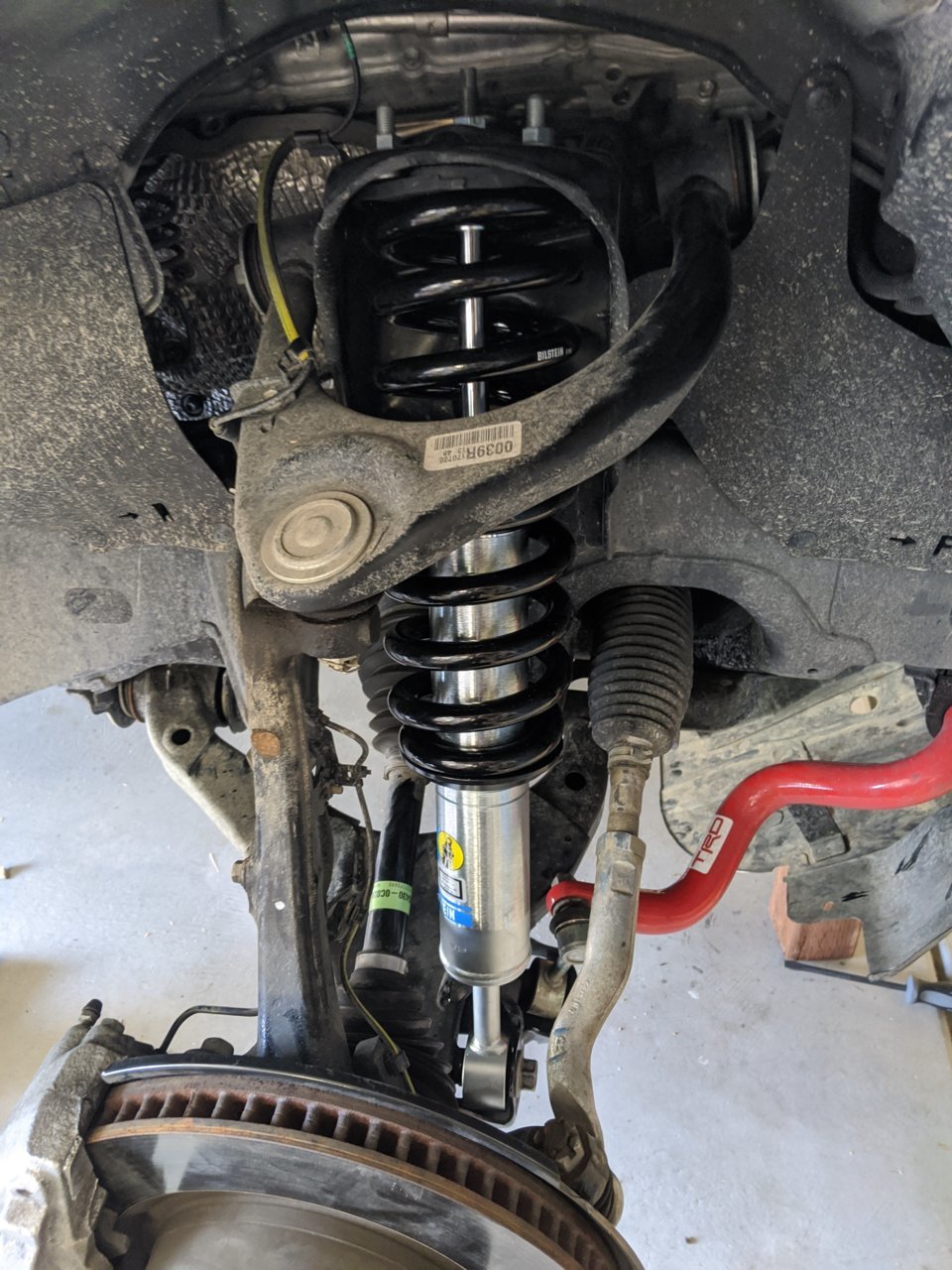

    I don't see how they could install them incorrectly. Not my pic but they should look like this

    There is a mark on the top plate that is supposed to face away from the truck. I don't know what happens if its 180 out. The mark is pretty obvious though.

    Yeah, after him telling me that, your pic shows why he stated it only goes on one way. Guess Bilstein could have mis-printed the labeling, seems odd though. Everything seems to be handling fine and I am getting no noises or pops and both sides are within a 1/4" of each other. I go back Monday for alignment. Giving a day or so to settle.

    The diameter of the coil is different between top and bottom. I would think there would be a definite fitment issue.
