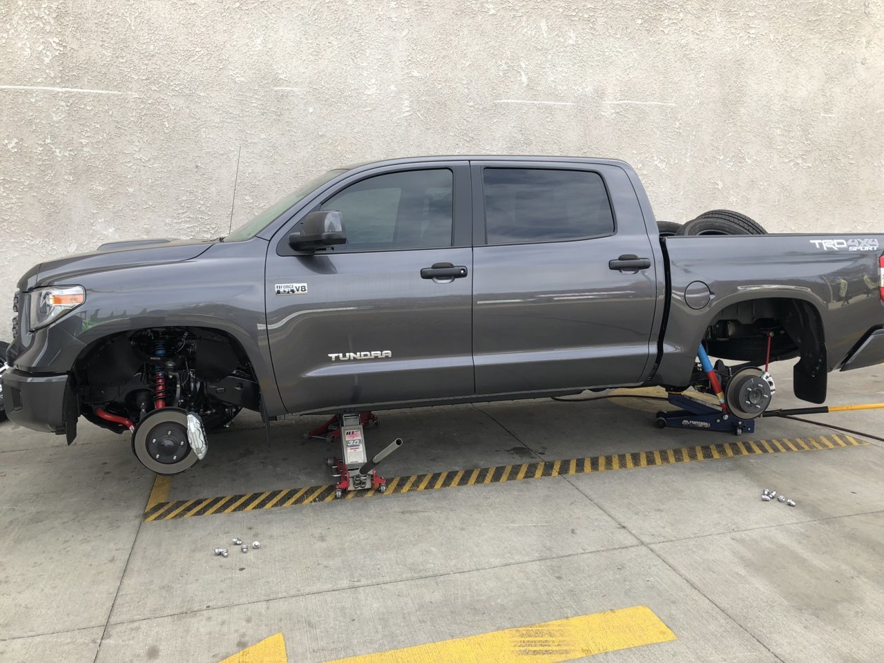

    makes me nervous just looking at it... especially knowing that to change out the shocks... someone, somewhere's going underneath that thing

    Seriously... jacks stands

    Can’t look at that picture again!:goingcrazy:

    after you get jack stands under there i'd like to know as well as i'm thinking of buying them

    Lol! Thanks for the feed back! I was thinking the same thing. I dropped off my truck at the local tire shop and I had BFG’s ko2 installed. I was waiting for the truck to tip over.

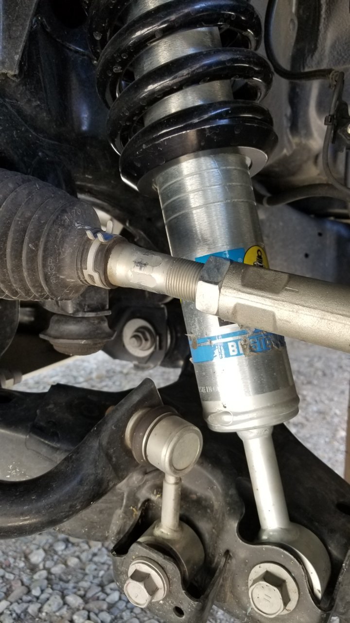

    I just noticed it appears they installed the 6612’s at the second highest position? I’ve seen some on this forum and they show 3 rings when installed at highest Can anyone confirm?

    Edit: I got that backwards! 5100’s have 3 grooves, while 6112’s have 4. Yours ARE set to the 1.9” mark.
    Pretty sure you’re thinking 5100’s with 4 snap ring grooves total (3 exposed on highest position.
    Also pretty sure the 6112’s only have 3 grooves total, so you’re high as *____. :D

    Yes, those are at the 1.9 setting. I just installed mine at top setting 2 weeks ago, I ended up getting a bit over 3" lift on the frnt of my 18 dc 2wd. Have over 1k miles already and still a hair over 3 1/4" up front. Toytec shackles gave me 2" in rear instead of 1 1/2, truck has 1/2" rake.20180722_155911.jpg

    @Nm6300'asl- thanks for the info. Yes, they set them at the second setting 1.9”. I’m giving 4 wheelparts a call tomorrow. That’s what I get for being Lazy and not doing it myself! I have the ko2 at and they are getting noisy.
