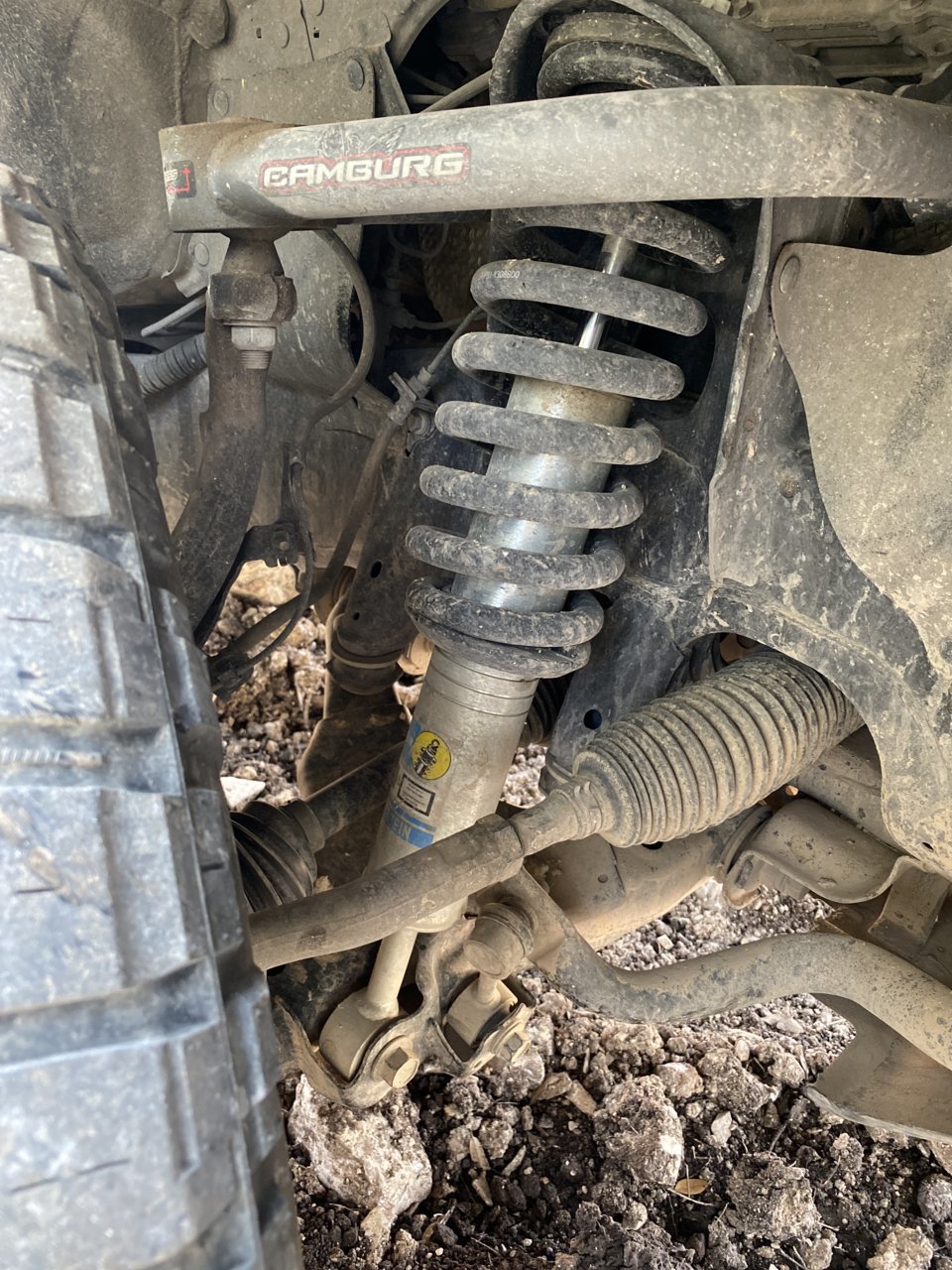

    Hey everyone, I’m heading to have my alignment done (again) and have a question. Firestone refuses to align it any way other than own specs. I’m running the Bilstein 6112’s on the top setting and Camburg 1.5” UCA’s. Tires are wearing horribly on the outside from scrubbing and the wheel will hit a point to which it will not return to center and actually turn in more. I’m going to 4WP to have the alignment done and he told me to bring the specs I want and they will set it up. I can’t find anyone with this setup to get me in the ballpark. Any help?

    Sorry it’s dirty. She’s nowhere close to a pavement princess.

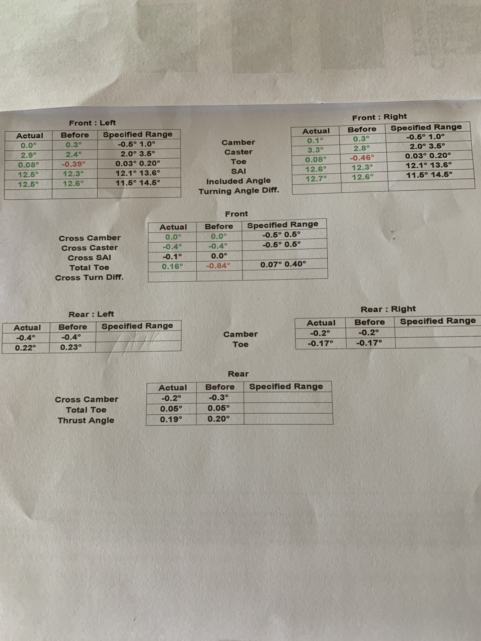

    These were my numbers on my alignment. Drives straight and even tire wear.

    How much lift are you running and did you replace your uca's?

    I have the Toytec Boss 3/1.5 lift with SPC UCA’s. I would think 4WP would know more about alignments on lifted trucks than Firestone.
