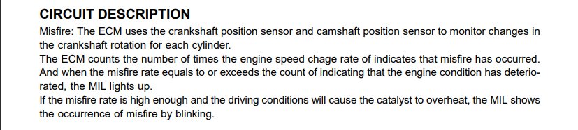

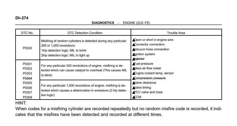

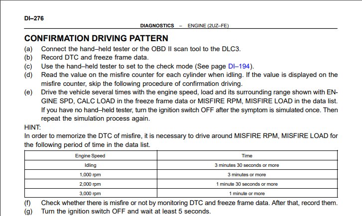

  2. Jun 9, 2025 at 10:01 AM
    The Black Mamba
    Sep 6, 2023
    #103472
    4,539
    Snek
    DFW
    Black 00 SR5 AC 5VZ PreRunner
    Imma keep it stock
  3. Jun 9, 2025 at 10:07 AM

    2005 Crew Cab Tundra TRD
    Thanks! Definitely more items to check out.

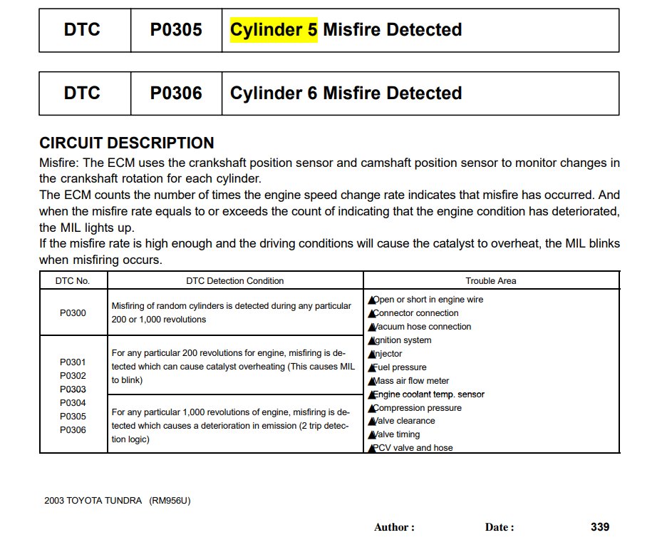

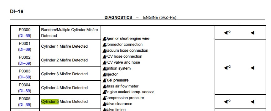

    Check out the "So you wanna buy a 1st gen" sticky at the top of the subforum. It has decades of information as well as links to the Field Service Manual, Wiring Diagrams and other useful, helpful stuff.

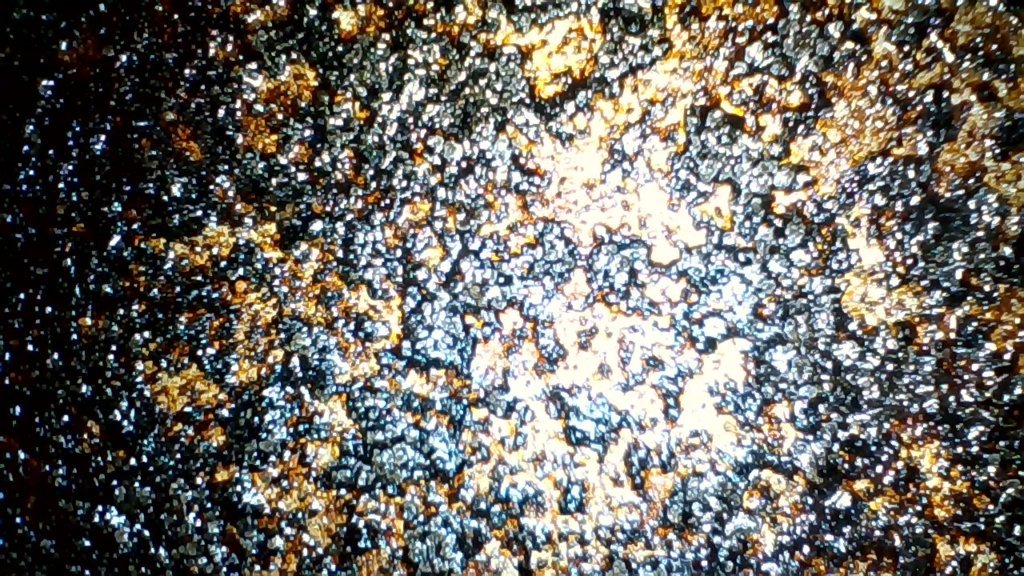

    I ran a bore scope down #5 but was only able to capture pictures of the head of the piston. My camera is made for small bores so I could not get it to focus on the cylinder walls or head. Here is a picture of the head of the piston. There is more buildup than I expected.

    Yikes

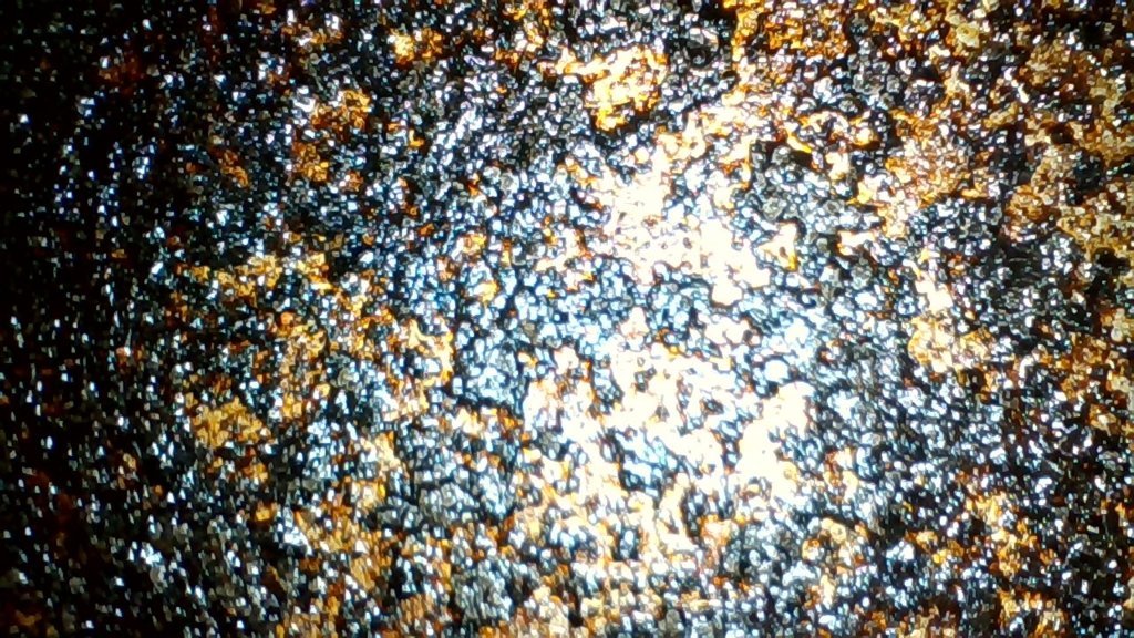

    Here is a quick update. I went ahead and pulled a couple of other plugs and ran the borescope down to view the tops of the other pistons. All the cylinders look like #5 (basically what a peperoni pizza looks like when my wife finally takes it out of the oven).

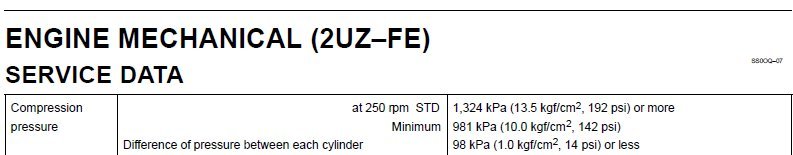

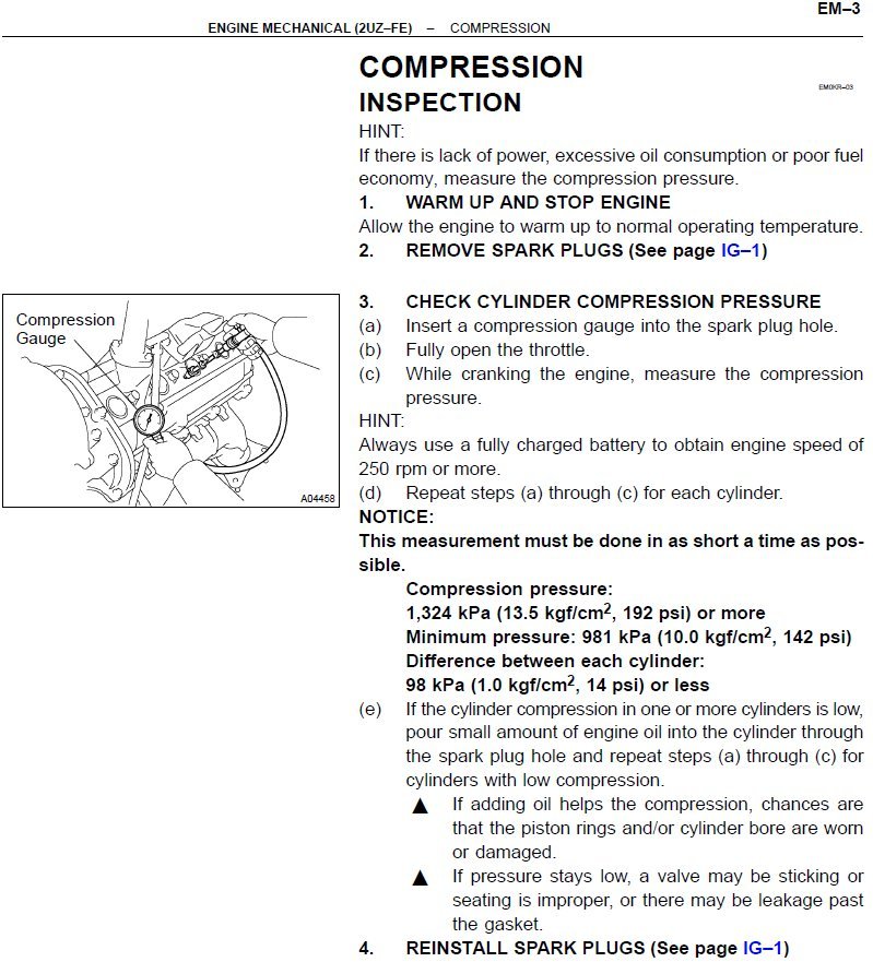

    I ran a compression test on #5 and the result was consistent at 125 lbs after several tests. Any idea if this is acceptable on an engine with 350k+ miles?
    I have a leakdown test set on order.
    shifty` likes this.

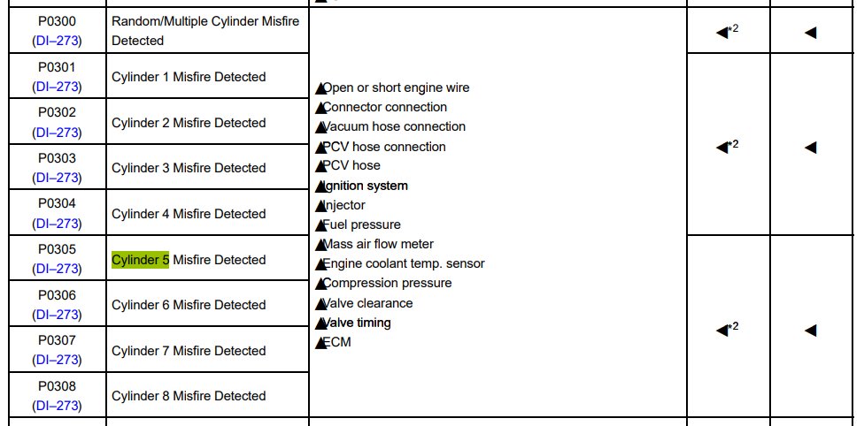

    My kind of pizza....well done !
    From 2005 FSM....

    I'd like to see slightly higher numbers than that on mine, but given the age and not knowing how everything was staged for the test, 125 is not horrible, and may speak to buildup (which we clearly see on the pistons) more than anything.
