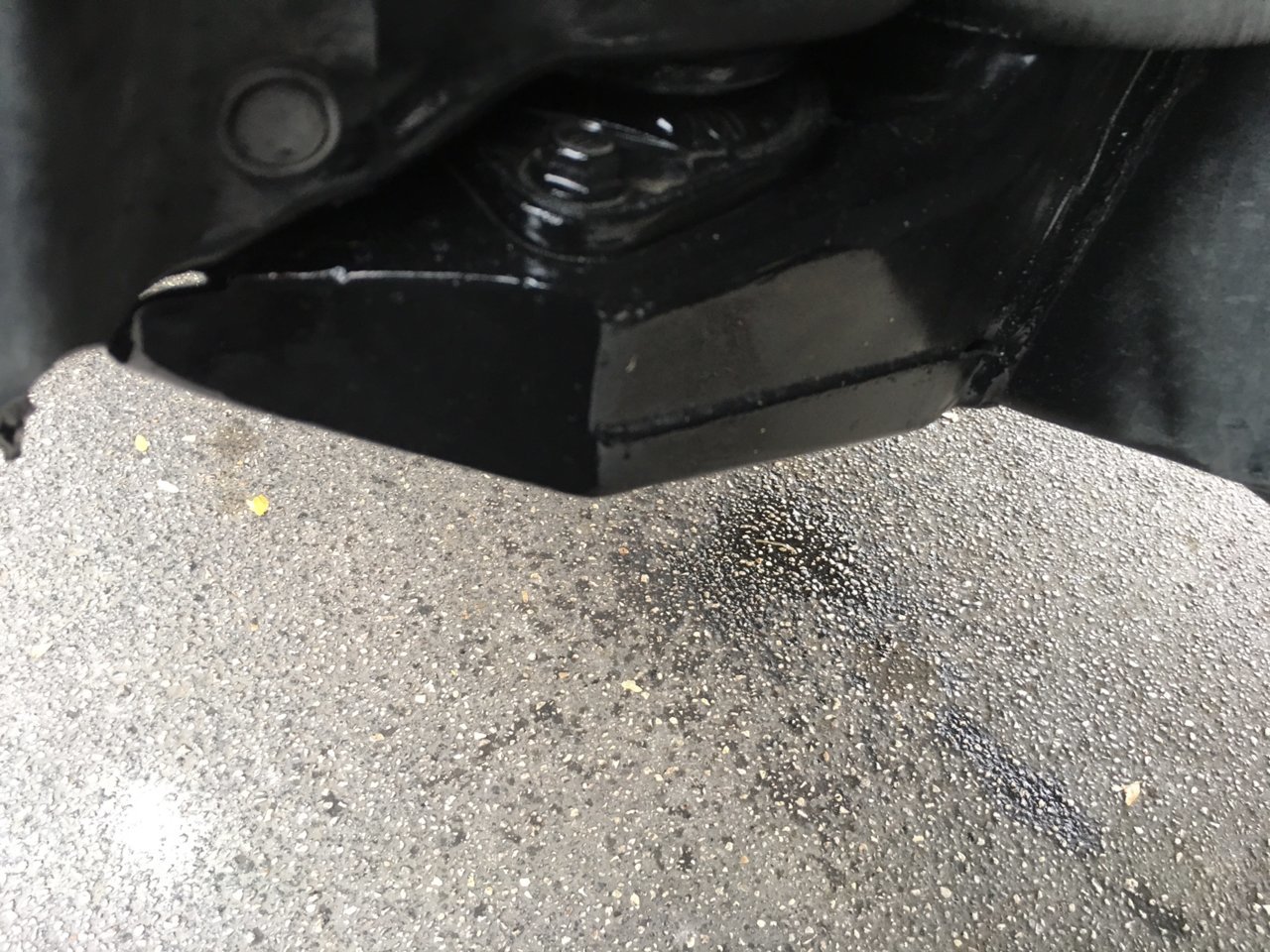

    I had 37s with a 7” BDS lift kit on my previous Tundra. You will likely have to trim the body mounts and have them re-welded and painted. It will definitely rub if you don’t. They’re pre made steel plates ready to weld on for this application.
    https://www.google.com/amp/s/socalsupertrucks.com/amp/body-mount-plate-kit-07-20-toyota-tundra/
    https://www.relentlessfabrication.com/products/07-tundra-cab-mount-chop-plates
    This was on my previous Tundra running 37sx13.5 and a -44 offset

    I also had to do bmc. Welded Relentless Fab plate over it. It’s well made & has a bend in it (not completely straight) which fits the mount better than others.
    I shimmed my bumper ~1”, which allowed me to only have to trim plastic on the bumper ends - didn’t have to cut into metal. I have zero rub at full turn, forward and reverse.

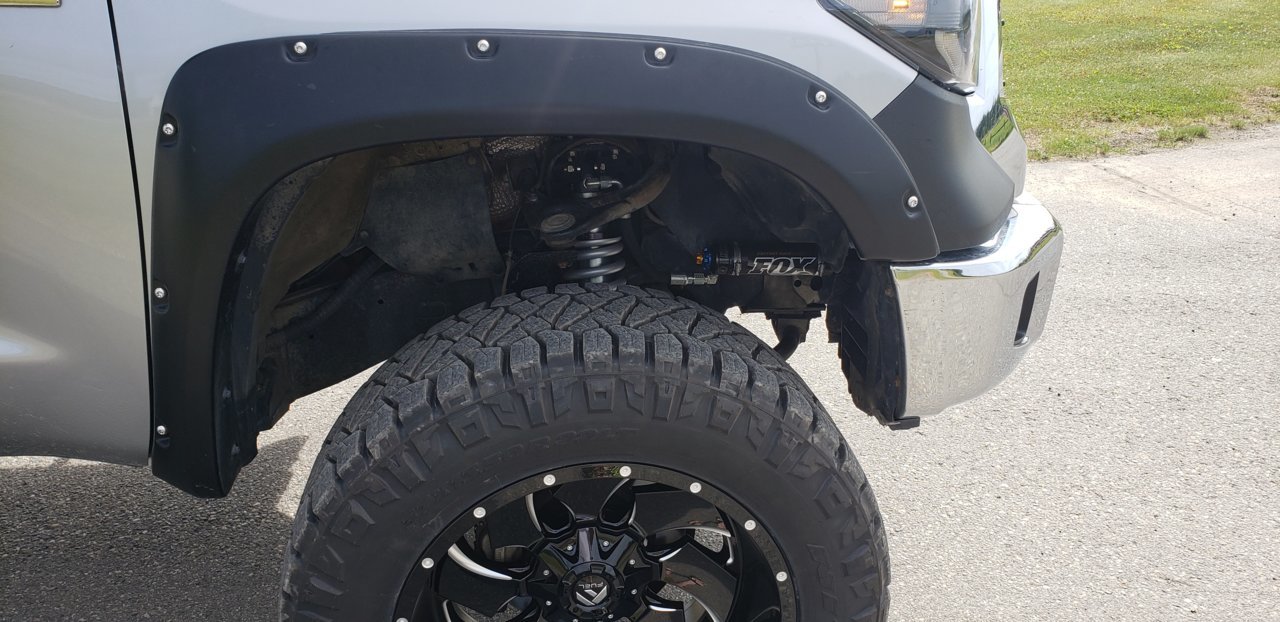

    Well... I finally got my lift on. I ended up doing COACHBUILDER coil-over shims, along with they're bumper shims (2 bumper shim sets, for a total of 1"). I will still need to remove some of the plastic behind the bumper and cut a minor portion out of the actual bumper, but my an worked out quite well. Only rubs at a full turn.
