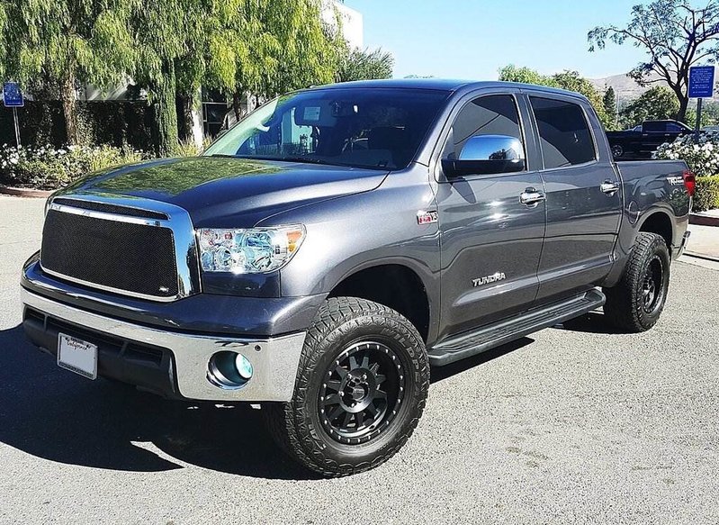

    Hey guys,
    I know there is a ton of "Will 35s fit!" Threads but I typically only see people running 3/1 kits asking. I am asking because I am only running a 3" lift in the front. My rear is stock height. From what I can see a 35 will fit no problem on a stock rear and lift front but figured rather than screwing around with a tire shop I will ask everyone here.
    Just for anyone curious I run 18x9 Method Double Standards and I am jumping up from 305x65x18 Falken Wildpeaks to 35x12.50x18 either KO2s or Ridge Grapplers. Still in a toss up. Leary of the KO2 cause from what I have seen from friends BFG wear extremely fast.

    How do those 305/65/18 wildpeaks fit and how do you like them? Did you have to do anything to make them fit with not rubbing?
    You have more pics? Side profile shot maybe?
    I'm about to get those tires.

    Perfect! Thanks for the info. I figure I may rub the skid in the front but I will cut that. I hear thats typically the only issue rubbing wise with 3" in the front.
    They never rubbed and I actually really enjoyed them and I got about 45000 miles out of them which is the best Ive ever gotten out of tires. They are completely worn down but the way they are design they dont have much traction left in them. I will see what photos I have I can send you.

    Really?! Ive heard most guys with 3" lifts clear the cab mount with 35s. Most have said its the skid plate that gets in the way.

    for street driving you'll probably be ok but full turn and full compression you'll probably rub. Depends if you off road a lot or not.

    Well went to the tire shop 35" ko2 rubbed the cab mount (as some of you warned). So bit the bullet chopped the cab and here you go! Super pumped with the outcome !

    it looks sweet man! next set of rubber for me will likely be a couple of steps up from the 285/55/20's i'm currently running. did you look into a hypertech to get those shift points back in line?

    I havent yet but well be definitely looking into something to help with that. As of now it actually feels pretty good given I am pushing 35's

    All I am running is a 3" spacer up front. Everything else on my truck suspension wise is stock.

    Looks great! 35's are meant to be on these big trucks! Do you remember what offset your methods are?

    Method double standard are +25 i think

    TheBeast is right I believe they are +25.
