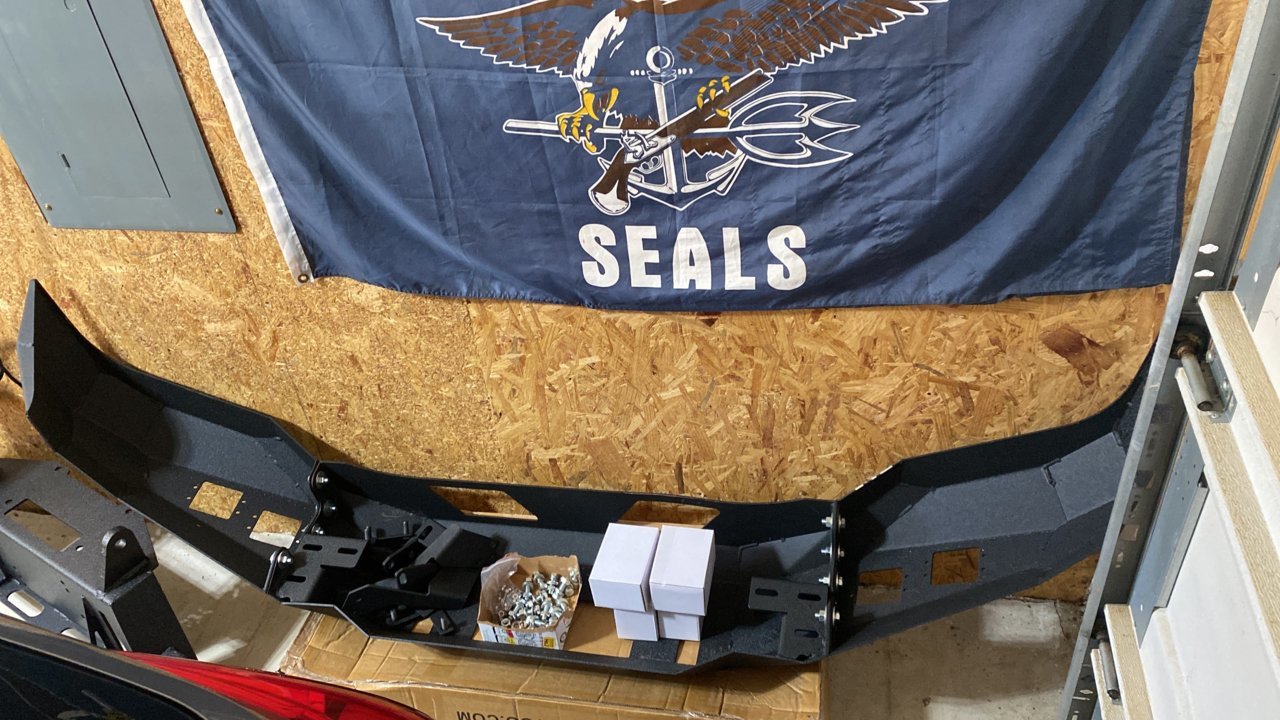

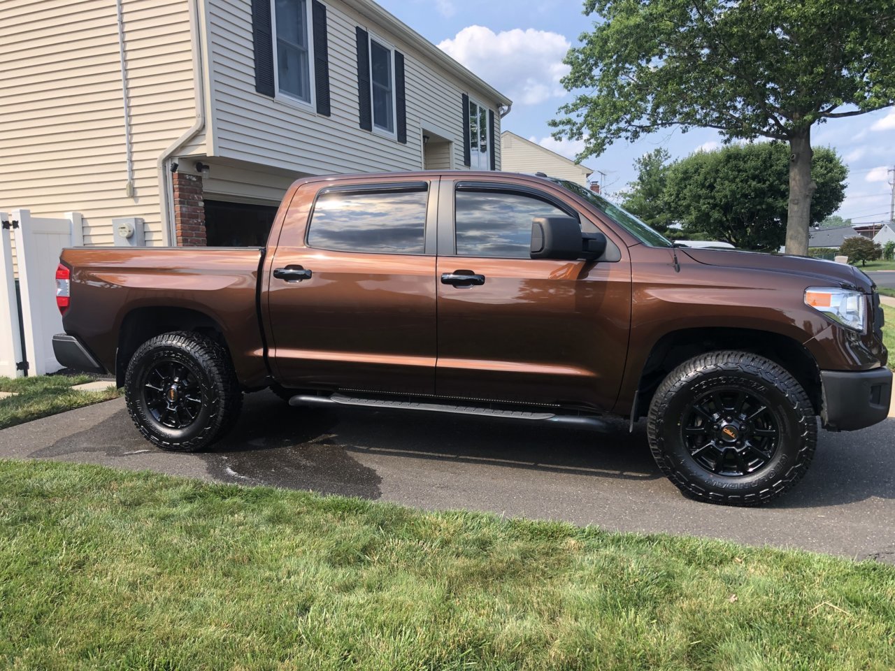

    I’ll have my Eibach 3” lift installed, as well as a high clearance front bumper, and adding a 1.25” hub centric spacer… what did you have to do to make it work?D9996870-6402-4952-BFC0-083279380799.jpg 6769F97B-25B3-4BE0-A0A8-1931D6AA5D8A.jpg

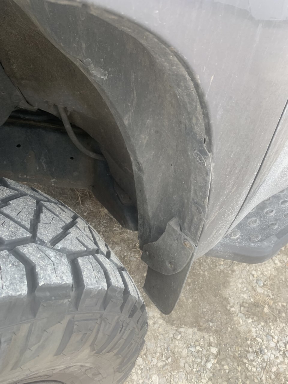

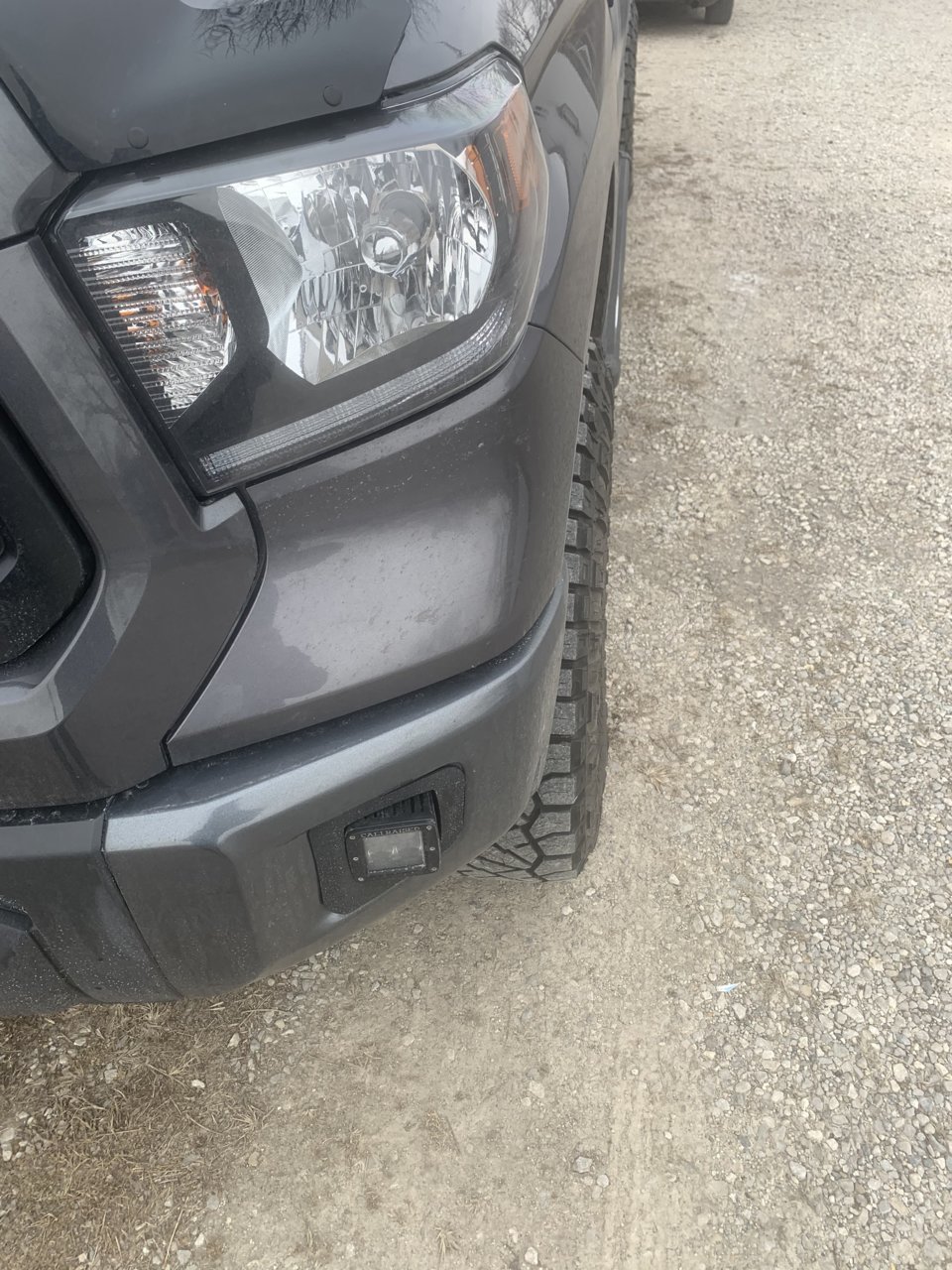

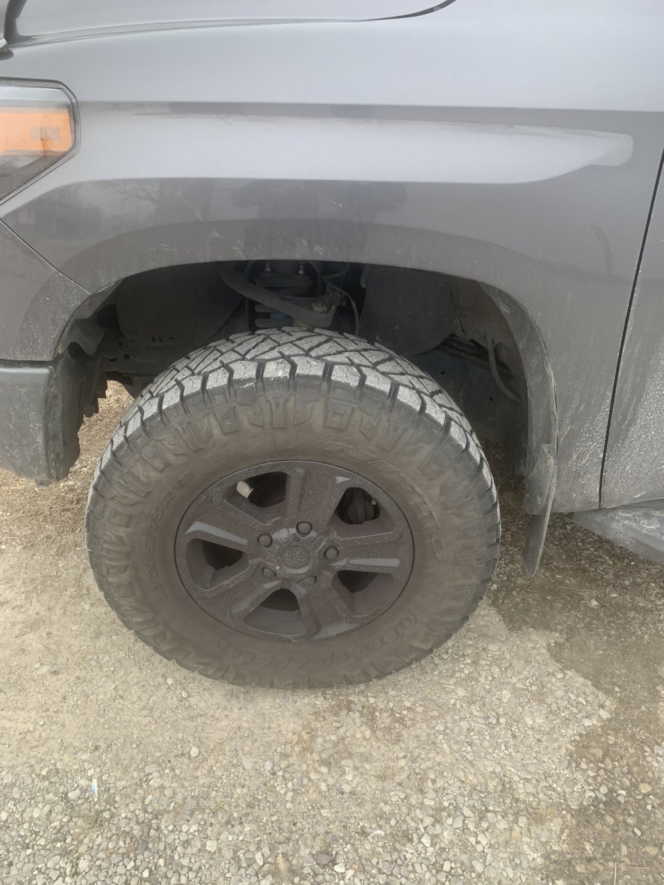

    2022 GMC Sierra 1500 Duramax 4x4 with a bench!!!!
    Rear
    Rear
    Rear mud flap front wheel well
    Front of front wheel well

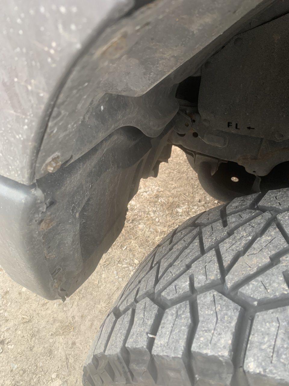

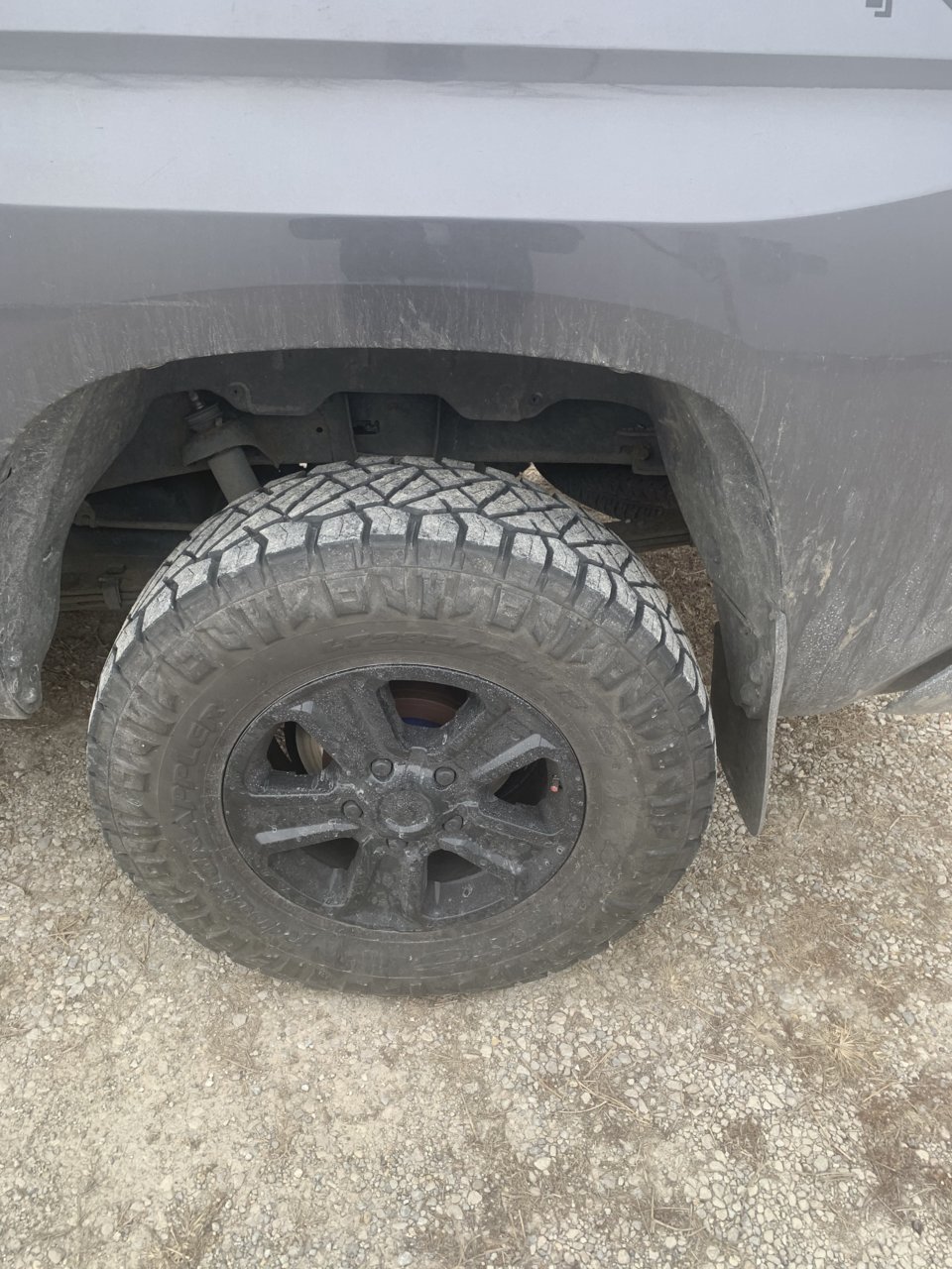

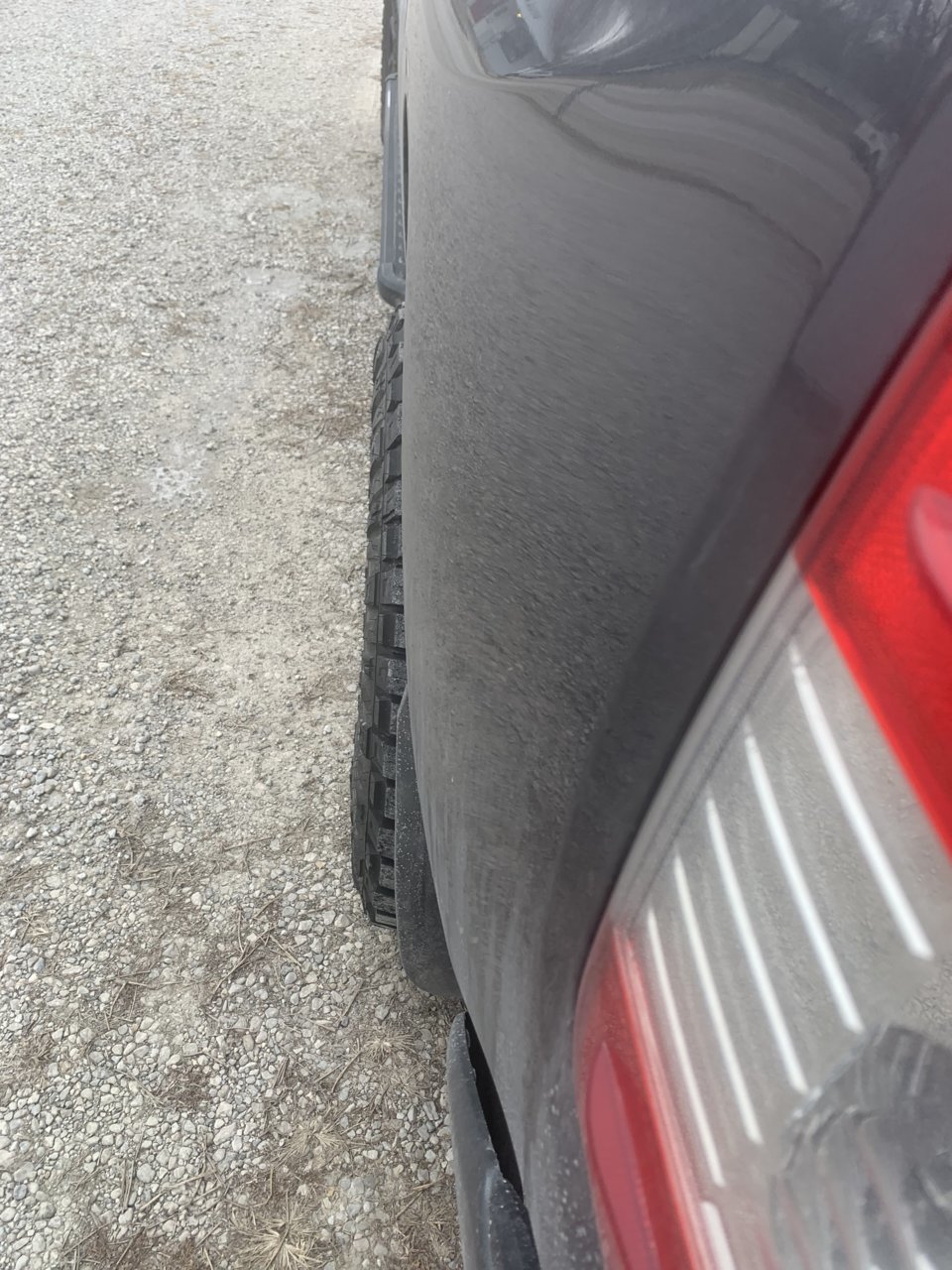

    97894B52-F5DB-4BA9-B821-228C97922C9A.jpg 14EFA823-9DD0-4870-A044-B1895C10A0FE.jpg I have stock SR5 wheels with 1.25” spacers running a RC 3/1 lift level kit and SPC UCAs. The tires I’m running are the 285/75R18 Ridge Grappler. Trimmed rear mud flap on front wheel well and removed front mud flap from wheel well…… no rubbing…. I know it’s not a 20” but….. here is actual measurements… 35.08” diameter and 11.26” width…. Some pics attached for reference
