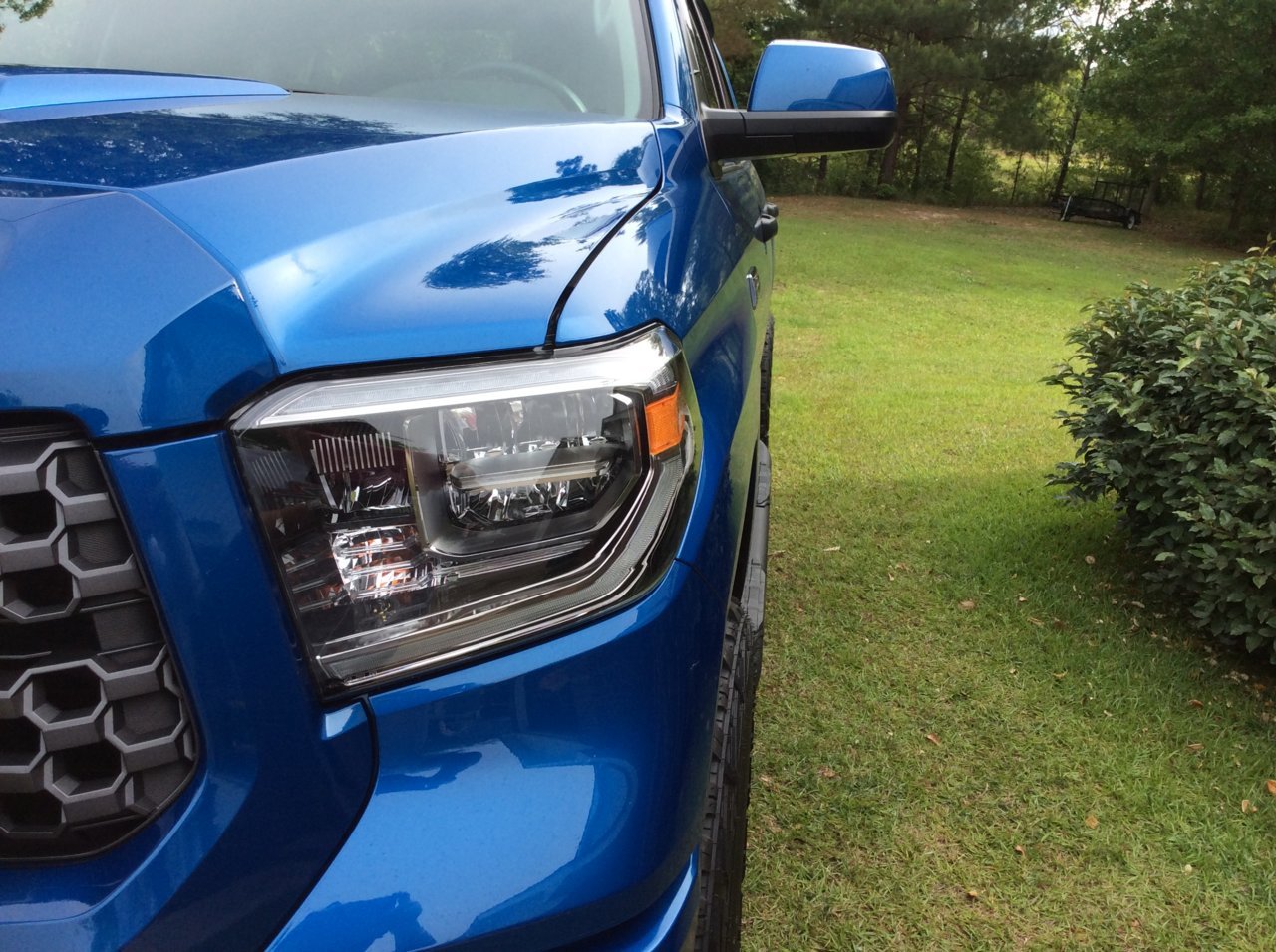

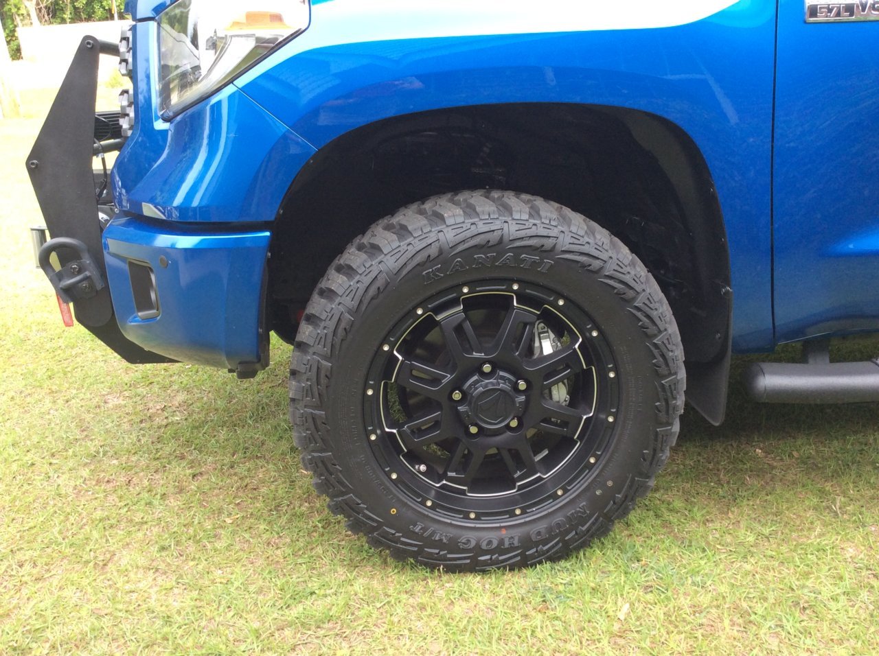

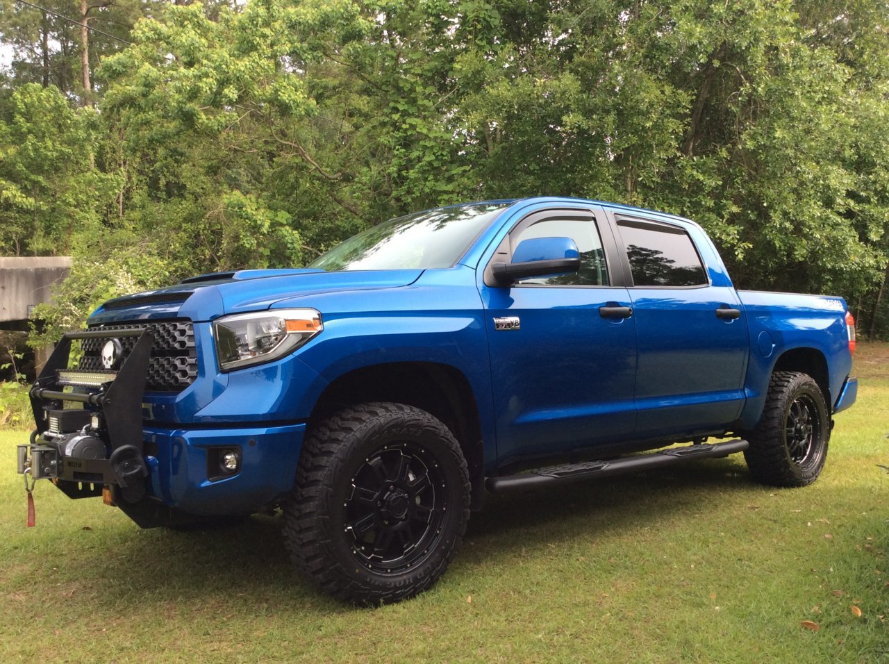

    This is an ‘18 TRD Sport I once owned. These are pics with it having 295/60r18(33.9x11.6) Kanati Mud Hogs installed with Bilsteins set on top setting(2.28” lift) in the front. All I had to do was bend the skid plate a little. Hope this helps. FCBD7CAF-42FF-4AE6-B298-6E964FAADFD5.jpg2591F2BB-F3C0-4270-A99E-7D6E6ACAB34B.jpg FAA89696-4C9F-4BC8-BA51-CA5CF1653362.jpg
