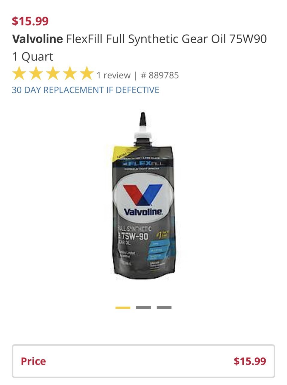

    I used this and no issues. 2004 DC 2WD with LSD. I will say it doesn’t seem to hook up very well.

  17. Feb 27, 2022 at 9:29 PM
    NickB_01TRD
    Jun 16, 2021
    #64346
    2,752
    Nick
    KY
    01 Tundra V8 4X4 AC SR5 TRD
    I run this too but I know I've heard running full sythetic doesn't really do anything but I didn't realize it may make the LSD perform worse. Maybe I should switch to conventional just for the rear diff.
    I did a burnout before I got new tires and wheels and I know both wheels spun. That's the only indication of my LSD working that I have although I've never found the "LSD Additive required" sticker either.
    Darkness and Konniekay91[OP] like this.
