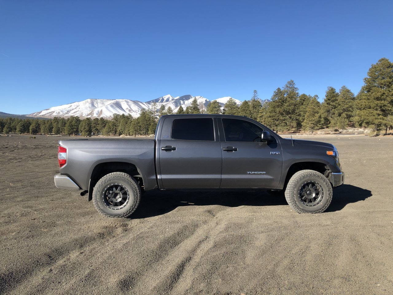

    You’ll want a lift... I run that size and the exact same tires with 2.5” up front and 1.5” in the rear.
    53C80D3C-AE3B-4D39-95E3-4B289646E740.jpg 36280BB0-F67D-4039-818D-A8DE1E00A74B.jpg
