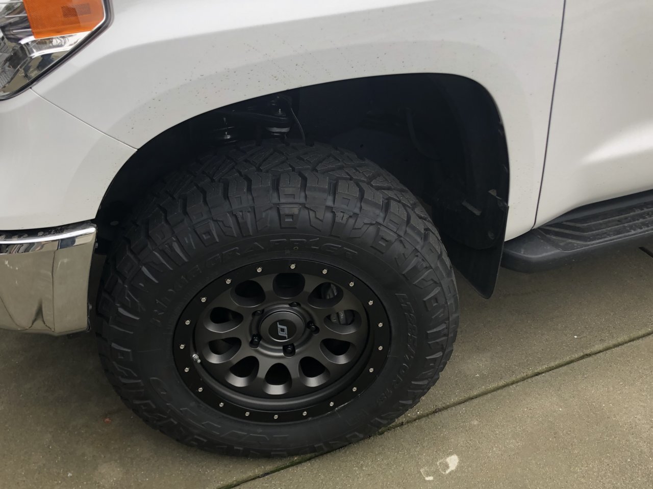

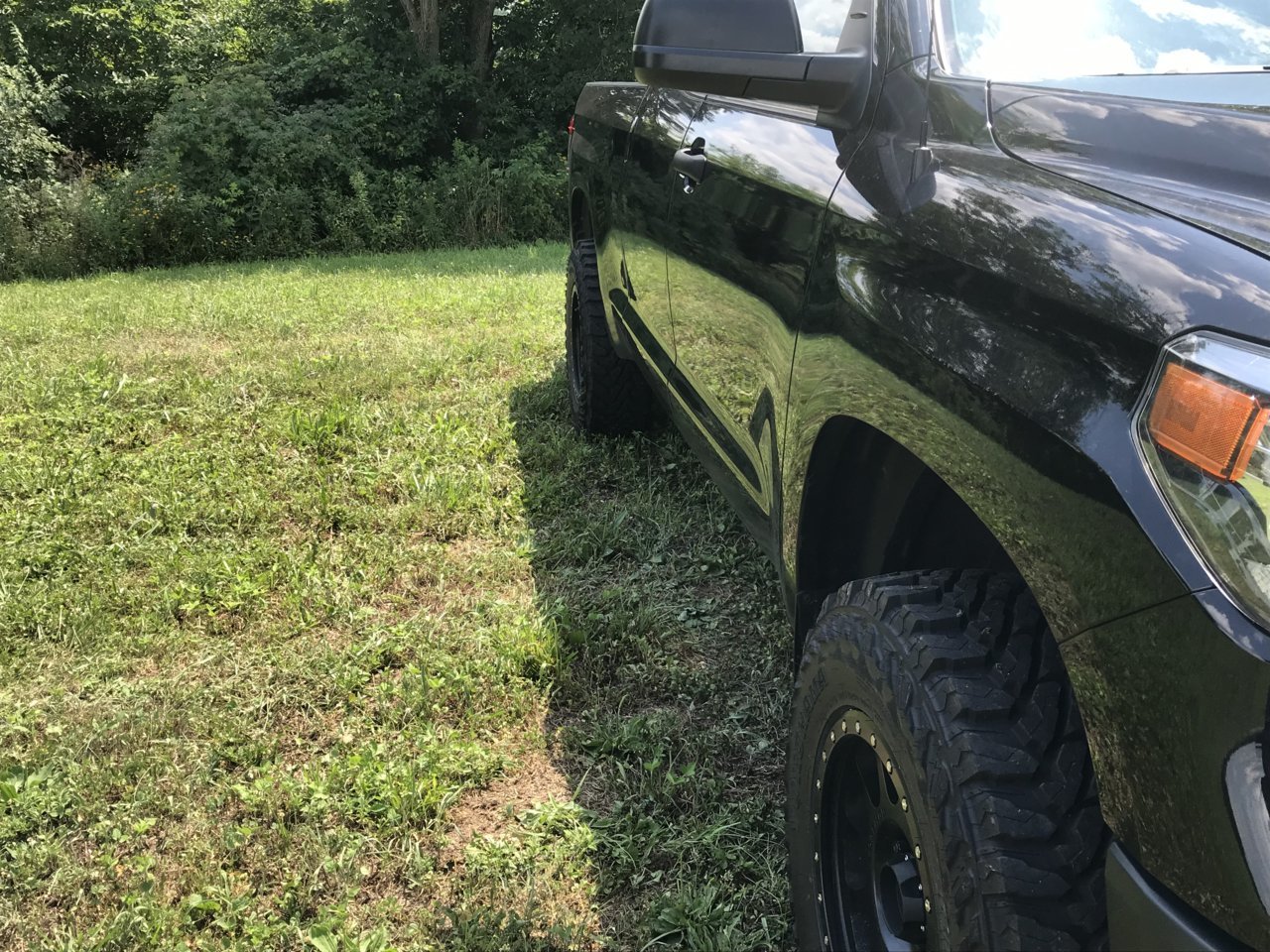

    I'd run either 275/70/18 or 295/70/18. You'll have A LOT more choices at those two sizes than the 285 width.
    Here are pics with 275/70/18's (33.2") on Method NV's (+25 offset) and Ridge Grapplers. I'm running Bilstein 5100's @ top setting (2.2") and have ZERO rubbing on anything (still have mud flaps, didn't have to bend plastic, nothing). Going another 10mm wider and 33.7" tall might rub some (barely if any), but not as much as a 295/70/18 which is still minor (it's workable).

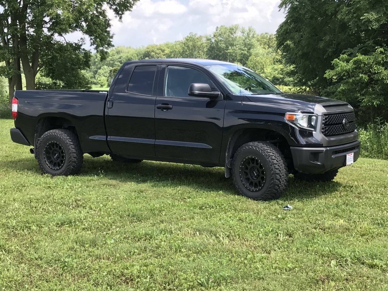

    BF550874-C0B7-4FAA-BFEC-8FD263E67814.jpg 3FB77FA6-4BDB-4D8B-8318-089F3F8E9F05.jpg I’m running 285/70/18 Yoko’s (33.9s) with Methods +25 offset. I have 6112’s set at 1.9 on front and 5100’s on rear no lift the rear sets 1/4 “ higher. I had to remove the little flap on the front of wheel, trim front mud flaps I still have a slight rub on the front of the liner but nothing really to worry about I’ll probably add the coach builder bumper shims later or use the heat gun. Hope this helps.

    Thanks! I appreciate the info. I can deal with "plastic" rubs and trimming, I just don't want any rubs on frame or body. Thanks for pics as well!

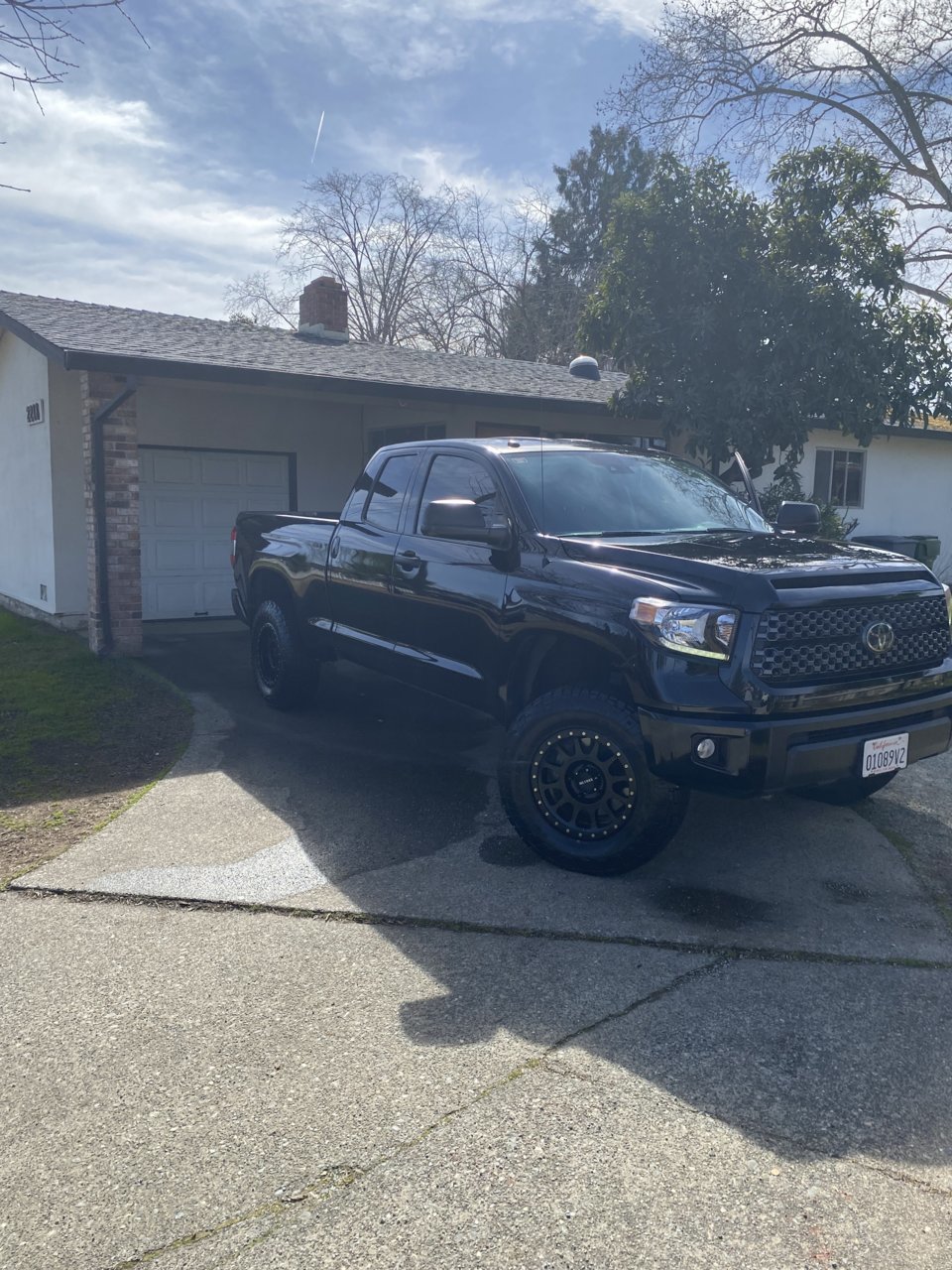

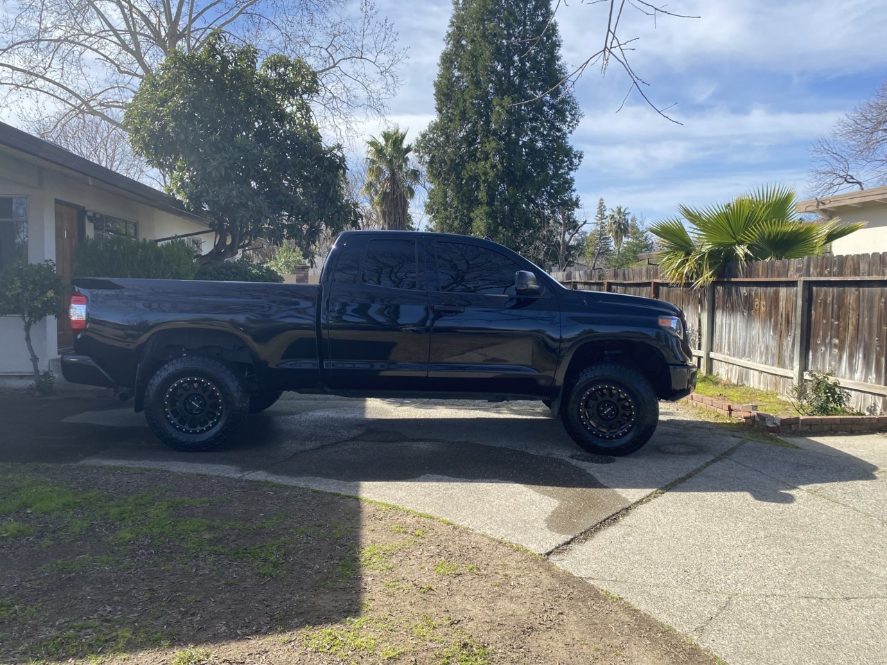

    2019 tundra 3.5” maxtrac spindle with 2” block rear with fox’s in rear with
    285/70/18 Toto’s 33.7”

    You wont have any issues with +25 offset and 285s....

    Yep that’s what I’m running +25 offset with 285
