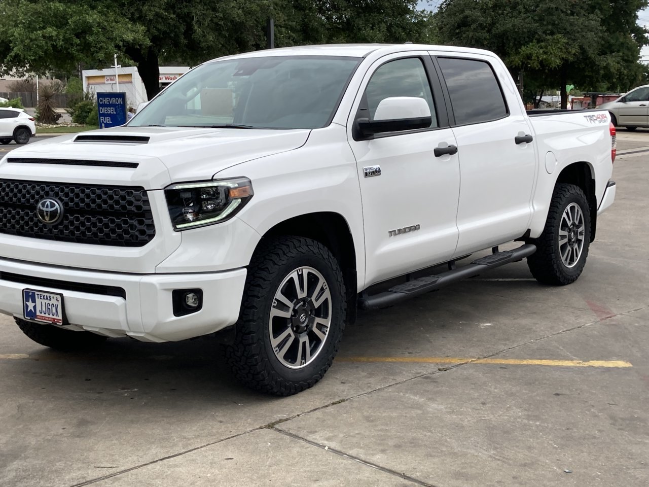

    131DEF91-32F2-46E5-A543-329455105E9A.jpg 5122DE69-9E3F-4081-A1B6-BDC98B580118.jpg 273CCB8A-50D3-47DE-B973-404AA9FA4132.jpg 872DAAF5-6543-495F-81DB-83CB7CFCC4BA.jpg
    Well. I got a pleasant surprise today. After plenty of forum research I went to Discount Tire to try on Ko2s in 275/65r20 on my ‘21 TRD Sport OEM rims and suspension. Of course, the computer said no. Even the 275/60r20s were no.
    Several staff huddled around and looked at my truck. They all agreed that the 60s would fit and the 65s would rub. I told them to try on the 65s anyway because I was prepared to remove the front mud flaps and bend the plastic skid plates forward a little per “the forum”, hehe.
    20 minutes later several guys approached me grinning and said the 65s fit no problem. Weighted truck, full turns, no touch. Sold.
    Thanks to those that have gone before me. Good info sharing. Appreciate it.

  28. May 17, 2021 at 9:24 AM
    #28
    PVTundra
    PVTundra New Member
    Aug 27, 2020
    #51415
    10
    Wow, that's surprising but really good to know. So even at full steering lock in forward/reverse there is no rubbing? If not, I think I'll go with that size after all. I'll be going with a less aggressive AT though and my tire shop should have no issue at least doing a test fit.
  29. May 17, 2021 at 9:32 AM
    #29
    MF702
    MF702 New Member
    May 7, 2021
    #62762
    5
    2021 White TRD Sport
    Yeah. I was expecting a bit of struggle to get the 65s in there. No issues. TRD Sport suspension might sit slightly different than other trim packages. Could be a factor. Go for a trial fit at your shop and let us know.
    Also....two weeks ago when I got my Tundra I was headed for “less aggressive” too. After I began really focusing on the options and what others have had success with, the Ko2s began seeming less and less aggressive to me. I’m really happy with this choice now and feel like it’s middle of the road. My wife, on the other hand, sees a lifted truck with huge mud tires. Haha.
    BigMike22 and Jpd0144 like this.
