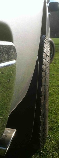

    I wouldn't call 1" or 1 & 1/2" as slightly past the fender, haha. If that's what you want, for the most typical wheel width (9 inch), I would recommend 18 mm offset. I am assuming that you have the stock tires (275/65/18). I have 18x9, 18 mm offset wheels and stock tires (275/65/18) in these pictures. You could see how far they stick out. The left side tend not to stick out as far. These are the only two pictures I have before getting Bushwacker fender flares.
    Be aware though. With that much tires out of the wheel well, you are likely to suffer dings on the side of your truck. Personally I went with 18 mm offset in order to match the Bushwacker fender flares I really wanted.
