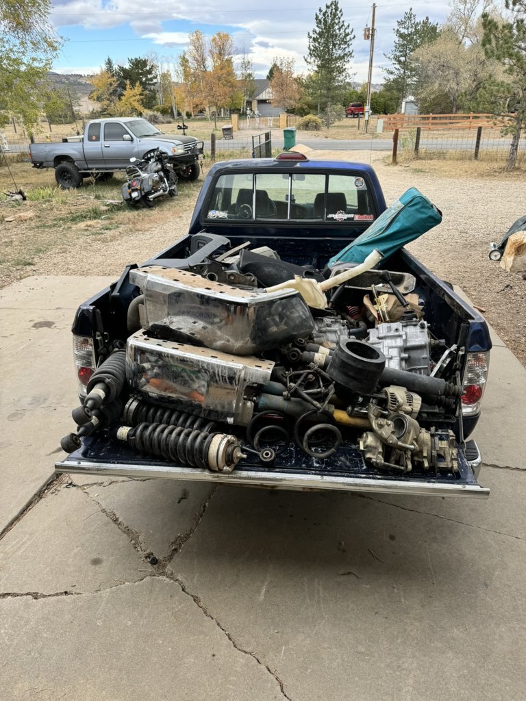

    Like I said, the truck has come along way since then. At this point, he's at 211k. And I say "he" as all my vehicles have been named, and as the title says, this is Mighty Mouse 2.0. The OG Mighty Mouse was my first Toyota, a '90 regular cab short bed 3.0 pickup. Unfortunately, I totaled it while in college in Farmington, New Mexico, so the only remnants of it are in memory, and this trailer, which still needs finishing 16 years later :frusty:
    Damn good little truck, and I killed it way too early. But, we move on. So, here is the truck, as it sits now.

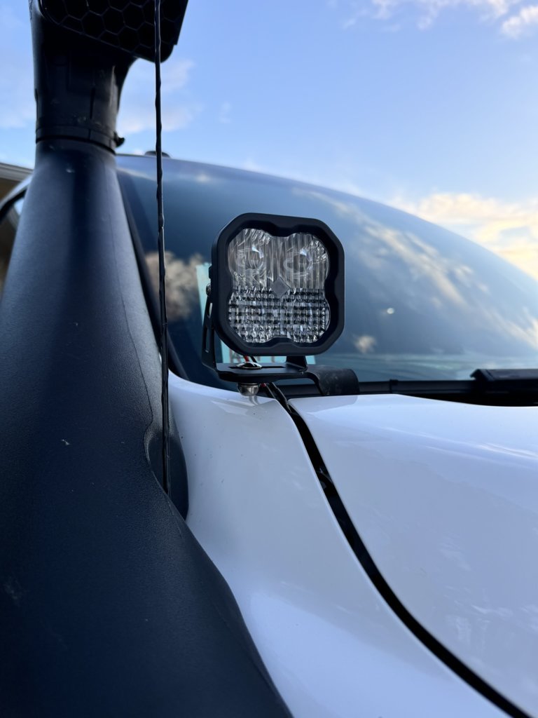

    • Diode Dynamics Stealth 40" light bar with dual beam lens in bumper with Hotshot Offroad brackets
    • CBI offroad ditch light brackets with Baja Designs Squadron II's, split beam lenses-*Baja Designs removed*- Diode Dynamics SS3 Max combo beams

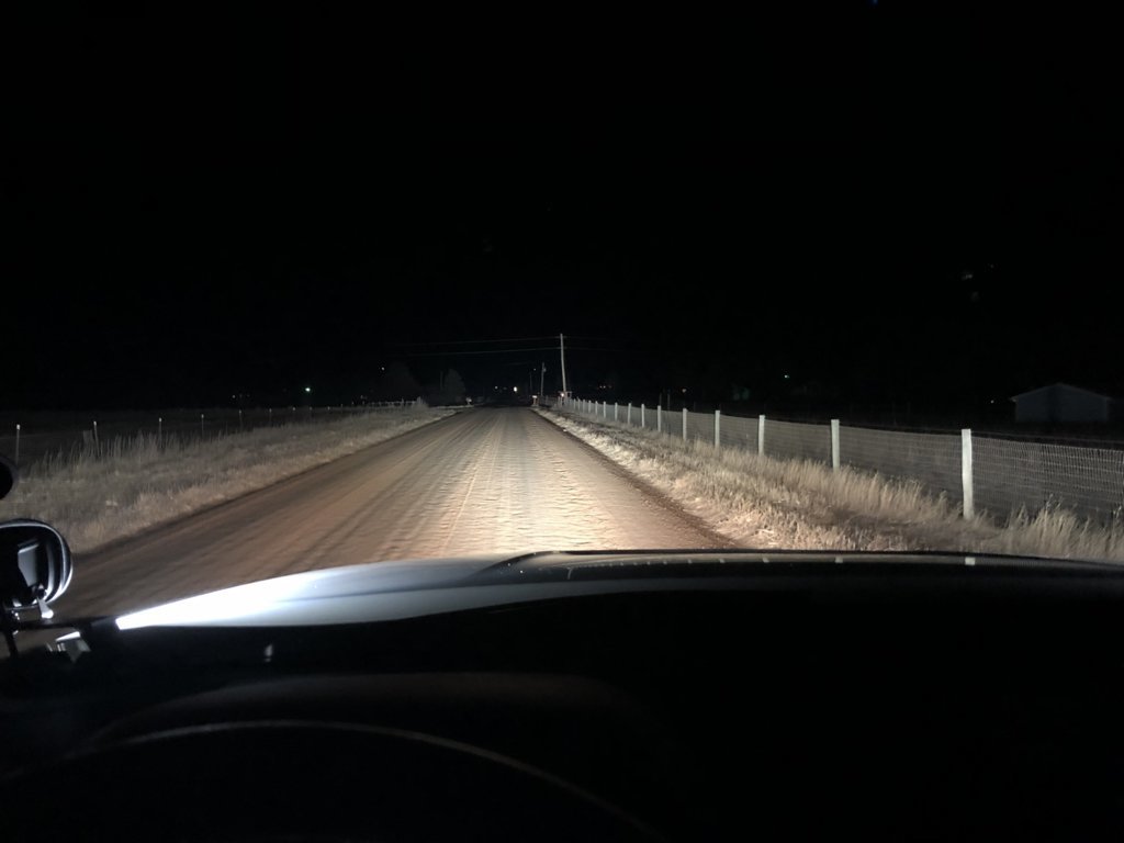

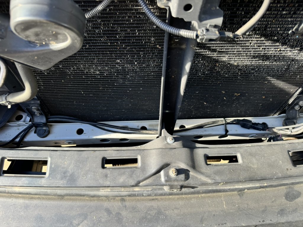

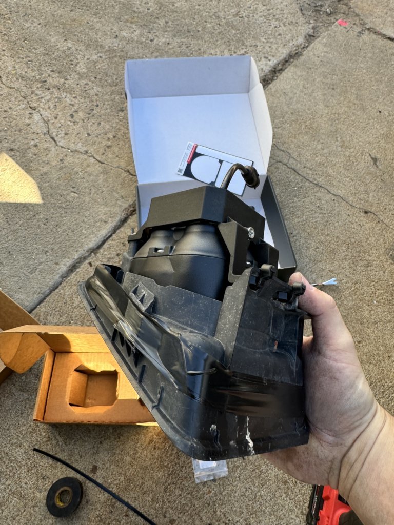

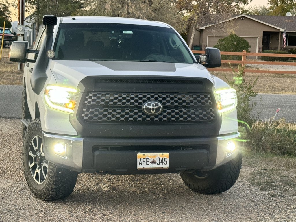

    Had a slow day at work so I decided to bring some tools in and install my new Diode Dynamics SS3 Pro fog lights. The OEM LED’s just weren’t doing it for me.
    In addition, I’ve been meaning to pull the fog light brackets to tackle the the standard “fog light bounce” that the crappy mounting pockets always induce. Once I got the pockets out I found that the passenger pocket is broken, so I’ve got to see if I can score a new set. In the mean time my temporary fix of wrapping with electrical tape and some creative zip thing seems to have worked. I might just leave it until I get a bumper. We’ll see.
    A night drive is in the books to wash the truck, so we’ll see how much better these are.

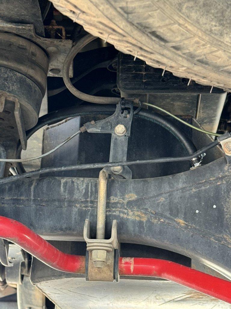

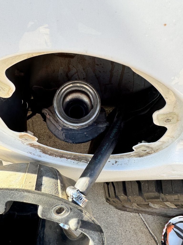

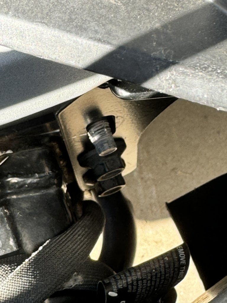

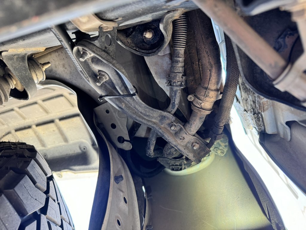

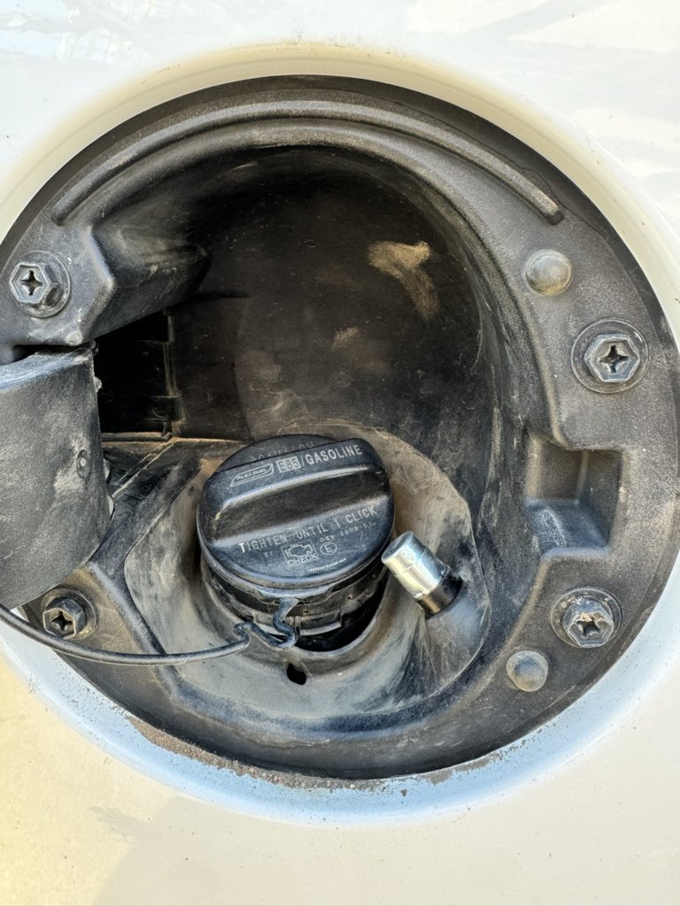

    Another slow day at work means another little project knocked out in some free time. One thing I've done to every Toyota I've ever owned is extend the rear breather, and the front if it is an older one, as they didn't start putting the breathers up high until the Tacoma came out in the mid-90's. I've had the stock breather burn me pretty good, so it's just become a "Must do". I'm surprised I waited this long on my Tundra. Most of the time I just build my own kit but I picked up a Toytec breather kit. It made the install pretty quick and easy.
    I simply started at the axle, removing the stock breather. I installed the plug, then put the hose on and started feeding it up. I zip tied the line all the way up, starting from the ABS harness mount.
    I then followed the parking brake cable, up to the front of the drivers side leaf spring.
    From the parking brake cable, I ran the line up following the filler neck and other assorted hoses.

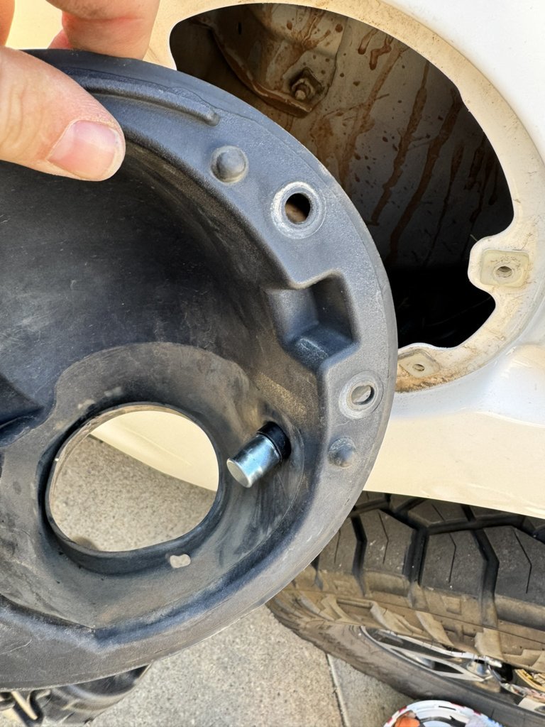

    From there, I pulled the filler and door assembly, and drilled a hole on the rear side. I only went large enough to fit the stem of the breather through. One thing I did not like about this, is that the filler door assembly is rubber around the filler, unlike my previous trucks which were metal or plastic. I could have mounted the breather higher on the filler door, but I've always been told to keep the breather vertical for proper operation, which would not have been possible higher up.
    Because of keeping the breather vertical, I put some tension on the hose where I zip tied it to a bed support, to pull down on the breather and bring it to 45 degrees off of vertical, which should work nicely. I always mount the breather in the gas door so that whenever I fill the truck I can jiggle to breather cap. On the stock breather the cap tends to stick and eventually seize to the breather, preventing it from doing its job. All in all, not a terrible job to do, install was about 15 minutes.

    Killer job, I have to redo mine with some longer hose. When I did it I didn't leave enough slack then the breather pulled down when I fully flexed the truck out :anonymous:

    Yea I tried to leave as much slack as I could, plus I tried to follow an existing lateral line to hopefully prevent pulling too hard on it.

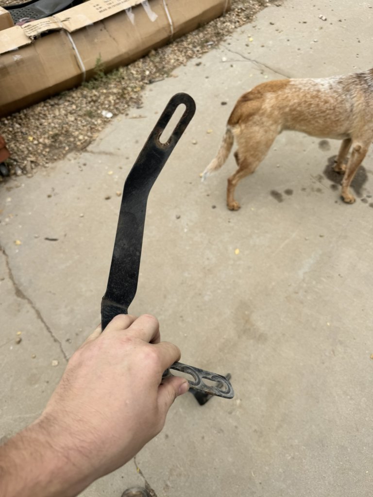

    Finally got around to installing my Hotshot Offroad light bar brackets on my Diode Dynamics 42" bar. As many of you know, the DD brackets that come with the bar are thin, bouncy and frankly, junk. I was really disappointed in the brackets from the get go, but didn't have much other option at the time. The new brackets are awesome. Eliminated the bounce, holds the light steady and true.

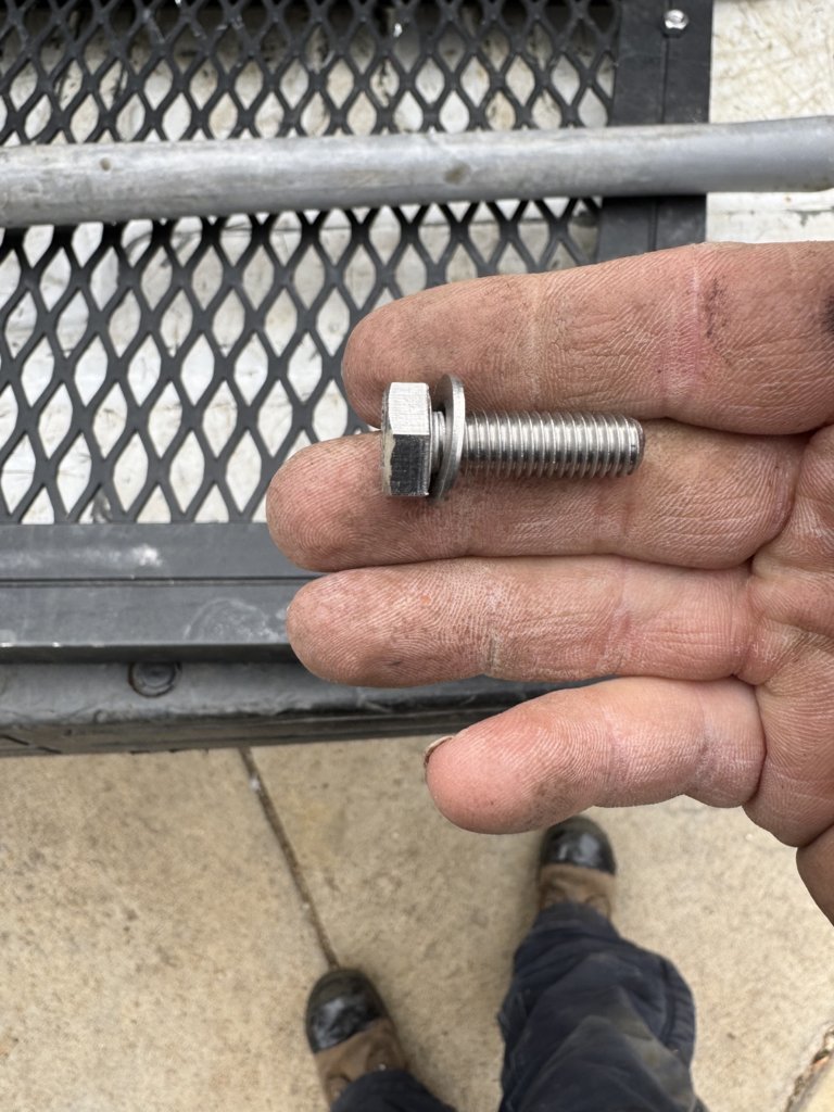

    The install went great, aside from my oversight. I of course didn't think that the new brackets would be considerably thicker. The original DD brackets are 1/8" steel, while these new brackets being about 1/4". Because of that, the bumper nuts, already nearing the end of their threading, are at their max. Unfortunately, it was too much for the top nut and stud on the drivers side, which gave up immediately. 5/6 will have to do until I can figure something out. This may be temporary anyway, if I can get a bumper.
    Regardless, I'm thrilled to have the light bar back on the truck, considering the bulk of my drives back and forth to work are at night through deer and elk infested areas. The faster you see them, the better for everyone involved.

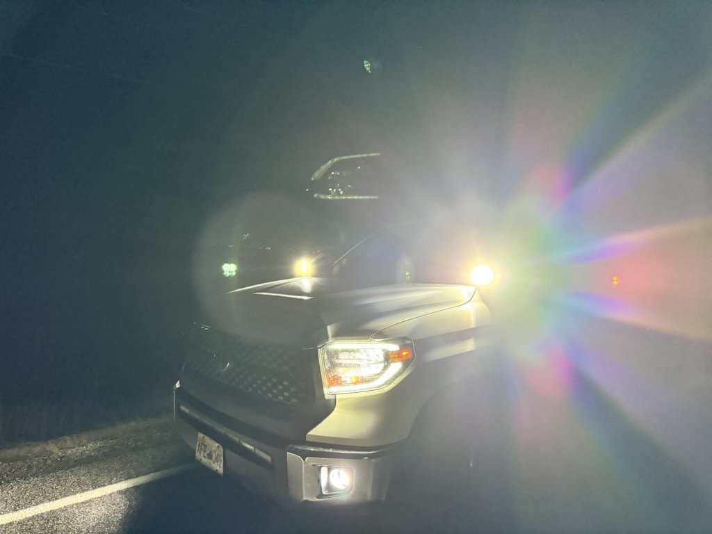

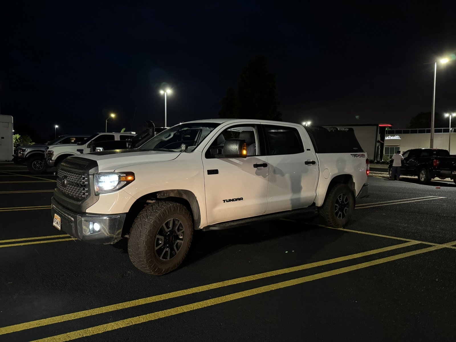

    Yesterday I had some free time with the family out of the house at school, work, and daycare. The truck got its oil change, he's now at 216k, but the twinge of motivation got me going on finally installing the new Diode Dynamics SS3 MAX ditch lights I bought over a month ago. I bought them to replace the Baja Designs Squadron Sport 2's that I've had for years. I wasn't initially happy with the output or beam pattern, and it just kept bothering me. When I upgraded the fog lights to the SS3's, I knew I had to make the jump.
    The install was very simple, and one added benefit of the SS3's brackets is that I can slide the mount to clear things, which helped with clearing the snorkel on the passenger side. When opening the hood with the Baja's, they made contact with the snorkel and wouldn't allow me to open the hood completely.
    The SS3's are considerably brighter than the Baja's, and I'm much happier with the beam pattern. I went with a combo pattern, which splits half the light into spot, and the other into a flood pattern.
    The visibility with everything on is incredible. This photo doesn't do it justice.
    And just for comparison, these are the old Baja's. Everything else is the same.

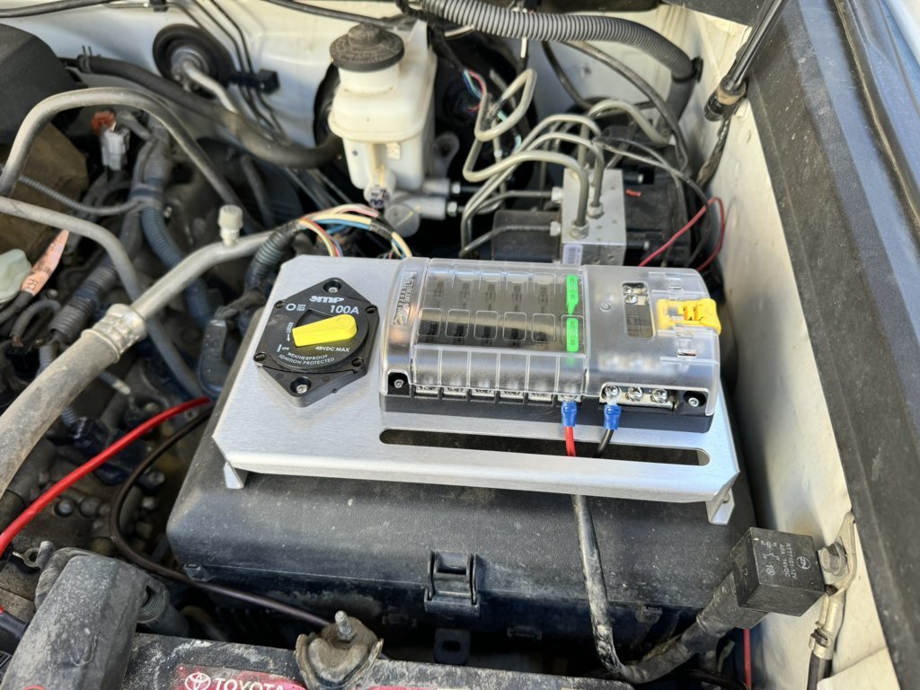

    Sunday, I had a short bit of time to throw in my Overland Equipped fuse block and circuit breaker. I could have built this whole thing myself but I liked the ease and prefabricated setup as well. Total install time was probably only 15-20 minutes with the two circuits I currently have.
    Now to add more for circuits, like bed lights.

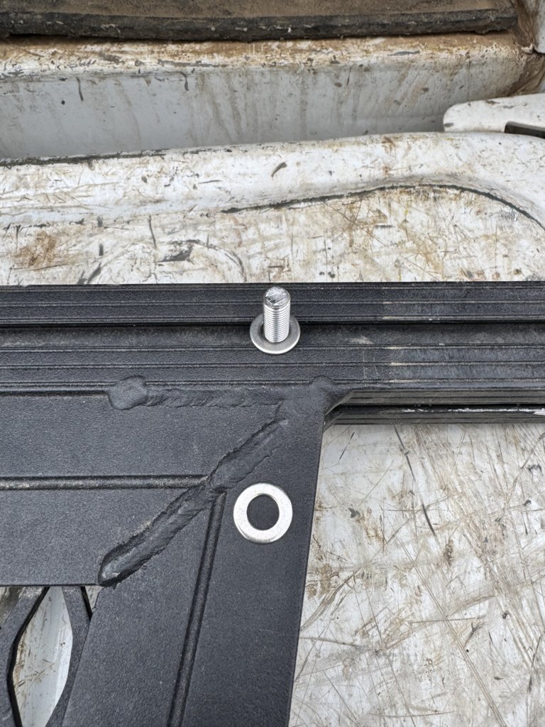

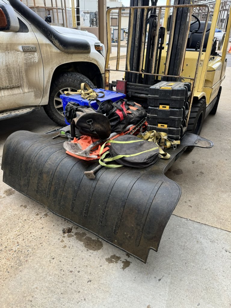

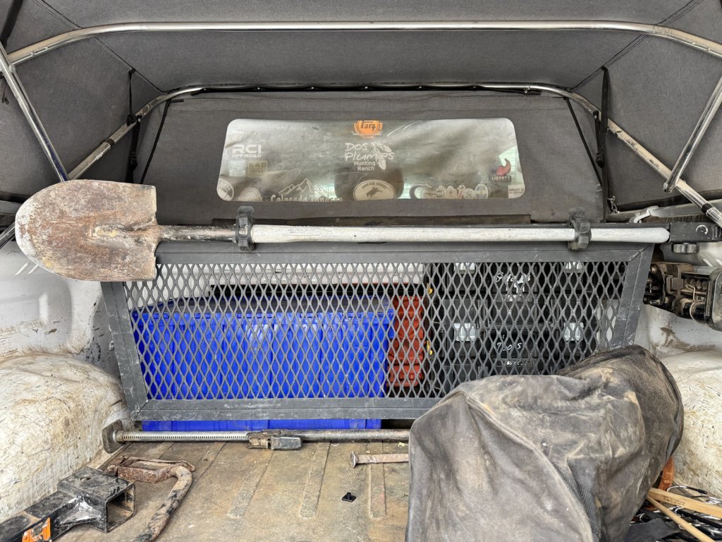

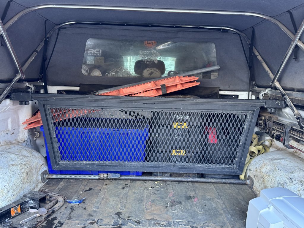

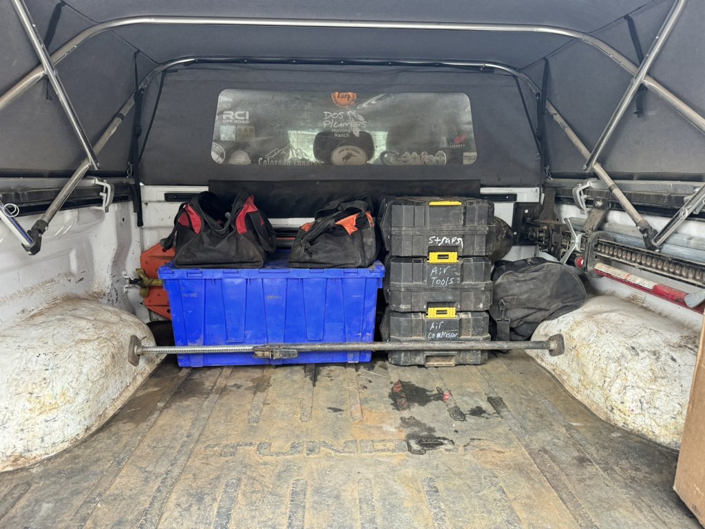

    More “slow at work” shenanigans. (Please don’t pistol whip me). I picked up an OEM bed divider fairly cheap off Facebook marketplace. I’ve been looking for one for a while and scored this one for $100. It took a little rearranging to fit the mounting in around the Softopper hold down and the RCI hi lift mount, but we’ll give it a try. I also ordered some wrap mounts off Amazon for the shovel, and I’ve got to figure out a place for the traction boards.

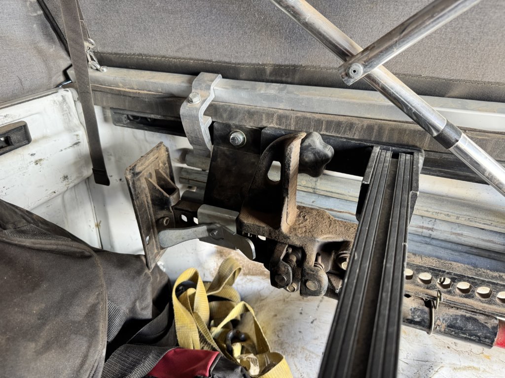

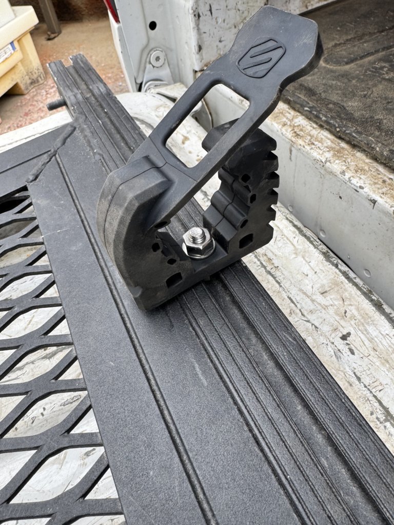

    In my never ending quest to try to organize the random equipment I carry for no reason other than my mental health/gymnastics, I got my shovel mounted on the new cargo divider I picked up off Facebook marketplace. I ordered deck rail T-nuts and Scosche universal clamps hoping to mount the shovel to the bed front deck rail but the softopper prevents that unfortunately. So, I scrounged around in our massive bolt supply at work, and found two M8x1.25 35mm stainless bolts that fit perfectly into the channel on the bed divider. A couple nuts and washers and bobs your uncle, the shovel is secure. I need to do something similar for the traction boards as they are currently pinned between my equipment bins and the front of the bed, unsecured, which I’d obviously like to change. I also have a factory 3’ J-hook for Toyota spare tires that I’m going to get a conduit strap and try to secure it to the bed divider.
    Here are the links to the T-nuts and the Scosche clamps.
    https://www.amazon.com/dp/B09Z8Q42D2
    https://www.amazon.com/dp/B0DBBV83XV

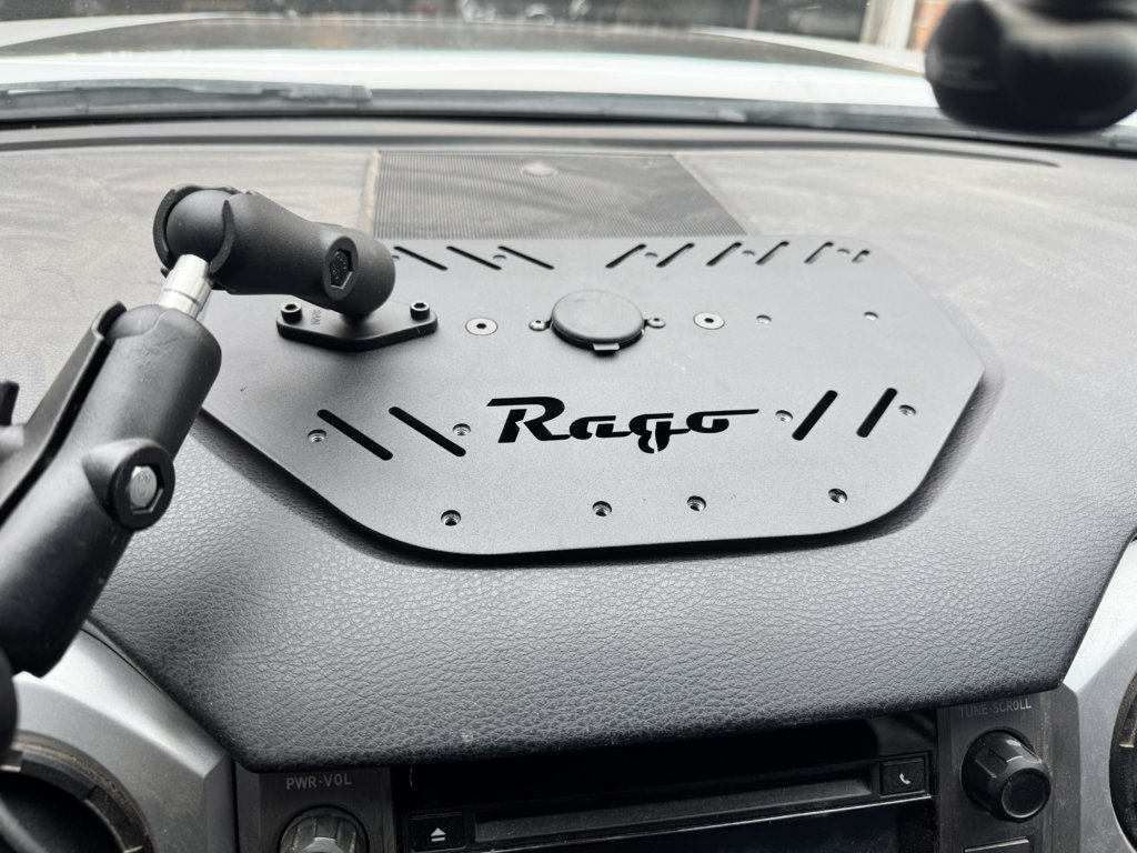

    Well, let the Christmas installs begin. The girlfriend and kid spoiled me with quite a bit of the “wants” list for the truck. This included:
    • Softopper hanging organizer
    • Trail-Grid pro FRAC with new front camera
    • Rago Fab dash mount with ICS reinforcement plate

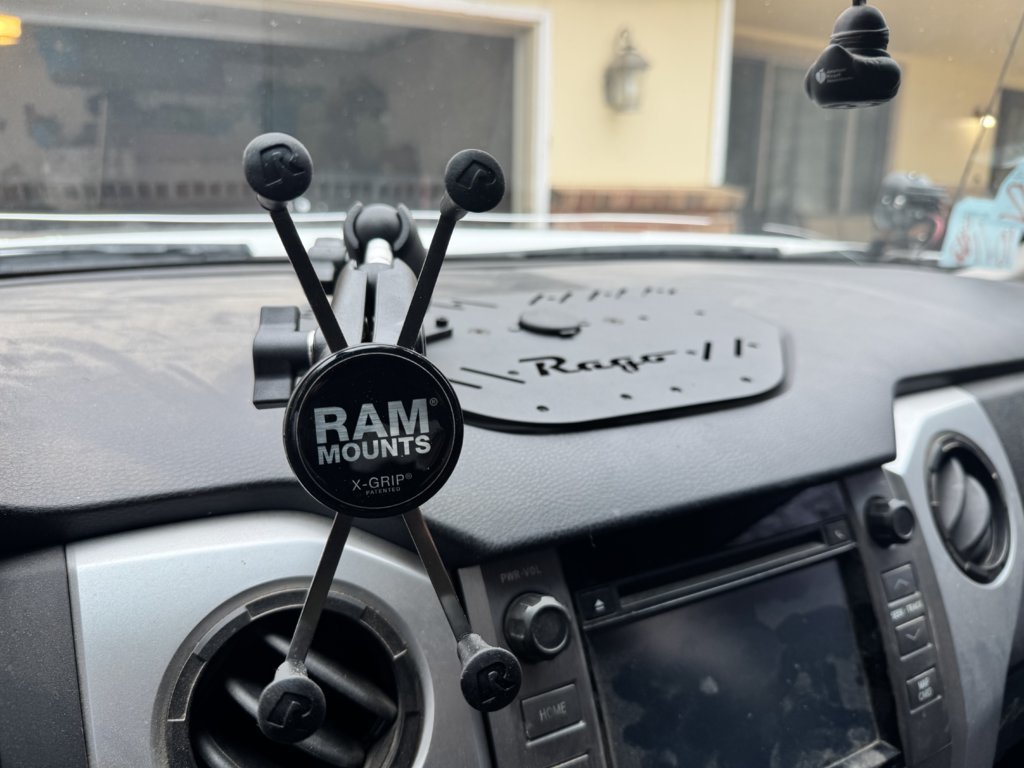

    I installed the Christmas gift Rago Fab dash mount today, just barely beating the extreme chill that is heading into Colorado. Last year, CO passed a full hands free law on cell phones. This set up had been on my to do list for a while, and the kids bought it for me for Christmas.
    Install was fairly simple and straight forward. My only complaints are they were sloppy with the powder coating, making some bolts hard to start and chewed the threads a little on one or two bolts, and the instructions are out dated and lack sizes for drill bits and such. Rago has a YouTube video linked on their website for install, that uses an older version of the plate which doesn’t have the additional USB charger that is included.
    Otherwise, I like it. I bought a few RAM mount arm extensions to fine tune the length and mounting position of my phone.

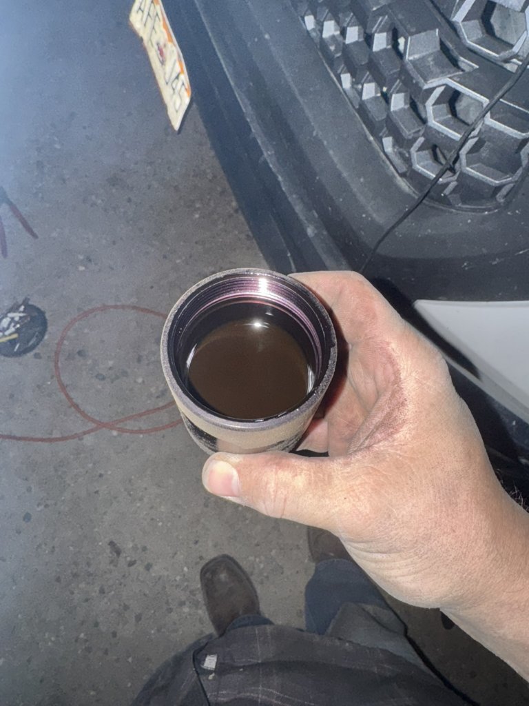

    No real pictures but I had the truck tuned with the OTT tune by Colorado Toyota Tuning on 5/24/25. So far, pretty happy with the improved throttle response and power, but my main goal is improved trans operation and shift feel, plus if I can, a little bit of better gas mileage. Time will tell. Prior to the tune, I replaced the spark plugs, cleaned the MAF and throttle body, and emptied the catch can to get the ECM as close to ready as I could.
    The only downside now to the tune looks to be that the truck will have to have midgrade or better from here on out, which is going to hurt. The first tank of 91 premium into the 46 gallon transfer flow ended up at $145. The price you pay for fun I guess.
    Here's a photo of the catch can volume after approx. 3500 miles. Maybe quarter cup of oily water schmegma.

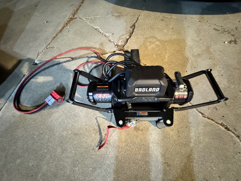

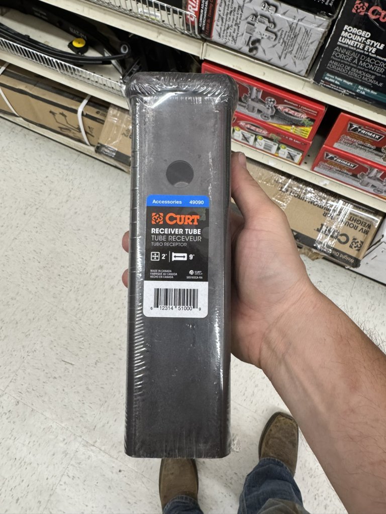

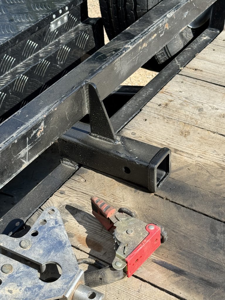

    Here's a list and links to everything I've collected so far. The welding of the mount will be done sometime next weekend by a badass friend of mine. Most of these parts have been collected off sales and moments of opportunity over the last few weeks.
    https://a.co/d/19XV38h Champion 2" receiver 8-12k lb winch cradle
    Amazon.com: CURT 49090 2-Inch x 9-Inch Weld-On Raw Steel Trailer Hitch Receiver Tube : Automotive
    Got a nice discount on this one for Memorial Day. Knocked almost $100 off with coupons.
    https://www.amazon.com/dp/B01GSKYA88 24' winch wiring kit with quick disconnects
    https://www.amazon.com/dp/B075RHZ1JD 6' winch wiring kit with quick disconnects
    https://www.amazon.com/dp/B01GU4O3GG 30' Energizer 1 AWG 800A jumper cables with quick disconnect lead.
    The jumper cables are just a spur of the moment idea, because who wants to pop the hood to jump folks :rofl:

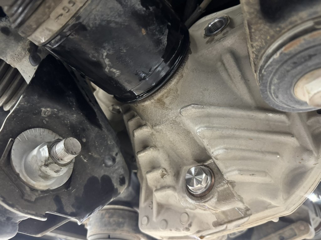

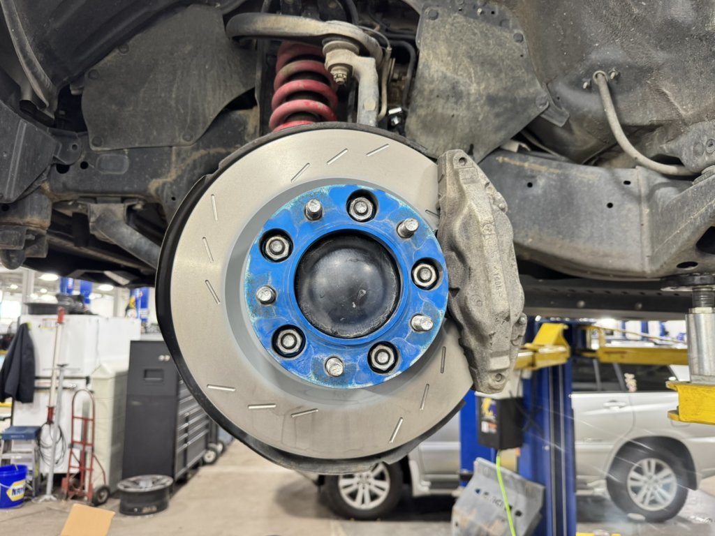

    Got a few things taken care of by my brother, A Toyota MDT and local dealer shop foreman. I've been collecting parts for a while and finally got a bunch of them installed and some maintenance taken care of.
    Frozen rotors and Hawk LTS pads from @dirtydeeds
    SDHQ stainless brake lines, the full 6 line set.
    ECGS diff bushing and Lexus plugs, plus all the driveline fluids drained and filled.
    Drain plug: https://www.amazon.com/dp/B0CZRR77RQ

    Assembly begins. I mated the winch to the cradle since I’m a bachelor tonight, to get ready for the welding this weekend.
    May I present the “I’m too damn old for come-along hand winching”.

    The winch project continues. Yesterday (6-14-25) I took the truck and trailer out to a good friend to have the receiver welded onto the trailer. He’s a great dude, went above and beyond on the work adding gusseting and spacers so it’s strong and level.
    Father’s Day was hectic but fun. Met up with my dad, brother and uncles families for a big bbq in the park. As soon as that was done we hit the road to Yellowstone. The truck did phenomenal with the new OTT torque tune, and it definitely shows. Even over the hills of Wyoming the mileage improved by 1-2. Very happy with it. Wish I’d done this sooner.

    But alas, back to reality. I got the winch out and on the back of the truck to try it out before I run the wiring for the quick disconnects. I used the high amp jumper cables I bought to temporarily power the winch, and it worked flawlessly. I applied the parking brake lightly, spooled out the winch and pulled the truck across the yard to apply tension to the cable.
    https://youtube.com/shorts/XjnCkCcFqoo?si=Qda-v0Hp-jGWfvEW

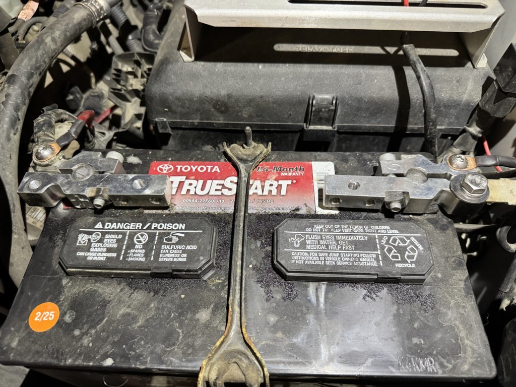

    After that while cleaning the garage I found a set of Slee Offroad battery terminals which will work great for attaching the power cables for the winch when I get them done.

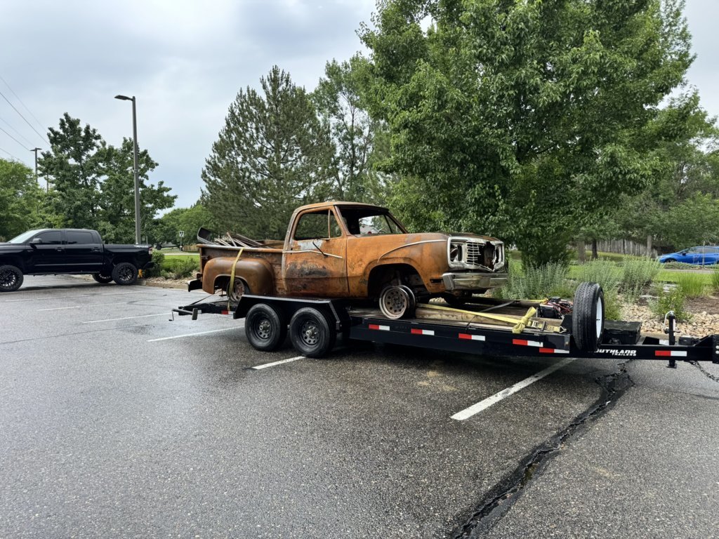

    First try on the trailer mount is today, a neighbor lost their house and multiple cars in a fire, and I’ve been asked to haul a few of them for scrap.

    The winch got it's first test run and performed very well, at least on the equipment side. I pulled a wildfire burned Dodge 1/2 ton onto the trailer for scrap. Aside from my son pulling the winch hook into the cradle and pushing the fair lead rollers out of the way, it went very wel.

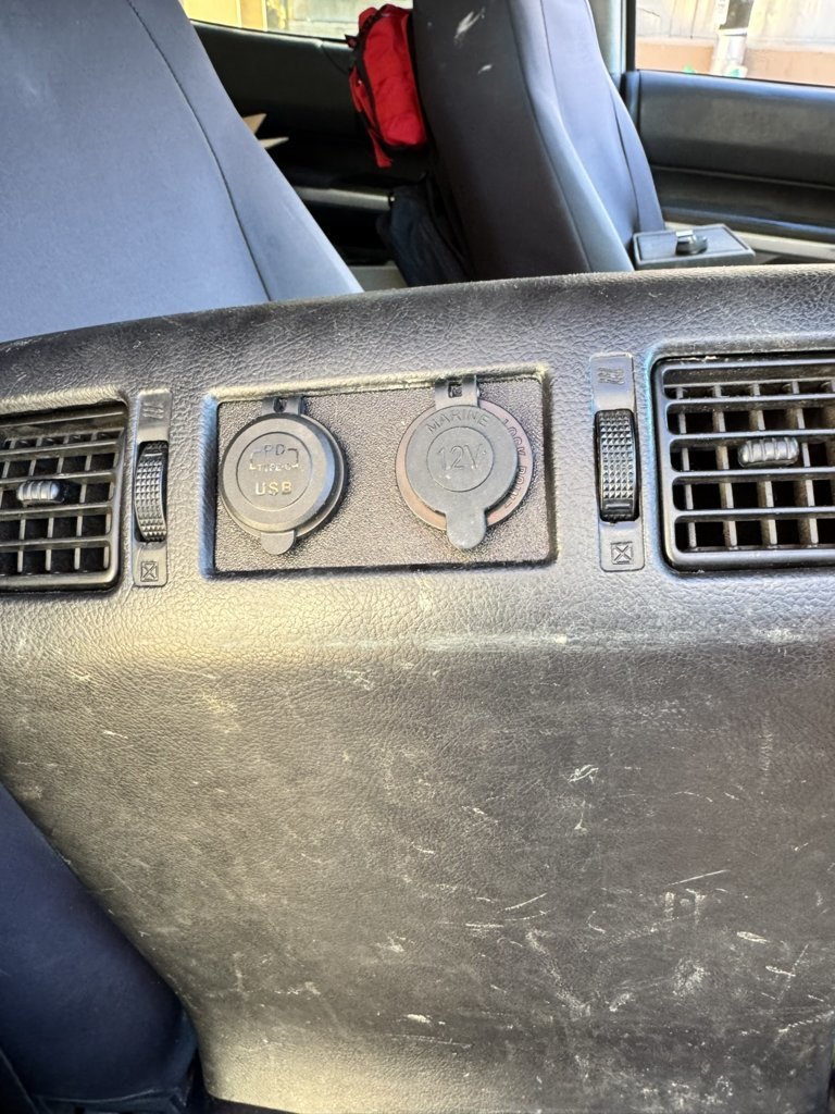

    Slow day at work so I was able to quit procrastinating on a few small interior improvements.
    Installed an Etsy dual charging port insert with two Amazon chargers. One is a standard 12v cigarette lighter type, the other has two USB ports and two USB-C ports, with an on/off switch. As per usual I procrastinated for weeks installing it, even though I was less than 5 minutes in and out.
    Amazon.com: 78W 4 Port 12V USB Outlet Car Charger, Super Fast Dual PD3.0 & QC3.0 Multiple USB Port for Car, USB C Cigarette Lighter Replacement 12 Volt Socket Waterproof for Marine Boat Motorcycle RV Golf Cart : Cell Phones & Accessories
    Toyota Tundra Center Console Dual 12V Replacement Panel 2014-2021 Tundra Crewmax - Etsy

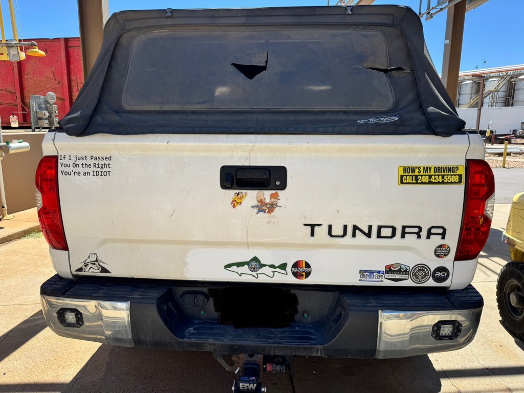

    And finally out of boredom I did some sticker bombing on the tail gate. Everything along the bottom except the storm trooper and the 200k sticker is new.
    Yes, I know the truck is disgusting, but I've also been working 50-60 hours a week since late June.

    lol I love the “Passed you on the right sticker”. So accurate for driving on the front range

    Not a huge change but I redid some of my bed organization. I've been collecting Milwaukee pack out boxes for a few months now, and I finally got things switched over to them. Initially, I had one large deep pack out for my MV-90 air compressor and all of its air hoses and tools, one which I combined my two soft tool bags into, and another for my good straps. I realized I didn't have the organization I wanted for the tools, so I broke down and got this multi drawer toolbox. They turned out heavier than I initially thought, but oh well. It's a work in progress towards better organization. I still need to decide how I'm going to secure them though; I'd like a pack out mount, but I don't think I want any of the mounts that would put them on their sides hanging from the bed rails. I also don't want to drill through the bed to use Milwaukee's mount either so it will take some research.
    Anywho, on to the pictures. I included the previous Dewalt dumpster find cases I've been using.
